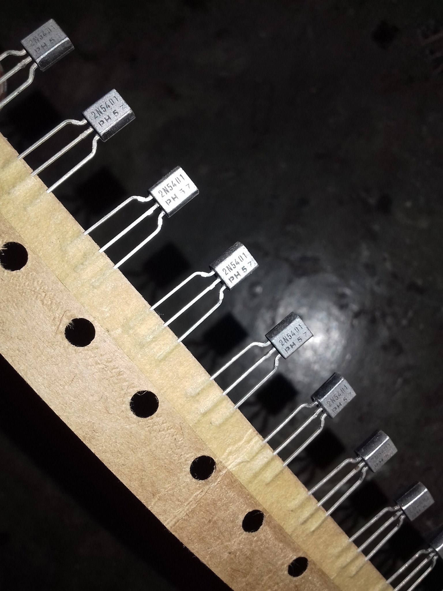

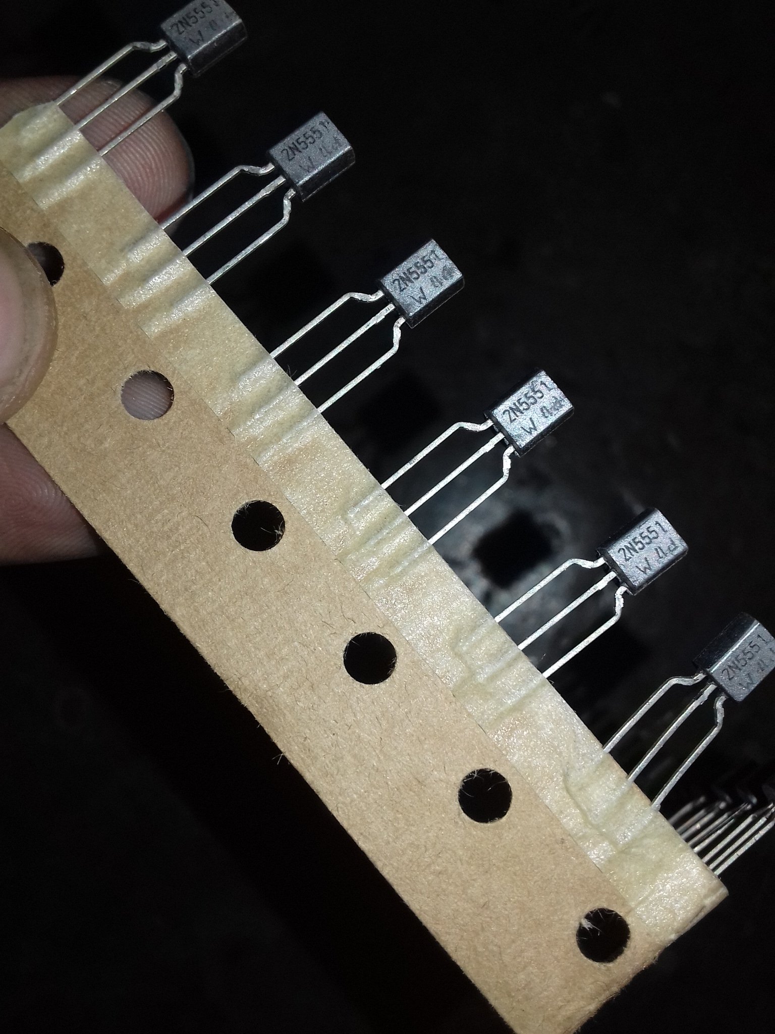

They donot look like genuine Sanyo transistor's to me. Please check it with your supplier regarding authenticity.Received today, Sanyo bjt's for VAS.
100% Genuine. Diffused in Japan assembled in China.They donot look like genuine Sanyo transistor's to me. Please check it with your supplier regarding authenticity.

Not from aliexpress. But i think you have a story, you can share if you want to. Best Regards.Yes Yes. all aliexpress is filled with such phillips!))
I also think so 🙂Mr, nirupambhowmick,
2N5401/ 5551 are genuine Philips. You are lucky to get them.

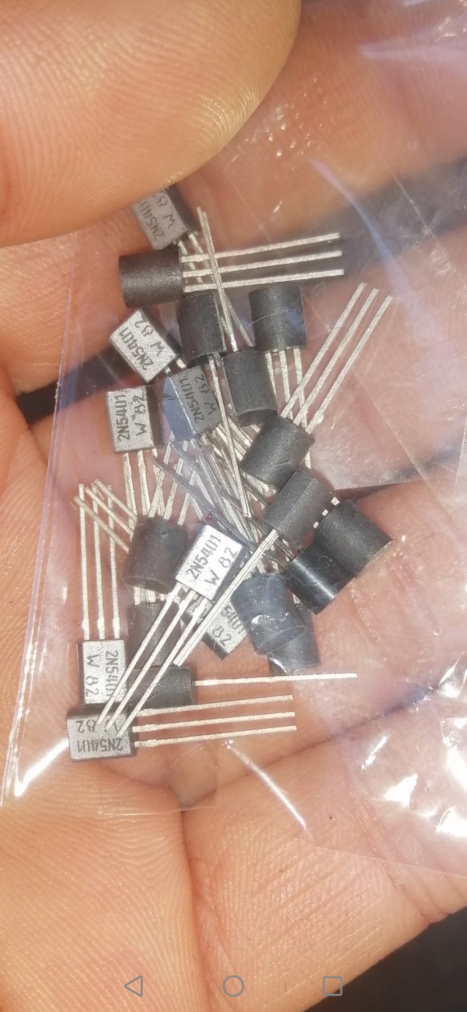

Aliexpress philips 2n5401 2n5551 Which seller did you buy from?I would like to end this thread here & i'll be back with a new thread soon. Thanks to everyone for sharing your knowledge & for great advise.

i didn't purchase from alixpress. Alixpress is banned in india.
I bought these in my country 2n5401 2n5551 I couldn't find iti didn't purchase from alixpress. Alixpress is banned in india.
