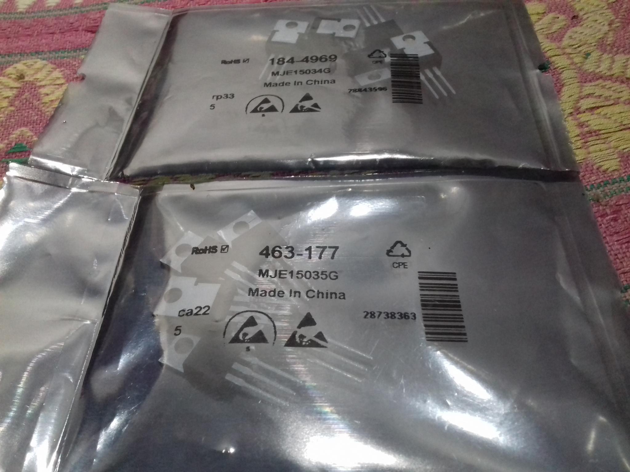

Certainly not, time to calm down. Anyone who built the Honeybadger (and there are many...) says what a fine sounding amplifier it is. It's BOM recommends MJE15030/31/32/33's as drivers. Why should MJE15034/35's be worse that these? I'd go for them.Then i think i did a big mistake buying mje34/35 🙁 2sa1837 & it's complementary very much available here with very very affordable price.
But Chinese parts? I don't know...🙄
Best regards!
I think the “big mistake” he was referring to was paying more for MJEs before exploring availability of the other types. Neither is a mistake design wise.
ON does make a lot of their parts in China now. Remember when all the US tariffs went into effect? Half of the ON Semi parts had the “tariff applied” tag on the Digikey US website. I was surprised myself at just how many were made in China. May want to check them for conformance - depending on what middleman is involved. If they ARE fakes, Cob and Cbe will be way low, and beta will fall like a stone above half an amp or so. Easy enough to check.

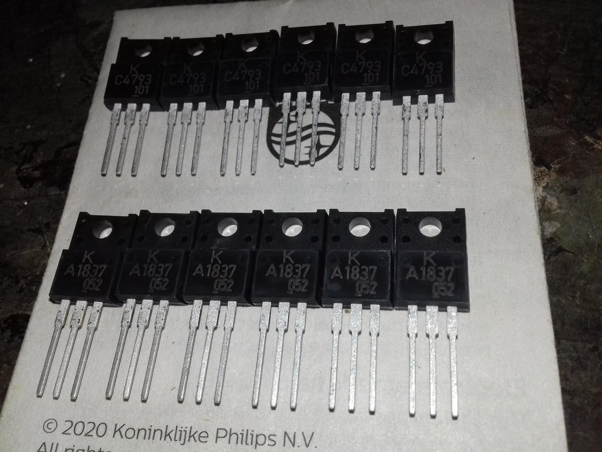

I believe you. My concern was about so called 'sound quality'... & why would i spend more when i can get drivers like a1837/c4793 at a very affordable price! While ordering mje15034/35 i didn't know that i can use those drivers instead 😛 Anyway i'm going to have 6pair of KEC c4793/a1837 soon 😉 😀Certainly not, time to calm down. Anyone who built the Honeybadger (and there are many...) says what a fine sounding amplifier it is. It's BOM recommends MJE15030/31/32/33's as drivers. Why should MJE15034/35's be worse that these? I'd go for them.
RS never failed me, excellent quality control 🙄But Chinese parts? I don't know...🙄
Best regards!
Exactly but i have no regret Sir ! 🙂I think the “big mistake” he was referring to was paying more for MJEs before exploring availability of the other types. Neither is a mistake design wise.
I think we can trust age old RS Components & On semi without any doubt.ON does make a lot of their parts in China now. Remember when all the US tariffs went into effect? Half of the ON Semi parts had the “tariff applied” tag on the Digikey US website. I was surprised myself at just how many were made in China. May want to check them for conformance - depending on what middleman is involved. If they ARE fakes, Cob and Cbe will be way low, and beta will fall like a stone above half an amp or so. Easy enough to check.
...but I didn't know where you sourced these devices in those Made in China bags from 🙂.

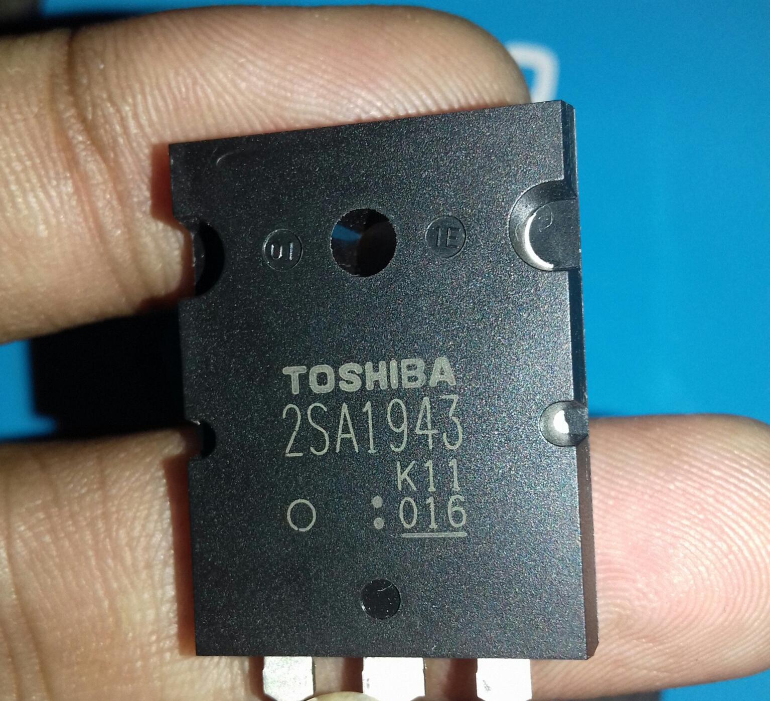

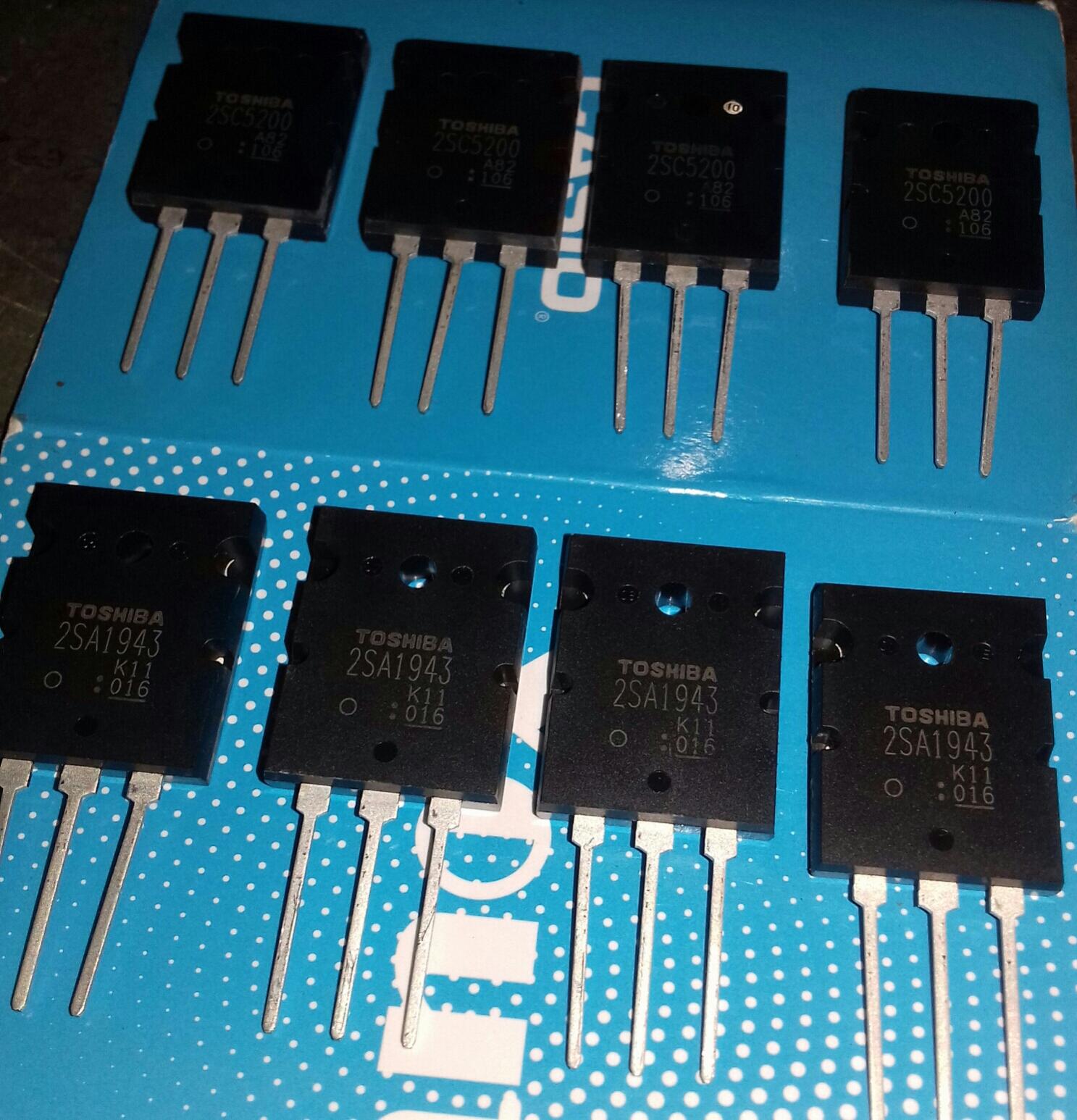

Ok, so what’s PHILIPS here? Don’t tell me KEC is Philips now too - I didn’t think they operated out of the Far East.
2SC5200 & A1943
More power transistors but this time from Toshiba 😉
Mr. Wg_ski@ Now don't tell me that these transistor are from Casio 🙄 😀
Anyway still waiting for VAS transistors
Gotta keep that PHILIPS symbol off your work bench, lest it’s ‘quality’ starts to rub off on your work. Unless you like amplifiers that burst into flames and take your speaker with it.
