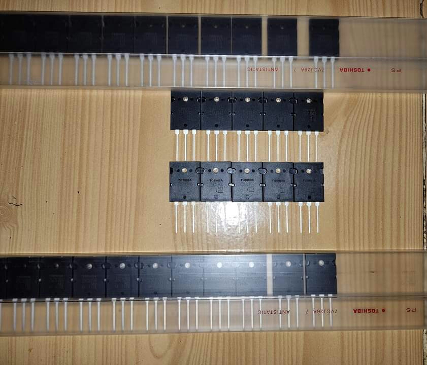

Transistors 2SA1943O from Japanese auction.
Diffused & assembled in japan 😉
...good for a 2 x 150 W stereo amplifier featuring four pairs/ch...There are eight pairs 2SA1943O + 2SC5200O with a gain 106-133.
