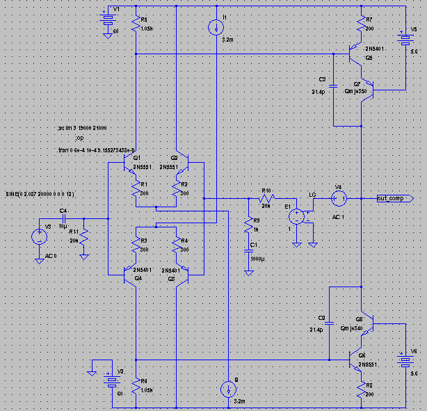

Effects of cascoding of the VAS
Well, I promised myself I wouldn't mess with this simulation any more. However, the designs I've been playing with lately have all used cascoding of the VAS in some form. So I just wanted to evaluate the effects of VAS cascoding on the simulated distortion. After seeing the results, I suddenly remembered something a math teacher I had in college used to say:
"You're not going to like this".
I cascoded both VAS transistors in the complementary amp of course. I used small-signal transistors for the CE amps because of the low voltage across them, and used the MJE340/350 for the common base portion. Also, I measured the loop gain at 20 kHz in the new configuration. For the complementary design, it was 1 dB higher than without cascoding. I believe this was because the collector-base capacitance of the VAS transistor no longer appears in parallel with the compensation cap, making the gain-bandwidth product a little higher. So I increased the compensation cap to make the 20 kHz loop gain the same as before. Now the common base amp is biased with its base at 5.6 Volts away from the rail instead of 1.6 Volts. So I increased each supply voltage by 4 Volts to keep the clipping level the same.
I did a similar thing with the single-ended configuration. In addition to cascoding the VAS gain stage, I cascoded the constant current load as well, using the low-power transistors of the CE configuration in the same way as with the complementary stage.
The complementary design is shown below.

The distortion of the complementary amp with cascoding is much lower now. All harmonics above the third are below the residual of the FFT for the complementary design. I'll have to play around with the FFT parameters to improve this. But that's for later. The results were:
Complementary:
2nd harmonic = 83.2 dBc
3rd harmonic = 77.5 dBc
The third harmonic has improved by about 15.5 dB over the complementary design without cascoding. That's a significant improvement.
Then I ran the single-ended version. I had to increase the compensation cap slightly to get the same gain-bandwidth product, similar to what I did with the complementary design. The results were:
Single-ended
2nd harmonic = below residual of 90 dBc
3rd harmonic ~= 93 dB (residual is about 95 dB)
So not only is the third harmonic about 15 dB better for the single-ended design than the complementary design, but the surprising result is that the second harmonic is better too.
I'm at a loss to explain this. I'm running out of time, so I'll just post the schematic of the single-ended design and comment more later.

I'm trying to keep the gain-bandwidth product exactly the same as before cascoding, only for the purpose of evaluating the change in distortion due to the improvement in the linearity of the open-loop amplifier. I don't want any change in loop gain clouding the issue of where the improvement came from (more feedback or improved linearity).
If I were designing this as an amp for my own use, I'd make the gain-bandwidth product much smaller in order to maintain stability into difficult loads. But that's another story entirely.
