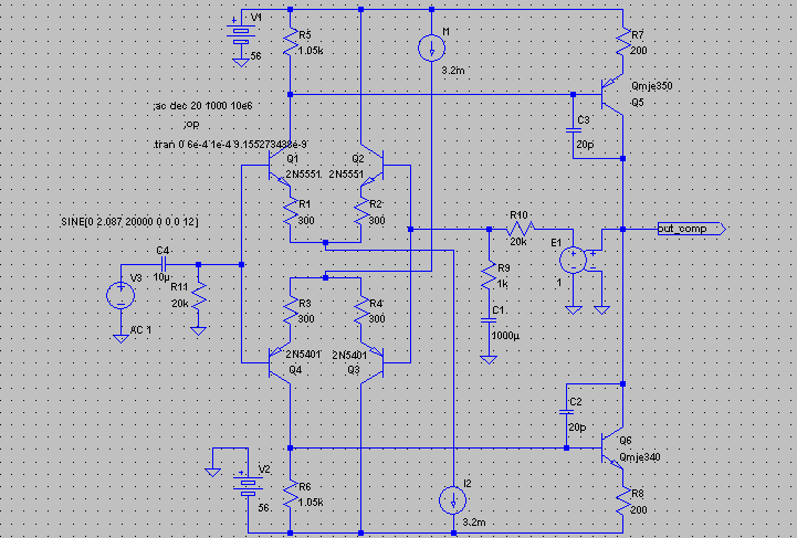

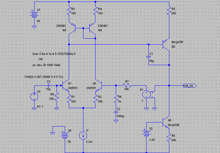

Amplifier topology objective effects
I was curious, so I thought I'd get some numbers on the 2nd/3rd harmonic issue of complementary vs. single-ended topologies. First, I simulated a Douglas Self-style single ended amplifier as shown in the first attachment below. Power supplies were +/- 56V and output voltage set to simulate an output power of 120 Watts into 8 Ohms at 20 kHz assuming an output stage were hooked up. I use a VCVS so the feedback network doesn't load down the VAS. Then I simulated a fully complementary design using the same transistors. Notice that the bias voltages and currents are the same for the complementary and single-ended designs. I tried to make component values equal so I'm doing an "apples to apples" comparison. I adjusted the compensation caps on the complementary design so the small-signal bandwidth was the same as the single-ended design. Nominal slew rates should be the same for the two.
Then, using a transient analysis and 65536-point FFT, I computed the harmonic content of the output. The details of this simulation technique can be found in the following post:
http://www.diyaudio.com/forums/showthread.php?postid=196461#post196461
And yes, I'm aware of the potential pitfalls of using SPICE to simulate harmonic distortion. I'll show the complementary design and the results in the next post.
The data for the single-ended amp was as follows:
Single-ended
2nd harmonic: 61.3 dBc
3rd harmonic: 70.3 dBc
4th harmonic: 80.2 dBc
5th harmonic: 92.9 dBc
Complementary:
2nd harmoinc: 69.6 dBc
3rd harmonic: 61.8 dBc
4th harmonic: 96.9 dBc
5th harmonic: 83.4 dBc
Total distortion is similar, but the assertions regarding improved 3rd harmonic distortion performance of the single-ended design seem to be correct.
The complementary design is shown below. I can provide the LTSpice projects if anybody is interested.
Single-ended
Complementary:
