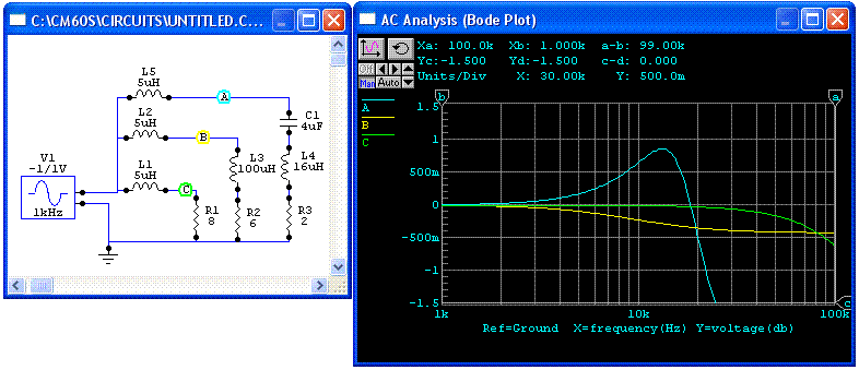

I don't think high slew rate for it's own sake is important. However an output inductor will have a definite load-dependent effect on the frequency response.An output coil certainly ruins the slewrate when the amp itself is capable of 300 volts/us.
Attached is the result of a sim that attempts to show the effect of a 5uH output inductor on response (measured at the loudspeaker terminals) for:
a) An ESL
b) An MC tweeter
c) An 8 ohm resistive load
While 5uH might seem high by today's standards, it wasn't always so. For example I'm pretty sure the Quad 303 had at least that much, which could help explain the "magical synergy" between Quad components that magazine reviewers and such-like folk used to harp on about back in the day.
Given that the old Quad ESL was somewhat lacking in output in the upper treble, a decibel or so of boost would certainly have been welcome.
Hmm... an amplifier that measures ruler-flat into 8 ohms but sounds a little dull on normal speakers, while managing to add sparkle to an otherwise slightly dull-sounding ESL. No magic there - It's all in the inductor.
Cheers - Godfrey
a) An ESL
b) An MC tweeter
Cheers - Godfrey

These are really good points. In many amps it is also not just the inductor that causes load-dependent frequency response anomolies. I have always wished that reviewers, when reviewing an amp, would make a frequency response measurement of the amplifier AS SEEN AT THE SPEAKER TERMINALS of the system being reviewed. It might reveal a lot.
Too many people assert that there is no correlation between measurement and sound, when those very same people have done little more than measure the amplifier into an 8-ohm load (sometimes only at 1 kHz!).
Bob
