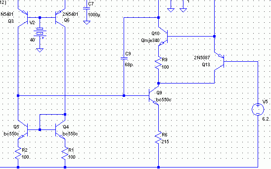

A Baxandall Super Pair is even better, but it makes the simulator oscillate. However I don't think these will happen in real life, as the period of oscillations is exactly 4 simulation samples no matter what sample time I use... Therefore I postulate it's an artifact.
When I simulate the super pair within an amplifier, I get an oscillation at a frequency of about 95 MHz that I still haven't been able to kill. One possibility is that your time step is still large enough that you haven't hit the minimum Nyquist sampling frequency to capture the oscillation. If that were the case, what you're seeing may be the effect of aliasing due to undersampling of the oscillation. It just seems like too much of a coincidence that both of us are seeing what looks like oscillation of the super pair. The LTSpice simulator does not use the Berkeley SPICE code base, so we're looking at possible oscillations with two very different simulators. Very suspicious.
(...)Thus I still doubt your circuit could be better than a Super Pair(...)
It looks like the super pair is the best in theory, with the highest output impedance. What bothers me is the oscillation I'm seeing. The Hawksford cascode seems excellent as well, I just don't like its clipping behavior. Of course, never underestimate the "not invented here" human nature aspect 🙂 .

I tried the technique below to stabilize the super pair and was able to kill the 95 MHz oscillation. 50 Ohms works fine for R9 too, but 25 is just on the hairy edge of oscillation (oscillates on the first cycle of the transient but dies down after that). It also has the good effect of preventing the DC value of the Vcb of Q13 (below) from being zero. Thie gives me the lowest simulated distortion of all the configurations I've tried yet, and doesn't require the device matching of the "funky" circuit 🙂. Clipping is completely clean as well. So I'm switching over to this design.

Andy,
That looks like a good circuit. Much simpler.
Based on Peufeu's simulator results I'm inclined to think that these circuits are dealing with beta/Vce sensitivity rather than Ccb sensitivity. This is an important finding wrt designing the right compensation. It looks like the one you've got deals with both. I suppose a similar arrangement is needed for the CCS. I also suppose the beta/Vce sensitivity should be a primary criteria when choosing a device for the VAS rather than Ccb.
