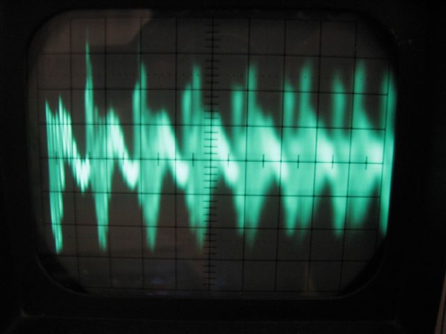

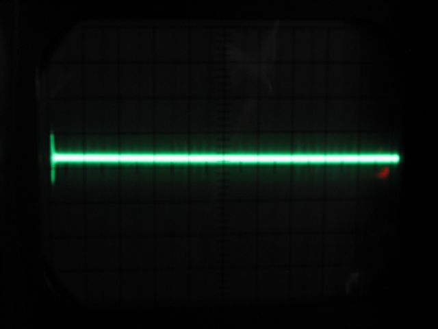

Mean Well S145-24 with some 10mF and a 0.39 Ohm resistor in series with floating COM, picture taken at 20mV/div and 5us/div compared to COM tied to GND, at 5mV/div and 5us/div.
And I can hear this with a B1 buffer in front of the amp.
I wonder what the scope pattern would look like with the power supply actually powering the amp at high listening volume and with the supply outputs left floating as in the poor example? Would the amp pull the negative supply leg to audio ground and stabilize it with out the need for the jumper? It would also be interesting to see if the music power demand can modulate the supply at all. The MeanWell supplies sound very stiff to me.
The effect is swamped by the switching noise of the amp feeding back (through almost 20mF, mind you) to the PSU. The first attached pictures shows the scope reading taken at the PSU output terminals with the amp powered but idle at 20mV/div and .5us/div. The second with a 85Hz signal at quite loud, 20mV/div 5ms/div. Both taken with the cap btn COM and Earth in place. If the cap is removed the result look slightly different, but the signal basically spans the same voltage.
So that's close to 40mv ripple? coming back from the 650kHz and almost as much from the 85Hz which would be the .012 seconds per cycle wave in the second shot. Doesn't look all that impressive but the MeanWell power supplies certainly sound great. You added an additional 20,000uF capacitance? I would have thought that would knock the 85Hz ripple down more than that.
I replaced the tank caps on board with 4 x 1800uF Pana FM and I have 3 x 3300uF Yageo low-ESR caps and a 0.39Ohm resistor btn board and PSU.
Wow! That is crazy that all that ripple, even a simple 85Hz tone, can walk right through all of that filtering especially with the resistor.
I would be curious to see the phase versus the speaker output on a B channel. Is it possible that the inductors in the power supply are pumping like a current source and actually boosting the voltage as demand from the signal modulates the positive rail? The patterns don't seem to jive with the sound improvement I get when changing my linear supply to the MeanWells. They are in a whole other league. Much faster and more dynamic sound.

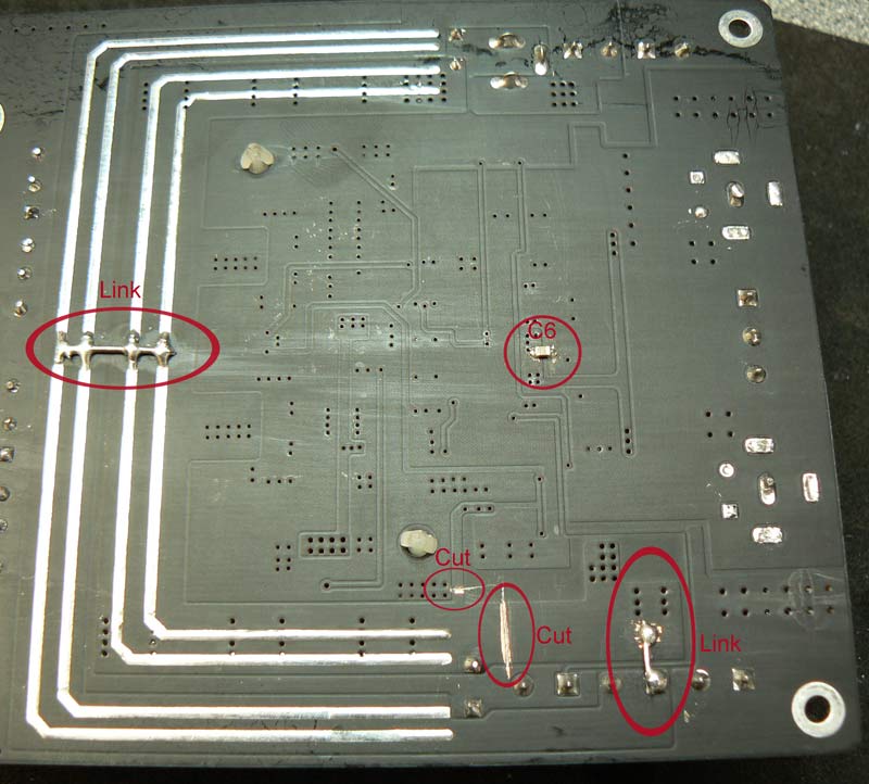

I have some spare time while I wait for the new sure board to replace the one I scorched. So I completed the list of mods and things around the board I did. Maybe you find that interesting.
PSU Mean Well 24/145:
- cranked up to almost 30V
- 0.47uF MKS btn GND and COM
Sure board:
- changed PCB traces per audio1st suggestions (http://www.diyaudio.com/forums/showpost.php?p=1855510&postcount=145)
- removed D1,2
- added 0.1uF parallel to C6 from the underside of the board
- exchanged C22&27 for 470pF as per the TC2000 data sheet
- re-wired pins 24 on both TP2050s to 21,22 (Vdd) instead of gnd

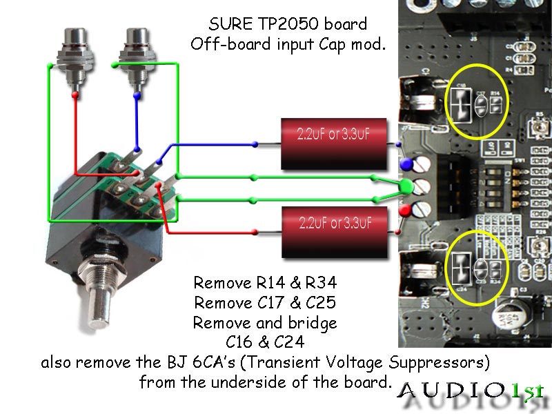

[h=Off board input capacitors and volume pot]%3[/h]
TODO pull audio1st pic from #242

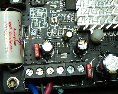

[h=On-board Input Capacitors]%3[/h]
- Remove phono connectors
- Remove capacitors C16, C17, C24 & C25
- Take 2.2uF capacitor of choice and solder between +ive of Phono connector (center pad) and -ive of C16/C24 (circular pads) respectively.
- Burn in capacitors and enjoy sound.

C19, 21, 22, 27. How critical are these to the sound? Should we upgrade?
IMHO all upgrades you want to do are worth doing, just for what you learn. As to improving the sound, I doubt if it will make an audible difference. They are part of the feedback loop and not directly in the path of that. And smt caps tend to be very fast. I doubt if you could improve them much, perhaps going to Oscons. You might want to upgrade resistors R15, R22, R28, and R33. They also bleed off the feedback loop.
But the real gains in the feedback come from replacing resistors R13, R17, R25, and R31. They are directly in the feedback signal path and should be matched to your power supply voltage (see my previous posts).
Anyone else want to weigh in on replacing surface mount caps. Can you improve them?

The Sure amp provides an element of flexibility by having power blocks on both sides of the board. This not only gives you a choice about which side you plug your power in depending on your enclosure, but also allows you to daisy chain a number of amps together in series (though I don't know of anyone who's tried this or what impact it has on the sound).
If though you have placed your amp and don't intend of using the extra power block it's actually making your power lines longer than they need be. Audio1st posted a mod where he has re-routed these power lines in order to minimise this distance and replaced a lot of the capacitors in the power line to lower the ESR.
This is a one way mod as it involves cutting the traces, do this and you won't be going back ...
- Removed C1 and C2 and replaced with a single 100nF Wima film cap
- Moved C6 to underside of board. Replaced C4 with a 100nF Wima film cap.
- *Added a 10uF Pany to the adjust leg of the 5V reg, detail of the 10uF/50v cap in parallel with R2. Position to adj pin1, neg to C3 ground below:
- Removed D1 and D2 and re-routed the power supply.
The suggested re-routing
The original path of current on the board:
The re-routed path of current on the board:
*Audio1st later replaced C4 to a 100uF Panasonic FM, this has now been changed to a 10uF Tantalum. The reason behind this was an article he read:
