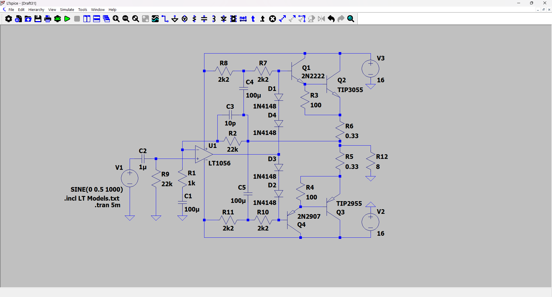

what about this circuit? ill probably use mje3055/2955 or some better transistors?
the input filter bit kinda sucks

So the 1k resistor I used combined with cap to ground is simple low pass filter.
1k and 100p = 1.6 MHz
Basically kills all cell and FM
If you have AM interference it has to go lower to 540 kHz
There is only so many common values so 330p capacitor
1k and 330p = 482 kHz
That pretty much kills everything
Funny enough usually 47p to 100p removes most problems.
Some Churches here broadcast AM right in their parking lots.
So if your really close to a broadcast antenna
Usually have to use 330p
In your schematic R2 and C3 also form lowpass filter for stability.
Depends were your phase margin is.
Since your gain is high with 22k resistor you likely only need 1.2p to 3.3p
to get the amp stable. Too high of capacitor value will reduce the slew rate or could make the phase margin
go positive. Causing stability issues. Depends. Just adjust to min value needed to make the amp stable.
That can vary greatly depending on transistor types and opamp bandwidth.
One of the many points to use a model
1.2p being the lowest value with 22k puts you at 6 MHz
So if that causes issues with phase margin. Often you see amps with lower values
Like 10k to 18k so with 1.2p you can get higher frequency filters.
Such as 10k with 1.2p will get you up to 13.2 MHz if needed.
Most audio opamps shouldnt be over 15 MHz
then again when people use 100 MHz opamps and wrong values they blame the " opamp"
for stability

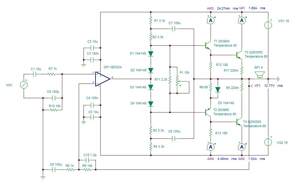

the 1k resistor is a part of the feedback loop also am isnt a thing in europe, there are a few stations i can pickup at night and one i can pick up at 225khz
You have nothing to set the bias, You will be way up at 170 to 200ma without something.
Use at least a set resistor or something friendly is adjustable.
Look at post #51 R11 sets bias. I added the 10k parallel to be adjustable.
By doing so if the pot is damaged over time. bias wont fly up to the moon
since the set resistor is still there.
If your trying to PCB this the opamp does need power rail decoupling.
Also shown in post #51 this is udder basic opamp technique.
The small 100n have to be absolutely as close to the power pins as possible.
The larger 10u also close. Due to size will be slightly farther.
Also the power transistors should be decoupled on the board.
Usually 470u is good enough also 100n parallel . Also to be a close to the power transistor
pins as possible.
Real world things oscillate with out power rail decoupling.
Otherwise standard for all opamps and power amps.
The diodes thermal track, they need to be close to power transistor heatsink.
for stability
