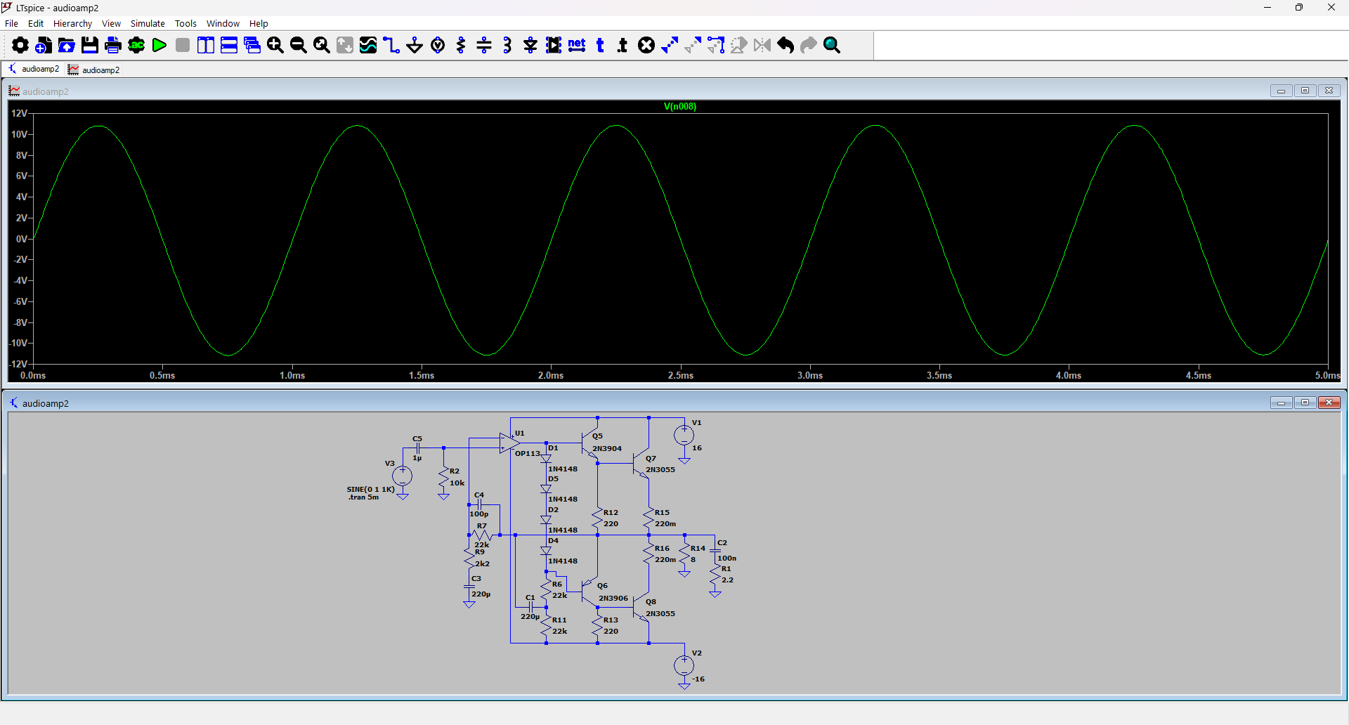

Thanks for the LTspice pic:
So if my (old, analogue) CRO screen shows a fuzzy sine wave like the one above ... the circuit must be oscillating, right?
But what about if the CRO screen shows a sine wave which is fuzzy only at the highest and lowest points of the sine wave?

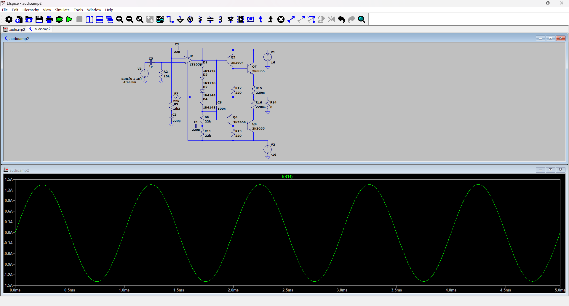

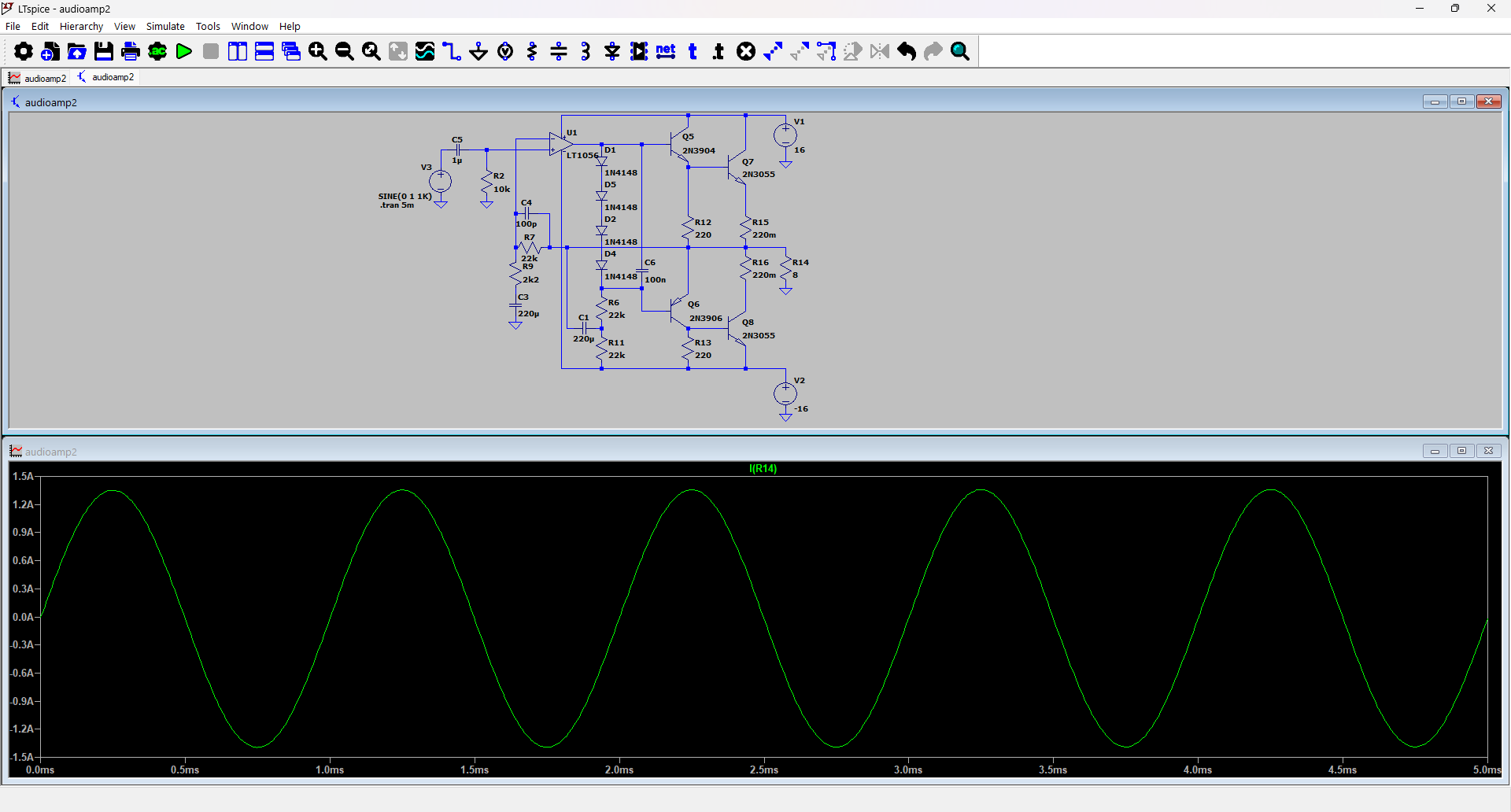

here is an simulation i made, im still not sure about the transistor choiceWhy not try a simple 'Diamond' output stage?
https://tubecad.com/2022/06/blog0558.htm
done used an random model of an relatively slow op amp and everything works fine. now im intrested in what op amp to use, the lt1056 is to fast the tl072 will be also too fast, maybe an ne5532 or an rc4558?

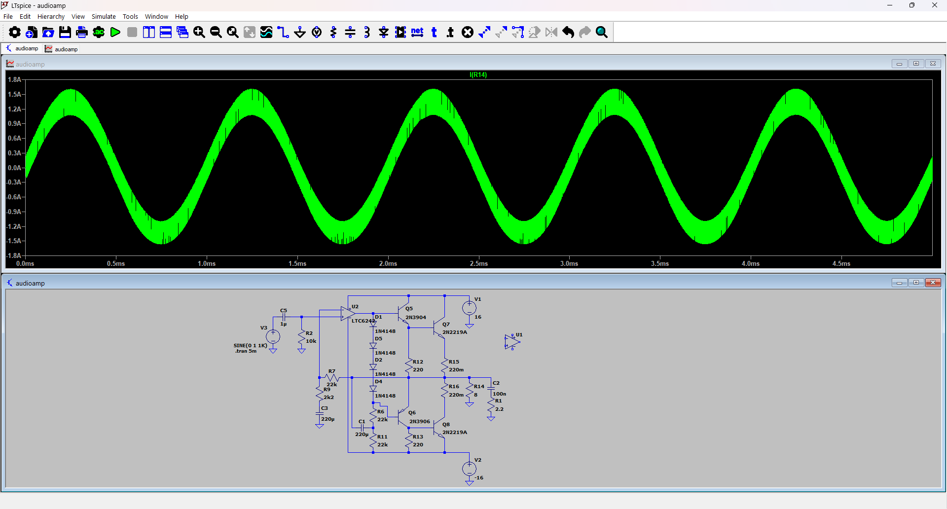

does anyone know why this amplifier oscilates and what is the solution to fixing it?View attachment 1375781View attachment 1375780
How about 10p?
Sim with square wave.
How about 10p?
Put a comp capacitor from inverting input to opamp output
