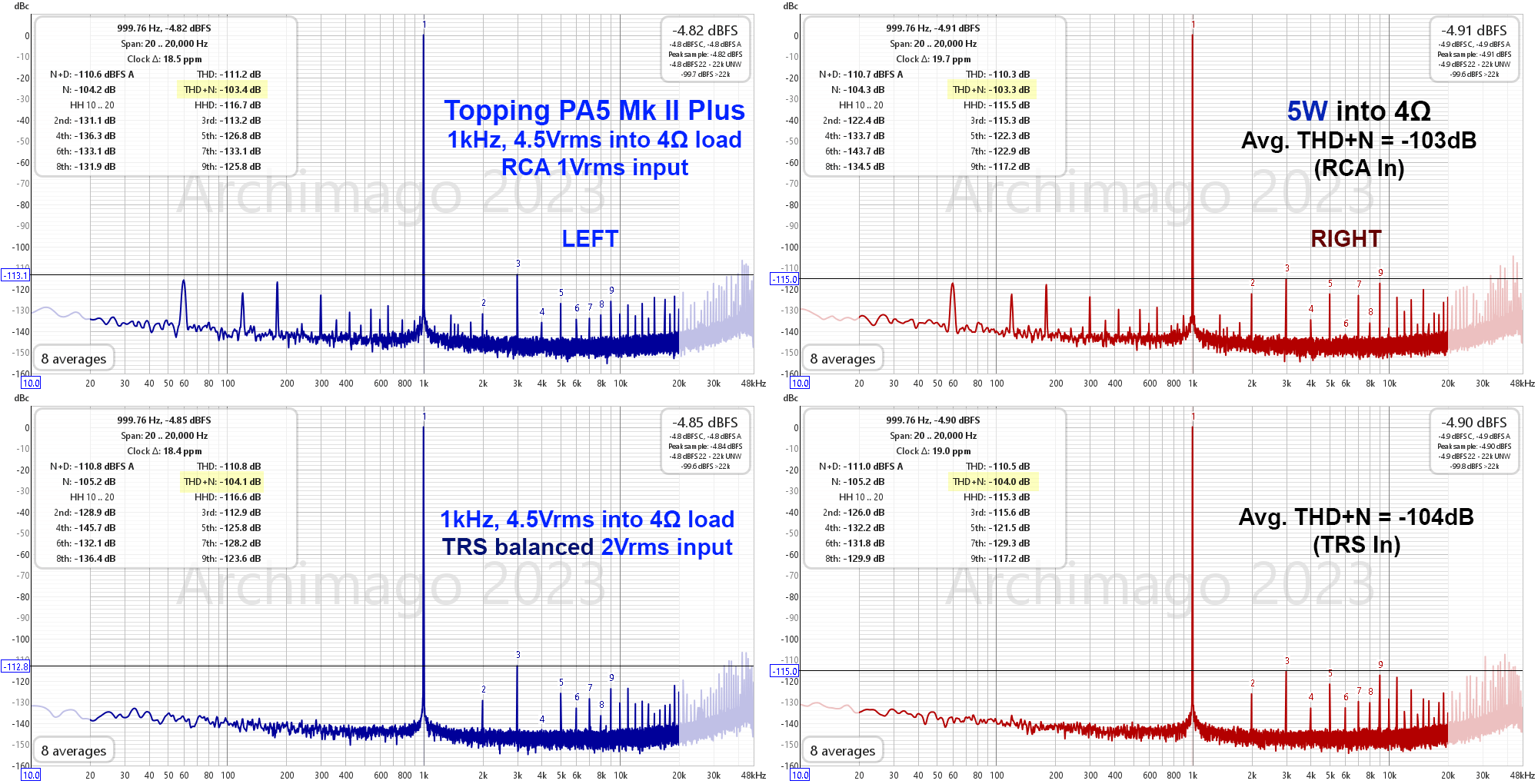

Topping PA5-II Archimago measurements.
https://archimago.blogspot.com/2023/10/part-ii-topping-pa5-mk-ii-plus-pa5ii.html?lr=1&m=1
Not much of a difference with Sylph-D100, plus the D100 has a dominant 2nd harmonic.

Yeah, but honestly, if we're just looking at 1 kHz performance any old TPA3251/TPA3255 will work, including TPA3255EVM and probably even the good old LM3886.Topping PA5-II Archimago measurements.
It's the 5 kHz, 10 kHz, IMD, and multi-tone performance in the highest octave that are important.
EDIT: Also, it looks like 3rd harmonic dominant (followed closely by 9th), not 2nd, although none would be audible at that level.

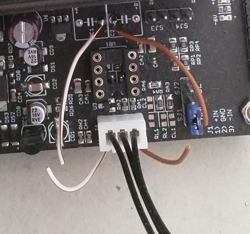

Hello,
usually i use Sylph-400 with opamp by-passed by 2 in/out jumpers drived by preamp.
Today i soldered 2 wires beetween input connector and decoupling caps.
Can be it sounds worse?
I turned in starting situation and sound is better? May anyone tell me wy it sounds worse?
If i well understud, with the wire i bypassed 3 resistors in series to signal?

Do you have a picture of the connection? What kind of worse sound? lower bass/highs or garbled sound?Hello,

Decoupling caps are in the back side. Sound seems to be affected by input saturation. The sound is not distorcted but it is noticeably worse than with wiring broken and jumpers between input/output pin of opamp.

If I understand your bypass correctly, there is series resistance between the preamp and the input coupling caps if you bypass and place jumpers on the opamp socket. If you directly wire your preamp to the input coupling cap, the sound will be inferior. Why is the input saturating and what is the preamp that you are using?Sound seems to be affected by input saturation. The sound is not distorcted but it is noticeably worse than with wiring broken and jumpers between input/output pin of opamp.

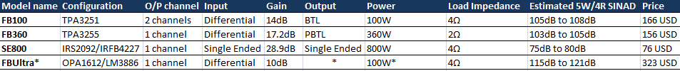

New SylphAudio Products for 2024
*FBUltra specs and name might change.

Pre is a tube preamp. Audioresearch Ls-22 clone.If I understand your bypass correctly, there is series resistance between the preamp and the input coupling caps if you bypass and place jumpers on the opamp socket. If you directly wire your preamp to the input coupling cap, the sound will be inferior. Why is the input saturating and what is the preamp that you are using?

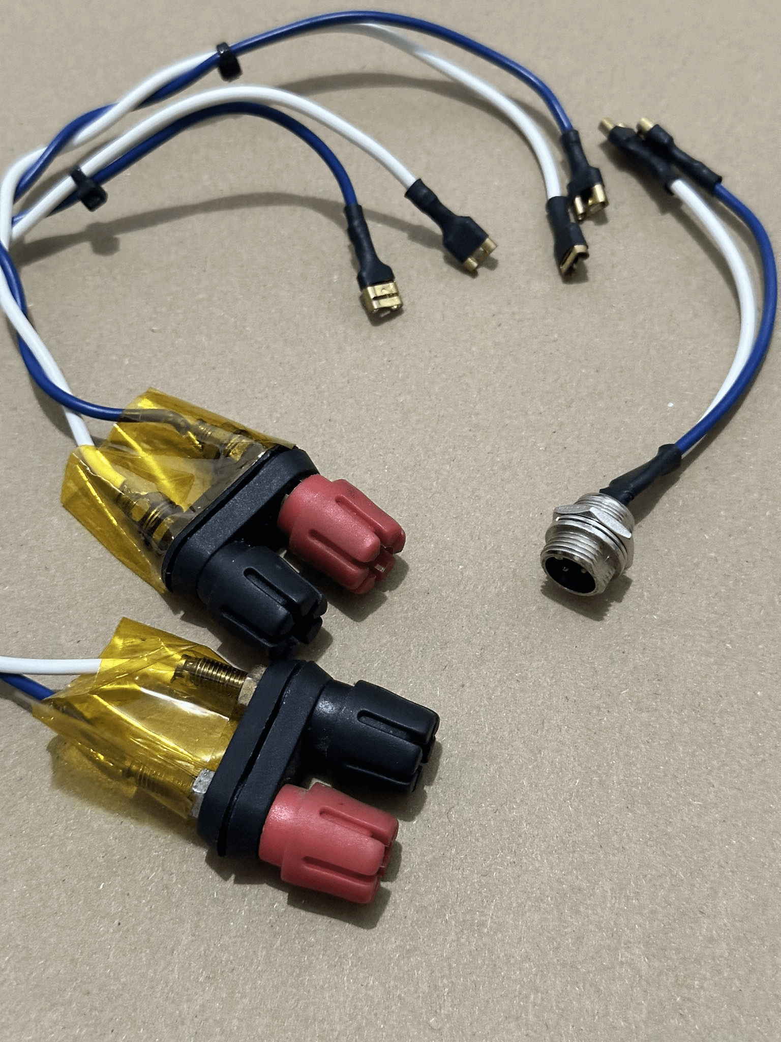

Oh boy, that FB100 is looking delectable. Too bad I'm not really in a situation anymore to do casework myself now 🙁

I see, maybe the series resistance helps in preventing overloading of the inputs as the analog input_x of TPA325x only accepts 7Vpp (14Vpp for differential input).Pre is a tube preamp. Audioresearch Ls-22 clone.

I've created my own wires for that purpose. You only need a 24V to 38V DC power brick. Although at our place, dust will accumulate quickly if the module is left on free air.Oh boy, that FB100 is looking delectable. Too bad I'm not really in a situation anymore to do casework myself now 🙁
No buffer board for next year then ? 🙁😆 It's OK, I know you need to prioritise.SylphAudio Products for 2024

Yes got no unlimited funds for prototyping 😆. I'll send it for manufacturing after the FBUltra* LM3886 amp, I'm aiming for -140dB distortion and lowest noise which will put it in the number 1 amplifier SINAD chart.No buffer board for next year then ? 🙁😆 It's OK, I know you need to prioritise.
On the buffer-preamp I will use either OPA1656 or OPA2156 on the frontend. So that a volume control can be placed before it without much noise penalty. Also, based on my listening experience, using the same opamp all throughout is not as good sounding as when using different opamps on different stages.
