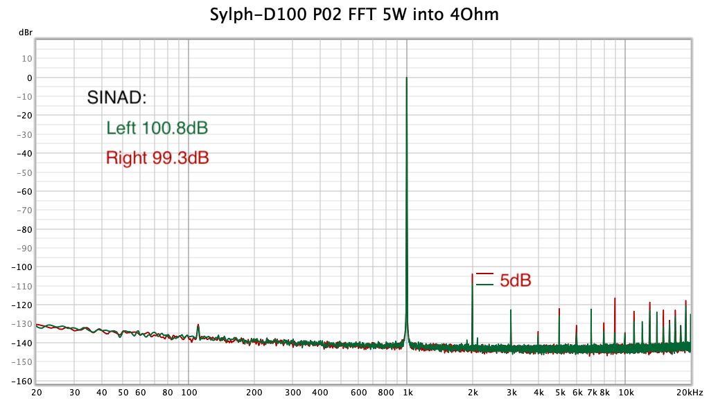

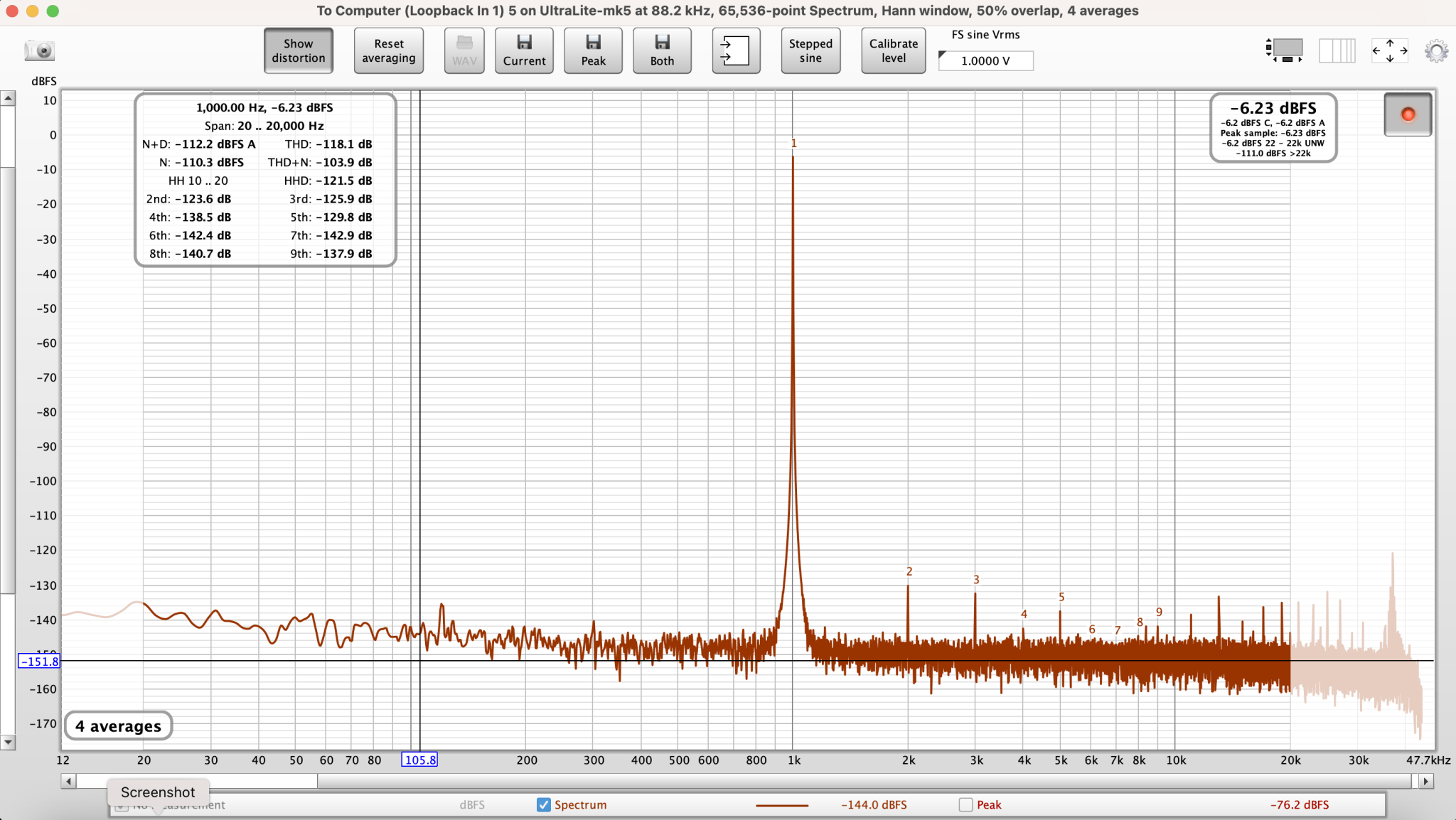

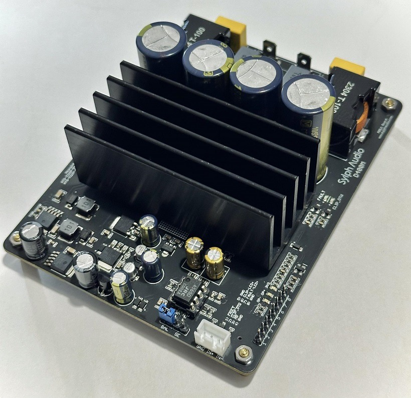

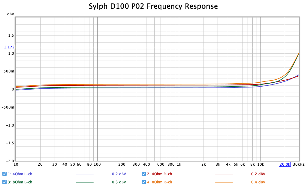

Sylph-D100 repeat measurements, using OPA1656, LRS-350-36 adjusted to 38V
Motu Ultralite MK5 ADC, SMSL DO100 DAC (can drive the output up to 16Vrms)
Needs a DAC with 5Vrms out to drive the amp into 20Vrms (100W 4ohms)
Dominant 2nd harmonic due to inductor selection.

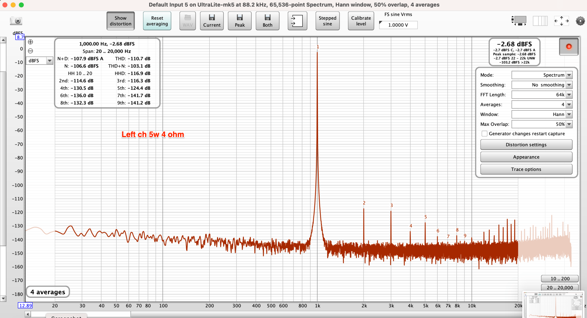

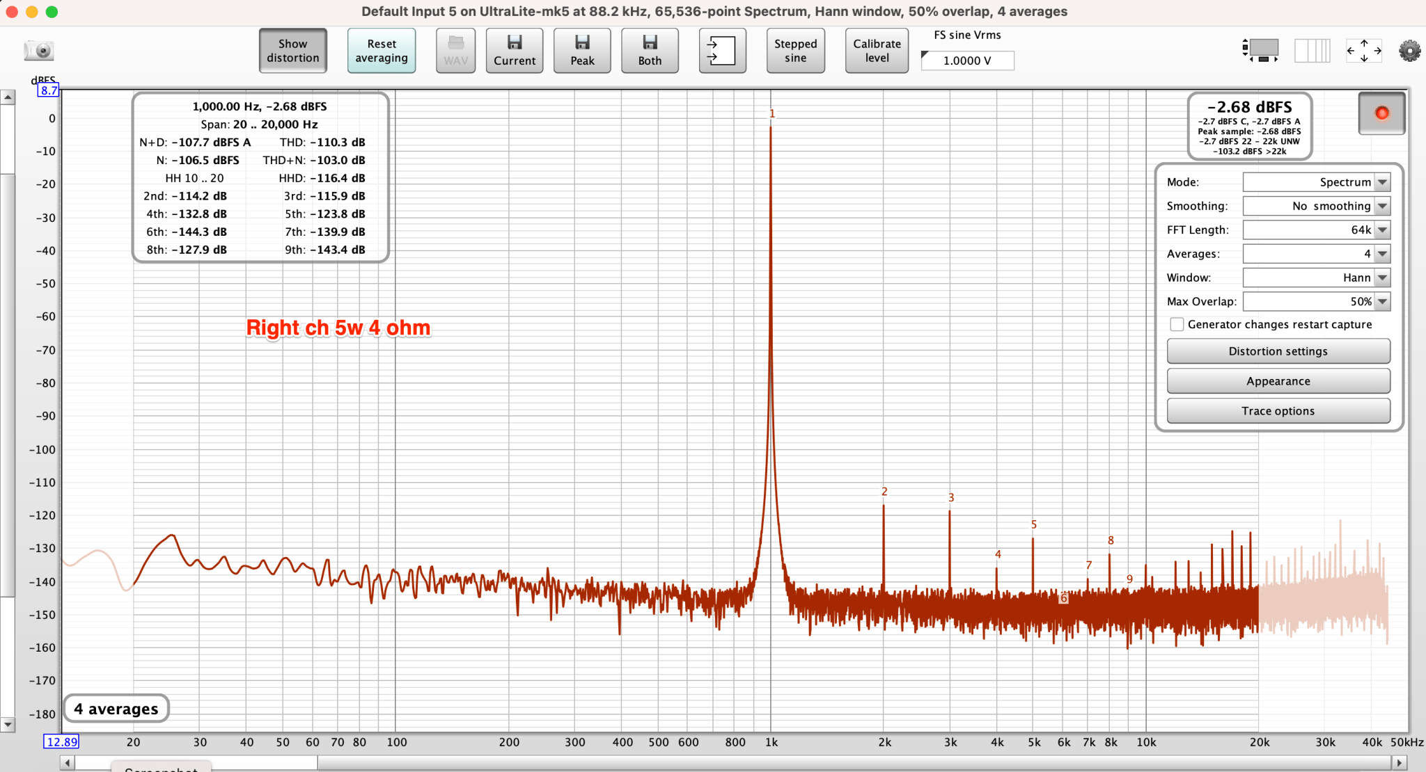

Sylph-D400 5W 4ohms using Motu Ultralite MK5 DAC + ADC.
Using a better DAC can improve noise by 1dB to 2dB, so expect the actual SINAD to get around 98dB~99dB at 52V supply. (I used UL-MK5 DAC since it has better THD than DO100, the DO100 has better noise performance)
Medium gain PFFB can reach 29Vrms (210W 4 ohms) at 93dB SINAD. Onset of clipping (1% THD+N) starts at around 29.6Vrms using 52V supply.
Note that all other TPA3255 Stereo BTL variant can only reach around 160W at the onset of clipping. So Mono PBTL mode has an additional 50W unclipped power advantage.

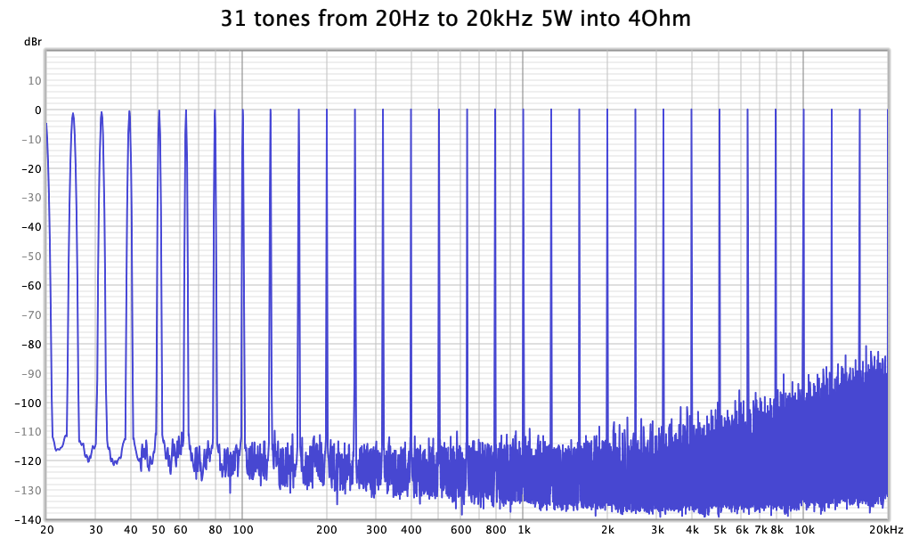

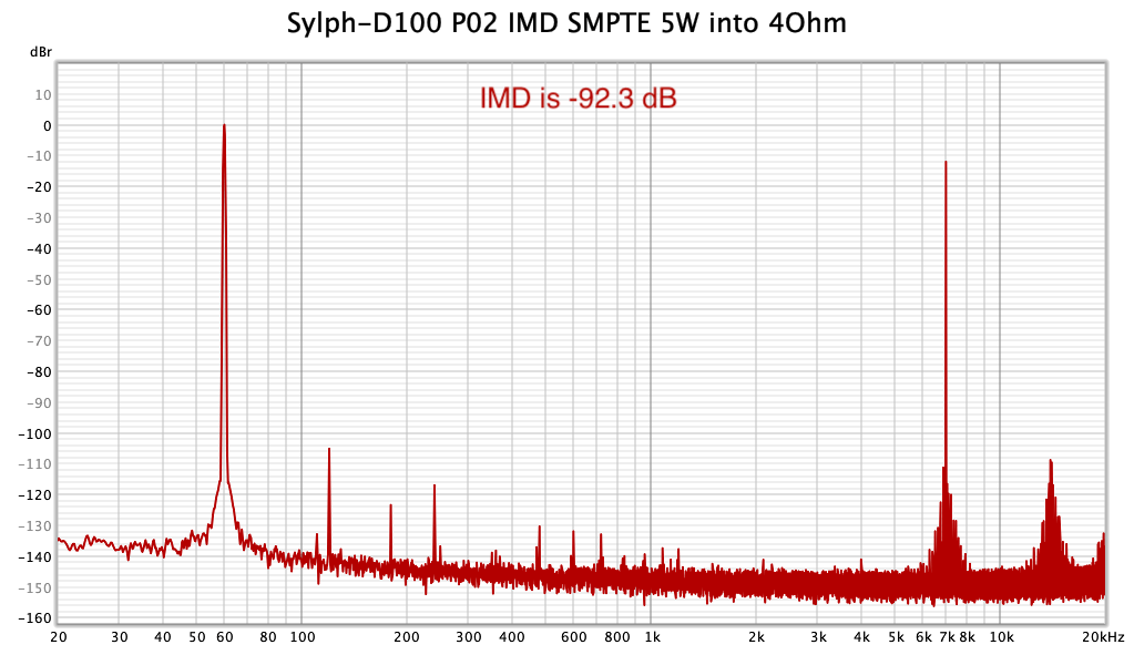

A gentleman from Japan has reviewed the Sylph-D100 amplifier module, providing both multitone and IMD measurements. I didn't send the module, he bought it himself, so I'm thankful for his review.Can you show measurements at 5 kHz and multitone as well?
https://www.audiosciencereview.com/...2-amplifier-module-review.46613/#post-1663923
His measurement methods documented on his site:
https://www.openaudiolab.com/measuring-amps/

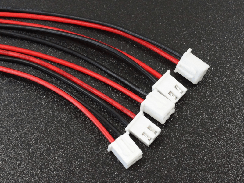

I just received my two D-500 module. Could you give me the reference of the molex/jst signal input connector ?
On my first D500 order a cable was in the box, but not this time.
Thank you 🙂
Thank you 🙂
D
Deleted member 148505
Hi, apologies for the packing issues, the input connector wire should have been included.On my first D500 order a cable was in the box, but not this time.
The connector is JST 2pin 2.54mm (or 2.5mm will work as well)
Same as this one: https://protosupplies.com/product/jst-xh-2-54mm-2-pin-pig-tail-cable5-pack/

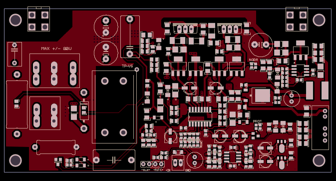

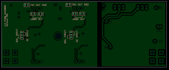

Preamp is single channel per board (4 layer), accepts single DC 24V to 55V. Buck converters to generate +/- 17.5V opamp supply rails. LM317/337 post regulators, no need to use ultra low noise post regulators. Has jumpers for SE in/out, I think 6x voltage gain is sufficient.. Selectable output resistor value (will serve as the R_IN for pffb of D100 and D400 to enable deep PFFB mode 😈 )
- Changed the design to stereo so that it can be useful for other applications. (such as bridging 4x SE irs2092 modules)
- Voltage gain fixed to 5 (same for SE/BAL input)
- Vertically mounted to save space (40mm * 100mm)
- Default opamps are OPA1602(gain) + NE5532(buffer)
- Deep PFFB for Sylph-D100 and D400, (I will also try this on a modified low gain myref)

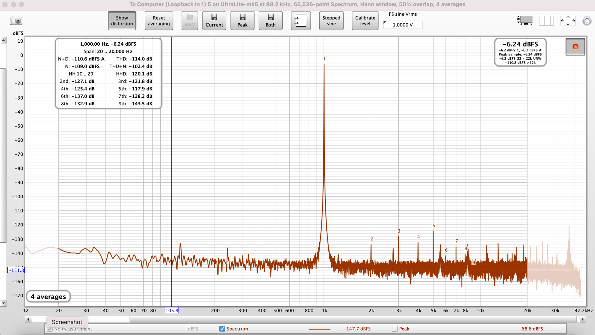

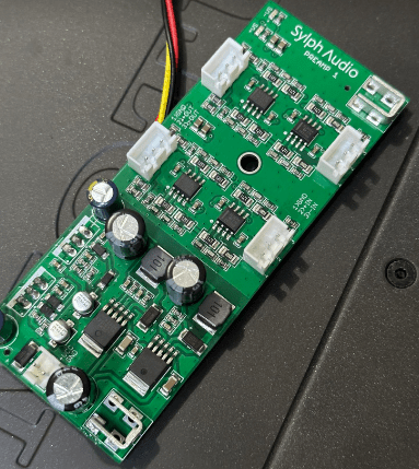

Preamp assembled look, this looks tiny in person. Opamp voltages at +/-17.6V
14dB gain OPA1602 and 0dB gain NE5532
I can only measure around -106dB THD+N at 21.5Vrms out. (Using SE-450-48 power supply)
Will try other opamps specially OPA1612 on the gain stage.

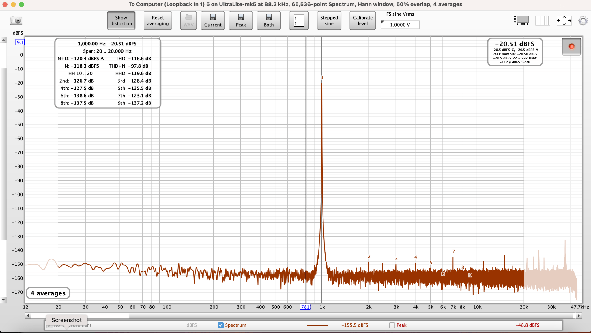

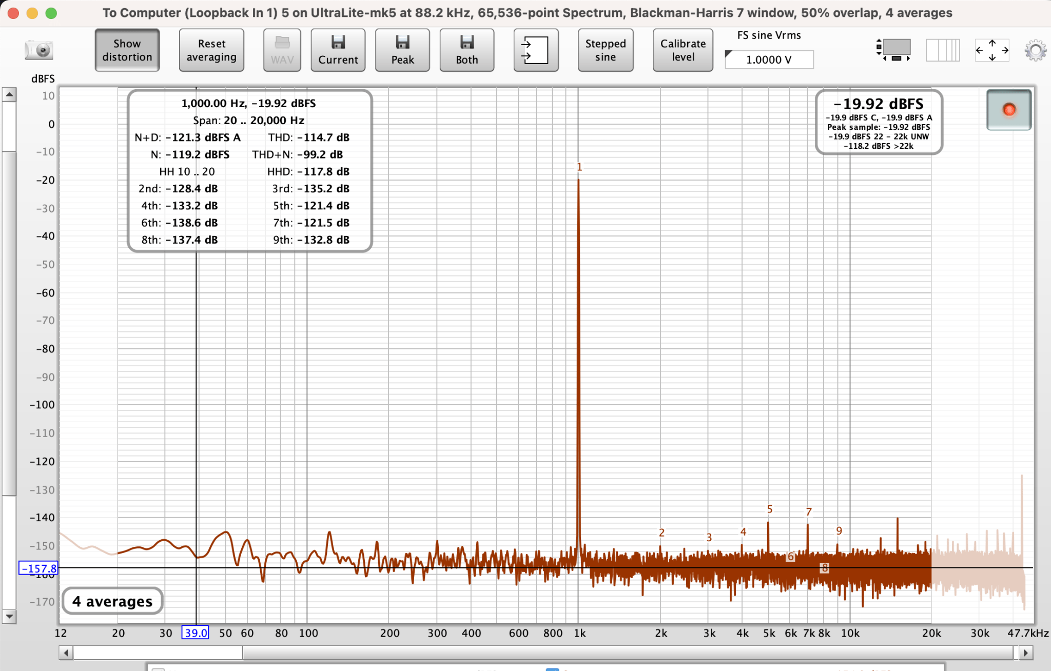

THD+N result of the preamp using different opamps.
Setup: Motu UL MK-5 DAC 1.2Vrms out, preamp at 5.9Vrms out going to UL-MK5 ADC.
UL-MK5 DAC+ADC loopback @1.2Vrms
Preamp with OPA1612 + OPA1602
OPA1612 + OPA1656 has 2dBc worse N (wasn't able to capture)
Preamp OPA1656 + OPA1602
I tried deep PFFB mode, the performance is very picky on the proximity and wiring, so I think it's not recommended to just create a preamp and slap it to any TPA3255 module. (you might get worse SINAD than a non-PFFB amp depending on the wiring). It's doable but you need to have a measurement equipment to optimize the wiring / connections.

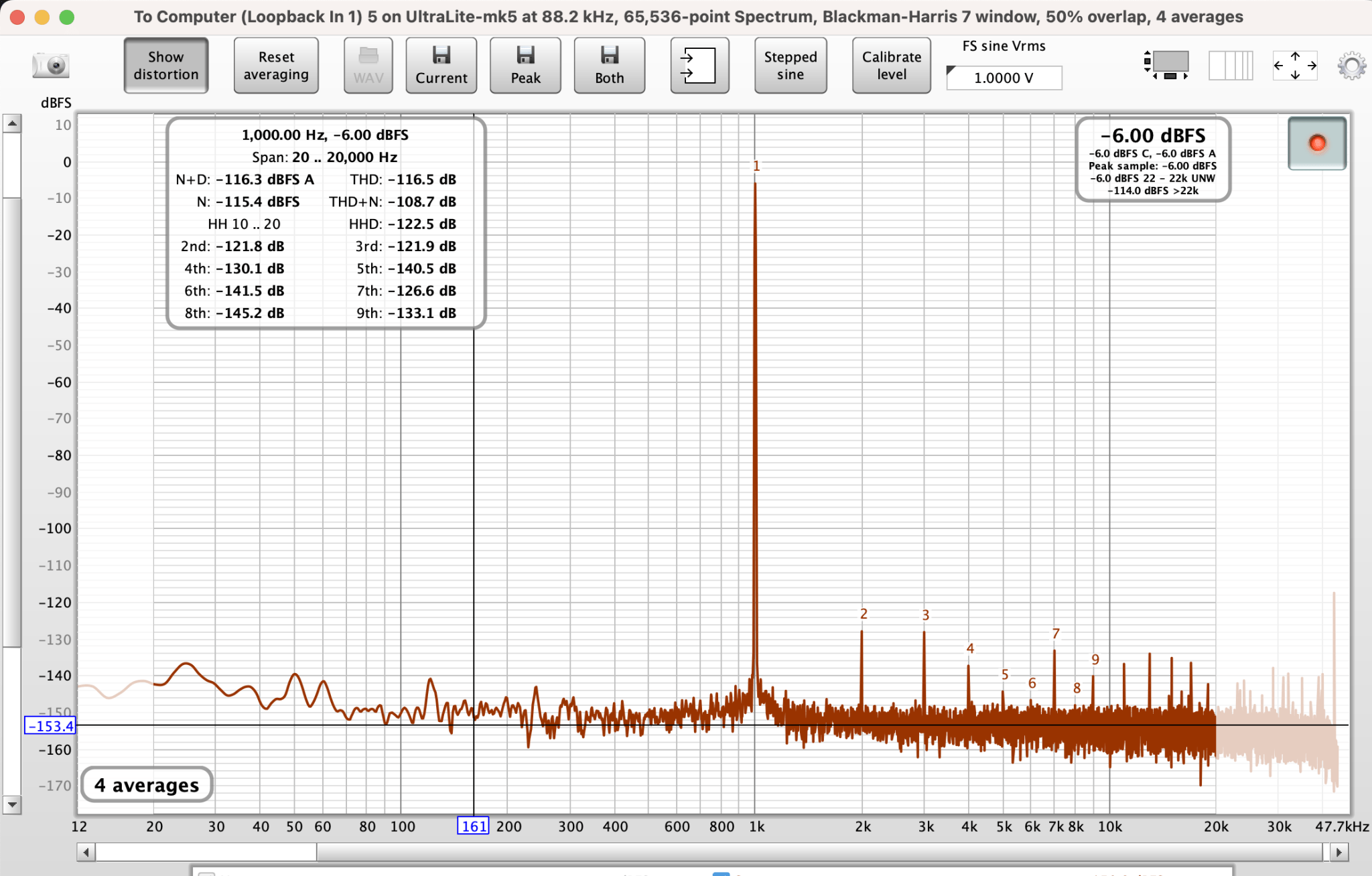

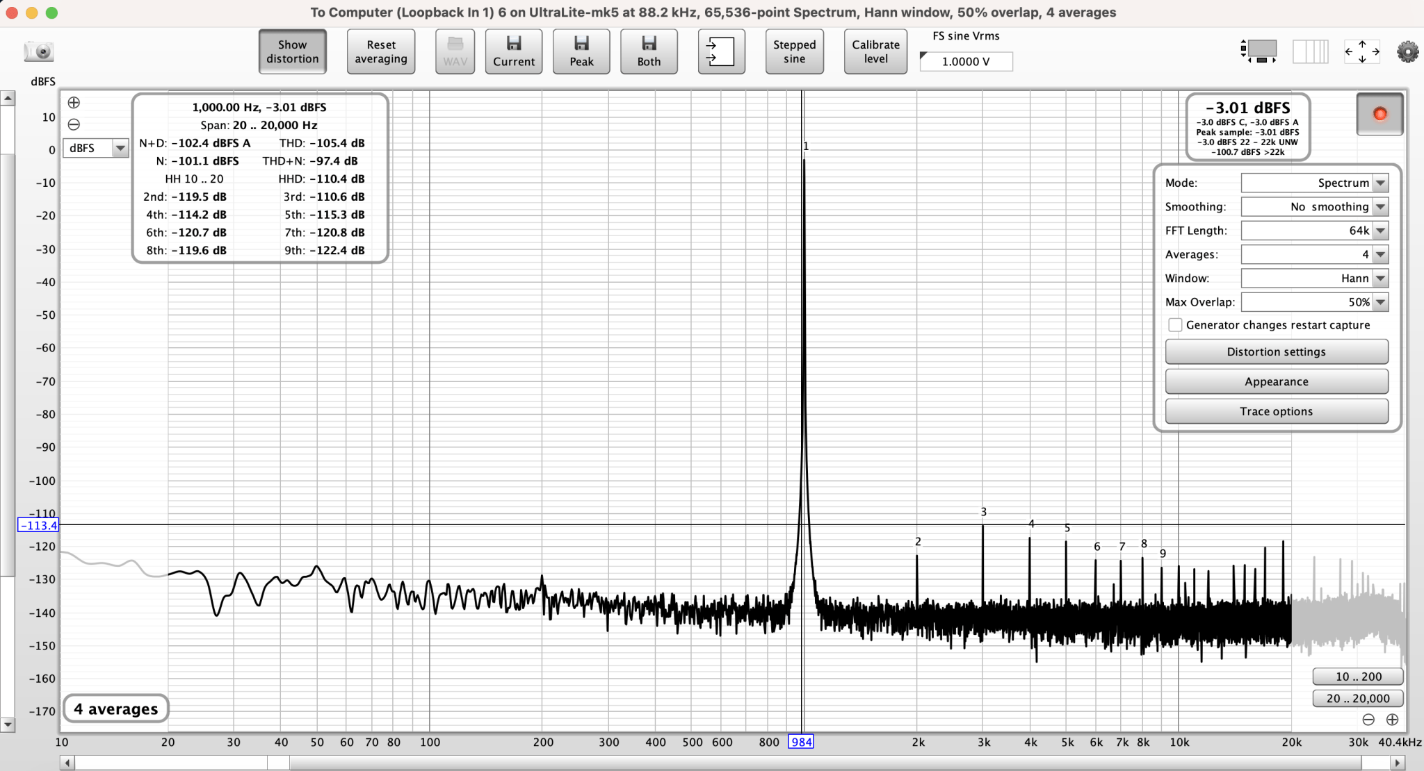

I repeated OPA1656 gain stage measurements using SMSL DO100 DAC as a source.
FFT at 14dB (5x) gain. ~1.2Vrms in / ~6Vrms out
-108.7dBc or 0.0003673% THD+N,
At -1dBFS or ~10.6Vrms, it reaches -112dBc which is near the limit of the ADC.
Anyways, just posting for documentation purposes.
SMSL DO100 to UL-MK5 loopback (~1.2Vrms) (-20dBFS relative to 12V ADC input)

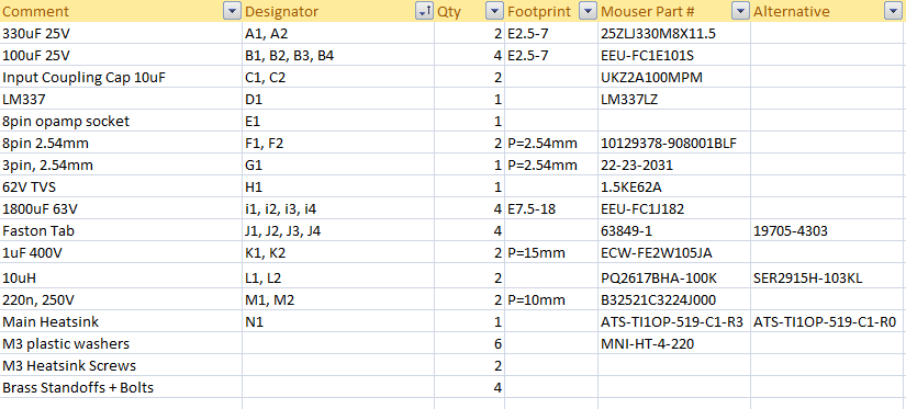

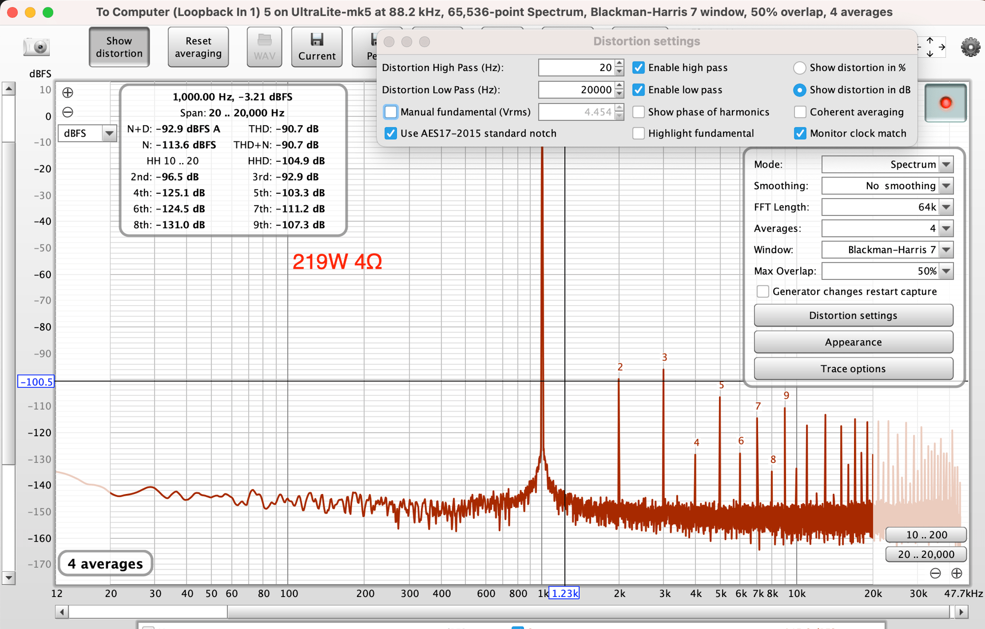

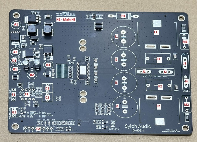

Updated naked D400 price (PCB with SMT assembled parts)What's the predicted cost for the naked D400 Lester?
- 3pcs minimum
- all SMT parts are already assembled
- other parts are not included
Performance before clipping: 219W output into 4 ohms -91dB THD+N
250W output at 1% THD+N

Just promoting our 3pc PCB D400 which is very easy to assemble.
Can survive 20Hz to 20kHz inductive and capacitive tests up to 2Ω load without triggering the fault circuitry. (means no hiccups on most speaker / subwoofer at full power output)
Can reach 31.6Vrms out into 4Ω at -40dBc (250W at 1% THD+N)
I think this can survive a power cube test, stable up to 2Ω which most other amps with deep PFFBs cannot achieve.
