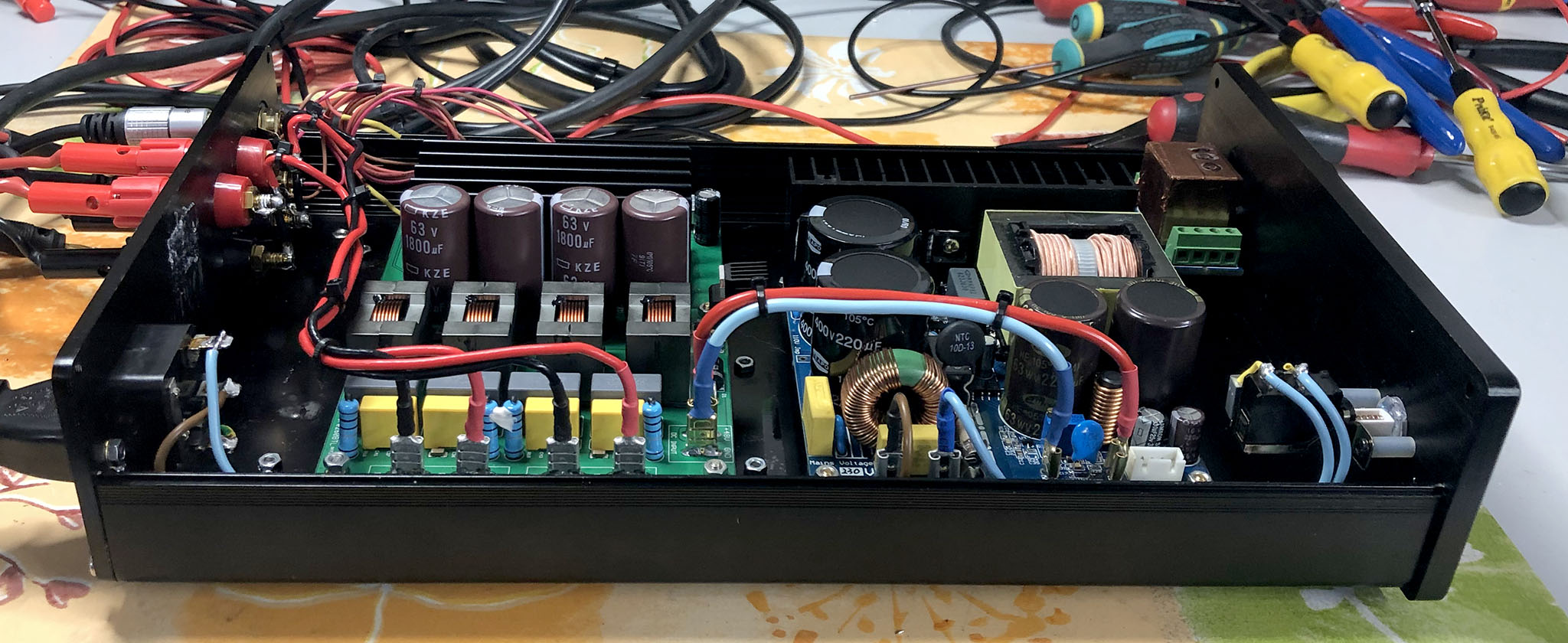

What's the thing on the top-right, is that a volume control for later?
A 100K pot. This is a used enclosure box from an old project. I will not use the the pot with the TPA3255 board.
I disabled the PFFB circuit. At first listening, better headroom and natural voice. It's easy to heard as I'm using full range speakers.
It’s weird. The PFFB shouldn't cause such a big difference in sound.

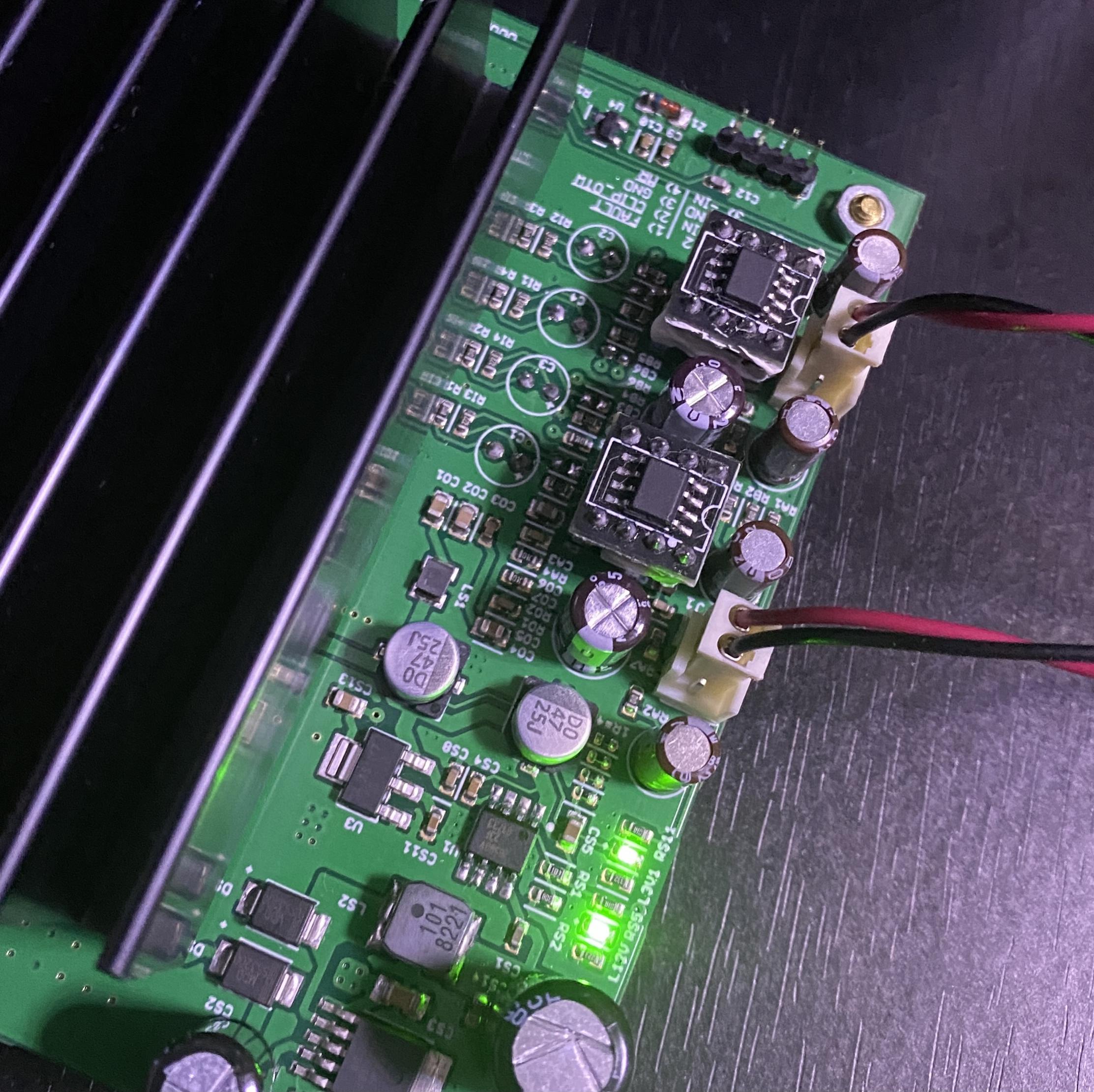

Tried removing the opamp feedback caps in my TICore260BTL.
Opamps are not heating up (LME49860) so looks stable. Also no faults on open load. I'm using LRS-350-36 PSU which has a 65kHz switching freq.
PFFB: The sound is noticeably better and the vocals are more natural (almost the same as non PFFB)
I'm using ELNA Silmic II all throughout, I soldered them under the board so that I can easily modify the opamp feedback caps.
Maybe a 22pF on opamp buffer feedback cap on my board will suffice for stability.
I need more listening tests to confirm.
