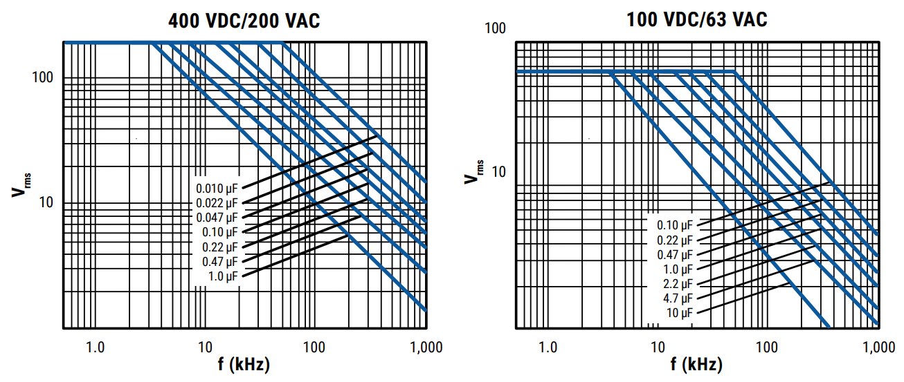

Guys, I wish your statements were true, but I'm affraid it is not that easy. Looking into datasheets of most caps (at least foil types), the voltage is derating at higher frequencies. The higher the frequency, the less voltage it can withstand.
As example, KEMET SMR 1uF:
On the board there is room for 15mm lead spacing, so 63 VAC 1uF cap. Now look at chart. At 45kHz it derates from 63Vrms to only 24Vrms. And as a rule of thumb the capacitor's voltage should be twice of the voltage used in circuit. So in reality, with 1uF 15mm KEMET SMR, we are limited to safely use only some 12V continuous output, or some 1/4 of amp's designated power.
Strange thing is, that the biggest SMR cap with 27.5mm lead spacing rated at 200 VAC, derates even more. At 45kHz it can withstand only 20Vrms. 200VAC cap!

The graph is for 100 deg C ambient + 20 deg C self heating so I think it is for extreme conditions already.
TI note slaa701a has lots of info for cap derating
Yes, at ambient temp. it will be better by couple of %.
In slaa701a, there is not much usefull infos about this particular concern, other than the fact that they selected charts that are worse than the SMR cap, so the SMR is actually the best (most durable) small film cap I have found so far (looking also at derating of WIMAs etc). So it is sort of pleasing result And, in the end, I will be using the amp in similar conditions as Pete - with 36V supply and not playing at disco volumes. That said, maybe my worries are not relevant and will allow to use/test different caps without problem... I hope.

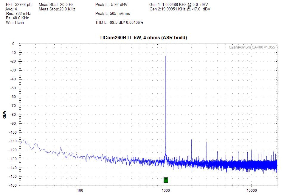

I modified the interface, I placed additional feedback cap on opamps to reduce bandwidth, and changed some resistors, the opamp has less heat now. I will optimize it further. Next month I will use low noise post switching LDO.
Here's the result of my ASR build with the interface running for 10mins (0.0011%).
Noise is slightly higher, it will be improved once I use ultra low noise LDO.
Best is 0.0008% THD, I have to optimize the interface further to get consistency.
