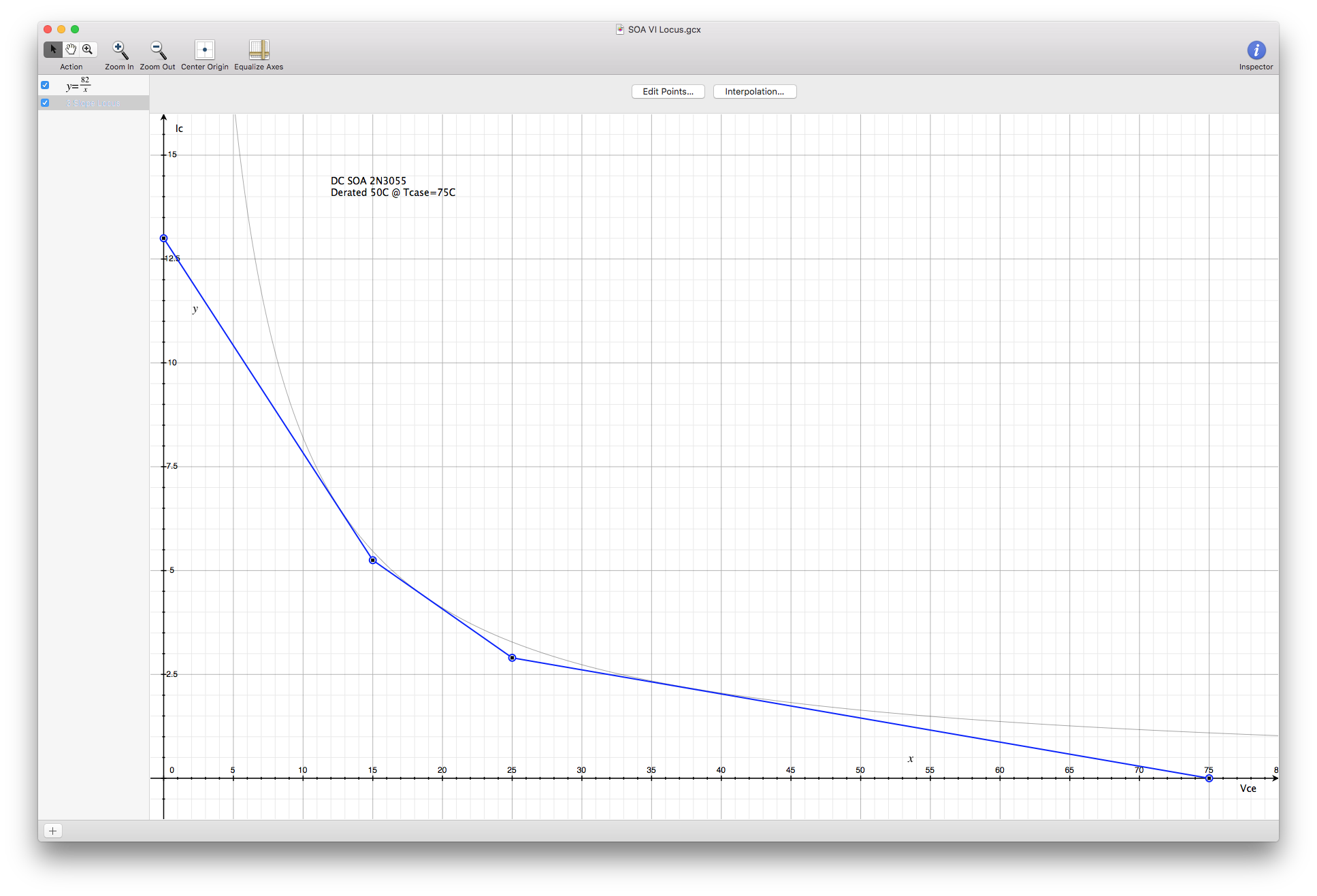

Right now I'm trying to figure out how to generate a linear scale plot of the 3055 SOA, so a load line can be plotted on it and the proper locus can be chosen and derive the protection calculations from it.
I've done quite a bit of calculations already to evaluate how far we can push that thing, and with 4 pairs, it would handle a bridged bridge with 8ohms load, with some reactance, and the SOAs would not run out.
The VI protection really must be pushed to act well above the nominal usage, to be as transparent as possible, so sufficient headroom is required in the SOA.
With the rails not sagging too much and the 70V total rail to rail, the amp can output about 225W/8ohms (resistive). But can handle the reactive loads.
That's just the bridge on a normal 8ohms load.
If the bridge is bridged again, still on 8ohms, then each bridge sees 4ohms and that's a 2ohms load on each side. Quite a heavy burden, but still, it has the SOA to go almost to the max in that case, but if only 4 pairs are used, the VI protection should start to act a little before getting the full power in that configuration.
I think the 5 pairs version probably can handle it all, to the max.
This is an interesting project. Nothing that's been done before by DIYers I think.
The method to act on the input by the limiter should be transparent when not acting. Not adding distortion and noise. This was fairly the case if using those VTL things, but without them, I don't see a good replacement. The JFETs don't seem to measure up, but there may be no choice there..

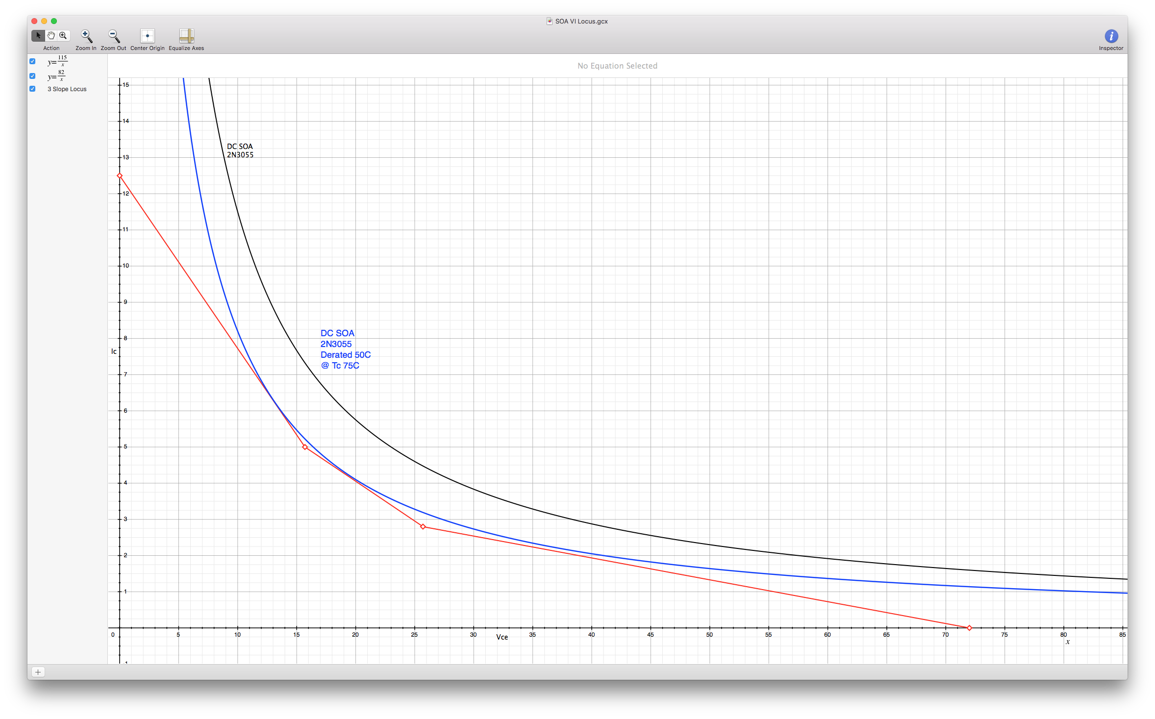

I discovered a little program that I never knew existed, and I used that to plot a derated DC SOA for the 3055 and then plot a 3 slope locus that maybe could be used to design the VI limiter. (attached)
For a while I was thinking a 2 slope might be easier and sufficient, but the 3 slopes makes more use of the available SOA and it's not that much more complex. It doesn't take that many more parts, and those are the cheap type.
So I plotted a potential 3 slope locus, which hugs pretty closely the derated SOA curve. I derated 50C to a case at 75C, which should bring down the power to a little over 82W, so I used 82W for the SOA curve.
I don't know how to properly derate that small part at the low currents and high voltages where there is second breakdown. It's a little bit lower, but how to derate that? Anyone can offer some insight?
The low segment of the locus may have to be moved slightly down to accommodate for the second breakdown..

For most types, a specific s/b derating curve is not given. Just a couple of clues like “Second breakdown pulse limits are valid for duty cycles to 10%”, and “at high case temperatures thermal limitations will reduce the power that can be handled...” These statements would imply that you derate thermally first, and if the s/b limit is less, you use that. This is probably ok if the breakpoint between thermal and S/B limits is greater than the rail voltage (half rail to rail). The only reason you will ever sink current below the zero crosssing is driving an inductive load where no current limiting is happening. This out of phase current only happens for a small fraction of a cycle. What really hurts power transistors is just plain trying to drive too much current into a low impedance or short circuit. Running in current limit into a short at bass frequencies ispretty darn near a worst case, and pretty much guaranteed to happen eventually. Dr-rate thermally for that case, and it’s probably pretty safe.
Some transistor types have a thermal derating curve for s/b limits. It is usually linear to 60% of the s/b limit at 200 ( or 150) C case temp. I’ve only seem that curve used with relatively fragile switching types which have very poor s/b SOA anyway.
So I guess it's probably fairly safe with that possible locus as on the previous snapshot.
Perhaps to be as safe as possible, making sure not to hug the derated dc curve too closely at the high voltages end would be ok.
I improved that plot a little, so I'm posting it again.

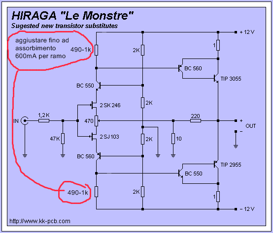

Hiraga "Le monstre" .... TIP3055 TIP2955. A class, easy and sound is good for me!
That's an all different league there. Very nice for the sound, for sure, but we're talking about 20W, or perhaps pump it up so some 30W, with very beefy everything...
We're in a different ballgame here. Trying to do something that's never been done before with 3055s, aiming for well over 200W/8ohms, and more if the bridge is bridged again... More than 10 times what the class A can do.
If someone can make a class A amp with 3055s that can put out more than 200W/8ohms, I'd like to see that! A "tour de force"!!
