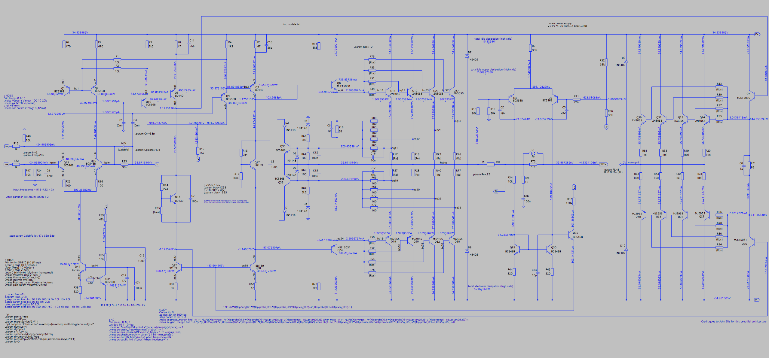

Amplifier based on 2N3055

If we went strictly by the book (the datasheet), the Vce0 of 60V would impose a rail to rail voltage limited to about 60V, or perhaps a tiny bit more because there are losses and overhead preventing the whole spread to be applied to the ce junction. In the design in question here, I go for 70V rail to rail when idling at no power output, and knowing the rails will sag a little at full power and there are losses and overhead, the ce junctions aren't subjected to much more than 60V.
When at the onset of clipping, the sims have shown the ce junction to experience 65V of swing, which is 5V more than the datasheet rated Vce0, but that likely won't be an issue with the parts. We're really not pushing them very much beyond their rating and we know they do handle more than that, most of them...
For the sims, I put an impedance of 0.1 or 0.2ohms on the power supply, which probably is similar to a real supply. Or the real thing may even be better, with a beefy transfo, big rectifiers and huge filter caps with low ESR and all that...

The last major hurdle on this design is to get the protection working properly.
I tried a little something yesterday, I put an extra transistor on the input stage current source to bring down the tail current, thinking when the protection acts, it would cause a drop of tail current and prevent the fight agains the protection from acting.
But what I find is that the diff stage keeps amplifying pretty much all the way until its tail current is totally gone, so there is no way to smoothly control this and this seems like a bad idea to use for protection.
The main issue in this design when it comes to VI protection, is that although we sense only on the high side of the bridge, the action should be done on both sides, and that's not as easy as it should be.
The bridge has separate stages for output, drivers and vas, but only a single input stages.
That's one of the beautiful things about this architectures.
But how to apply an action from protections remains to be devised.

It's a tricky thing to put proper VI protection on this architecture and make it work as intended, but once this is made to work, that amp design should be good, robust and reliable.
I've never seen any 3055/2955 amp designs giving true (rms) 200W output (on 8ohms). Without totally trashing the signal along the way...
This design would do this, and have quite decent performances.

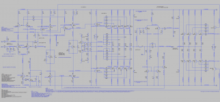

By the way, here is the 4 pair grounded bridge that I've been referring to. It works, but the protections are disabled in this schematic.
