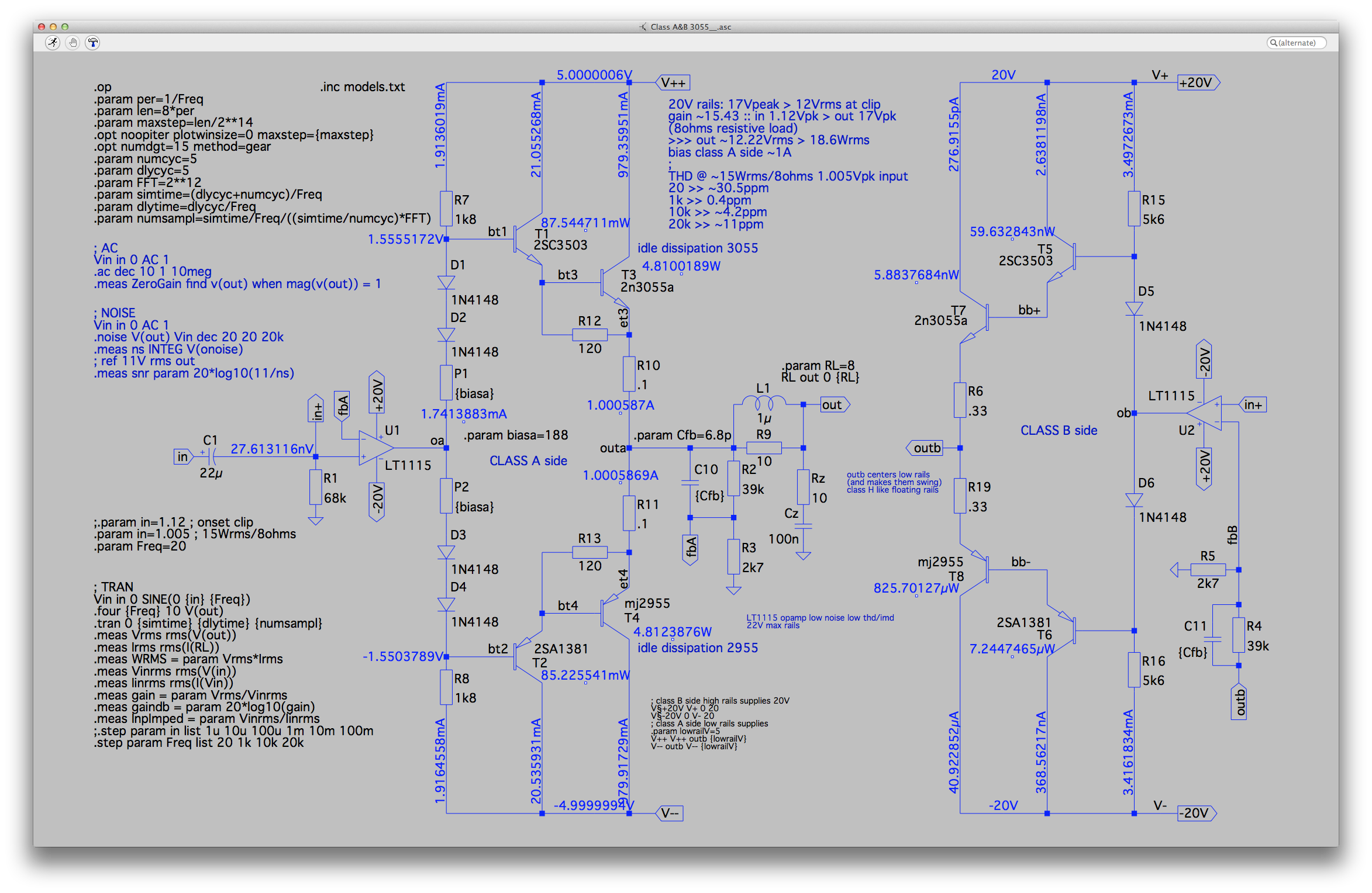

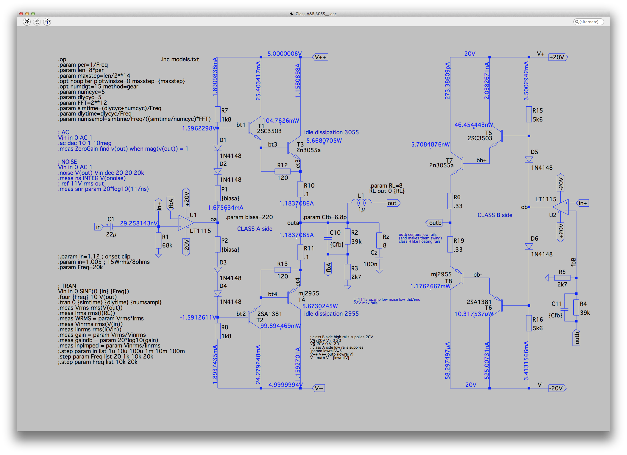

As I'm trying to tweak some models, I'm testing them on some old sims.
Here is a sim for an other interesting amp topo, a hybrid of a Class A with a Class B, based on an old (1982) elektor circuit.
A few things were changed to make it work right and have decent results.
The sim runs nicely even with the un-tweaked models, that I included in the sim file itself to avoid calling up an external file. So it should run right out of the box.
The Class A amp runs on only 5V rails as it is in that sim, and the Class B runs on 20V rails. The Class B makes the Class A rails float, so although the Class A amp runs with a rather "rich" bias at about 1A in the outputs, the dissipation is less than 5W in each device (power ones), and the dissipation in the Class B side is minimal, with just about no bias at all.
This amp is fairly simple, with a fairly low part count, so this could make a rather easy build, and it's a 3055/2955 amp.
I wonder if it would be better or not to have separate heatsinks for both sides...
In that sim I used the Linear LT1115 opamp, which is very low noise, low distortion and works great, but it's not too hard to try out others if need be.
There are slight differences with the original elektor published circuit, as I found that when I tried to simulate it as it was designed, it wouldn't work quite right and performance was nothing like a Class A amp should be.

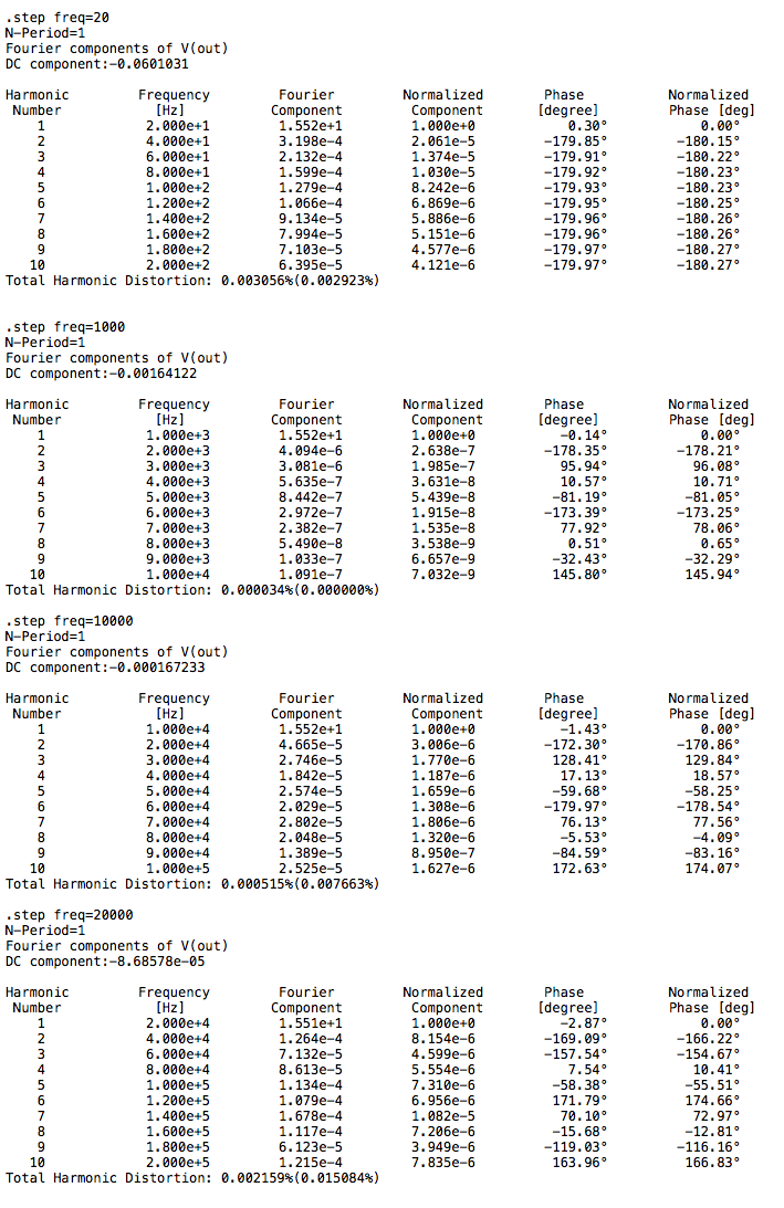

Now this is still only a small 3055 amp, but the results look pretty nice.
It's not a powerful beast, it can reach a little more than 18Wrms on 8ohms (resistive), but by then it's the onset of clipping and the thd starts rising a little before that.
However, it performs rather well at 15Wrms, and I tried it at many power levels, starting with tiny input at 1uV, and it looks pretty nice all the way up.
With the reduced dissipation on the Class A side due to the low rails, and almost nothing at idle from the Class B side, it shouldn't get overly warm, with decent sinks, and overall the dissipation should remain lower than what a Class A amp.
It's a weird topo, with 2 amps of different class, the rails float, kind of like in a class H, but it's not a class H.
The original design had the class B side extremely "barren" (spartan), and the thd wasn't so nice.
This altered design does use a few more parts on the B side, but not much, just 2 diodes and 4 resistors. Nothing to break the bank and add much complexity.
I tried to keep that part count as low as possible for a good compromise in performance. It can be improved further, at the cost of a few extra parts, and the thd can the be made to drop well below 1ppm at all frequencies.
The one thing that's a bit more complex is the dual supplies, and the high rails one could go to the opamp's limit at 22V eventually, for a few extra watts.
Perhaps the high rails could be made so a higher voltage could be given to the B side, while the opamps stay at 20V, for even more watts, but I haven't tried that.
The small part count could make for a small PCB. Maybe 2 heatsinks, but probably not too big.

Your output Zobel does not seem right.
You have 10r R9 plus 10r Rz in series with 100nF. That rolls in at ~80kHz. That seems far too close to the audio band.
better change that by adding 8r+47nF at the output.
Then change R9 to 3r3 and change Rz to 4r7 and keep Cz @ 100nF
This will give a good Zobel (equivalent to 4r+147nF) at a higher frequency (~270kHz) and attenuate RF coming in via the speaker cables.

Actually, I was reading (again) one of Cherry's papers where he mentions the zobels and the 2 forms suggested by Thiele, and thought about using the one that has no resistor in parallel with the coil, so I would just move the zobel in and cut out that extra res.
Your option would also work of course. Maybe a comparison, to see what works best...
However, while testing it further, as I had not tried it before with anything else but that 8ohms resistor load, I tried a lower 4ohms load and that makes it clip much too early.
So I'm trying to figure why it's clipping early. I thought maybe the opamp's inner limit was doing it, and although it seems fairly close, I'm not certain that's it.
I found out the class A bias also wasn't quite high enough for the full power.
It should be about half that of the peak load current, and at about 1amp, that falls a little short, which can explain a little of the rising thd a little before it actually starts clipping.
Raising that bias current in the outputs to about 1.18amps (on their emitters), brings it closer to optimal. I tried a range of bias and that's about optimal there. Anything higher and the thd rises again.
Then I thought perhaps that also had something to do with the reason for clipping earlier on 4ohms, but raising it beyond 1.18amps has adverse thd effect, and it doesn't solve the early clipping anyway.
So the reason for the earlier clipping on 4ohms remains a mystery so far.
It really needs to work right on 4ohms, so that would represent the worst possible impedance situation under a difficult 8ohms load. Reactive and all.

I tried both versions:
R9 @ 3.3 and 4.6 on the zobel (keeping Cz 100n)
no R9, Rz @ 8 and move the zobel "inside"
Both options give improvements at the higher frequencies, about the same magnitude, and change nothing at the low end.
The highest thd is at the low end at a bit more than 30ppm.
Still hifi, but perhaps this can be improved.

Here, I had not adjusted the bias on this one to the more optimal value.
Raising it to ~1.18amps is better.
But the low end remains unchanged, same thd, and more than at the high end.
Maybe a bigger input cap might help a bit.
Not bad for a 3055 amp.
The increase in bias adds less than 1W per device of dissipation, still well below 6W (idle) per device. Still easy enough to dissipate, for a class A.
The peak dissipation in each device at full power is close to 4 times the idle, and the average almost twice. All well within the 3055 capabilities.
Running the A side at 5V really helps cutting down on dissipation.

I just ran the tian probe to see what the open loop gain looks like and get a reading on the phase and gain margins.
Amazingly, there isn't a huge amount of phase shifting in the useful band, so at unity gain, we're still at about -100 degrees of shift, giving about 80 degrees of phase margin. At least there's that. Then the phase shifting kicks in higher gear but not enough to bother it, and we end up with decent gain margin of about 15.6db. That part isn't bad and the amp seems stable.
But the oddity is at 10hz. It's funny how the closed loop gives such a huge gain spike right there at 10hz, from the 32 and some db nominal gain, to close to 45db at the height of the gain spike. And the open loop instead has just about zero gain at that same 10hz, and a big phase reversal happens right there.
I wonder what causes this, maybe the bootstrapping?
Since this amp is so similar to yours, even with the extra pre-driver stage, it probably behaves similarly.
Perhaps mooly could use his sim that he made earlier and let us know how that one behaves. 🙂

By the way, those last sims were done after I tweaked the models a bit.
Increasing the VAF to more real values worsen the thd figures somewhat.
I raised the 3055 VAF to 150. A conservatively more realistic value. As John Ellis measured on a real part about 181, we're not far off and better than the small amount that was there before and that was wrong.
Not knowing what the 2955 has, I arbitrarily put 140 for VAF.
More parameters need tweaking. Those models are modpex (nuff said) 😀
