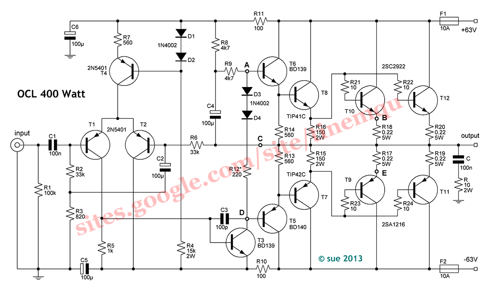

you mean like this one???
http://www.diyaudio.com/forums/atta...mplifier-based-2n3055-ocl-400-watt-sanken.gif
i've just open google and found it...
Again - Purely Mythical Output Power...
@ spookydd: This ist EQUA's schematics:
Best regards!
@ spookydd: This ist EQUA's schematics:![]()
Best regards!
Best regards!
Thanks!
Capacitor coupled, and no ltp front end.
Old design.

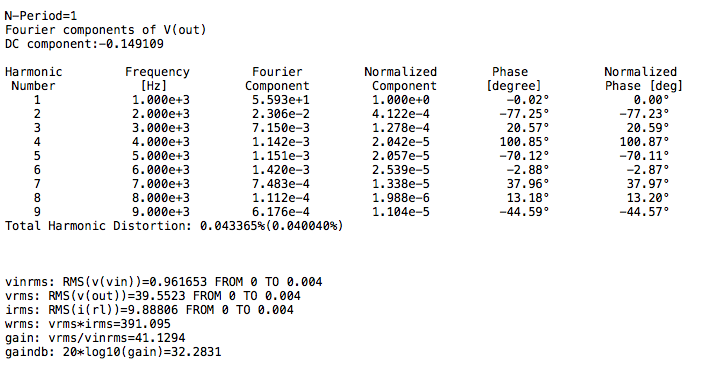

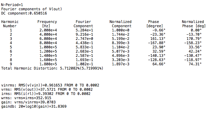

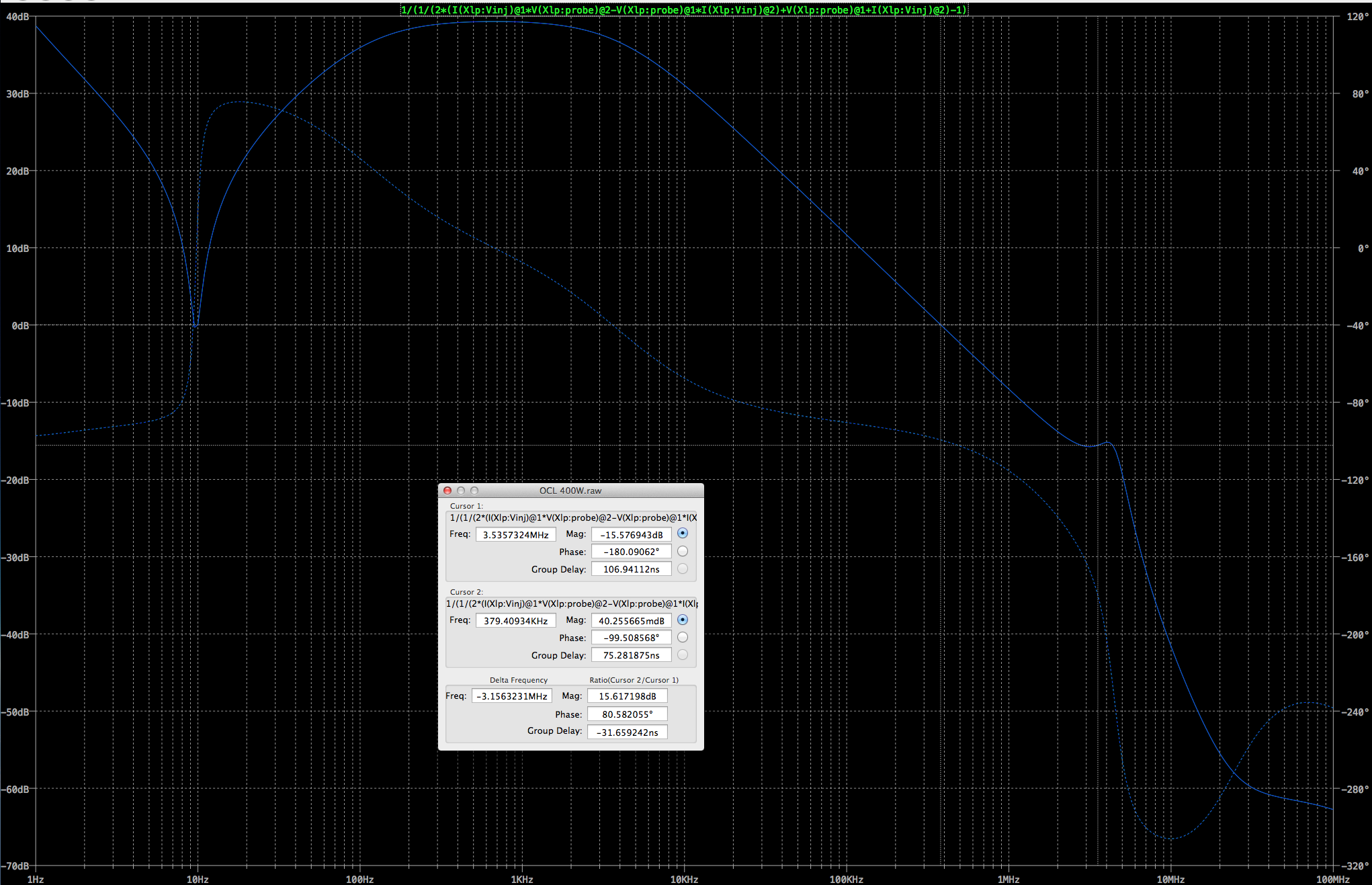

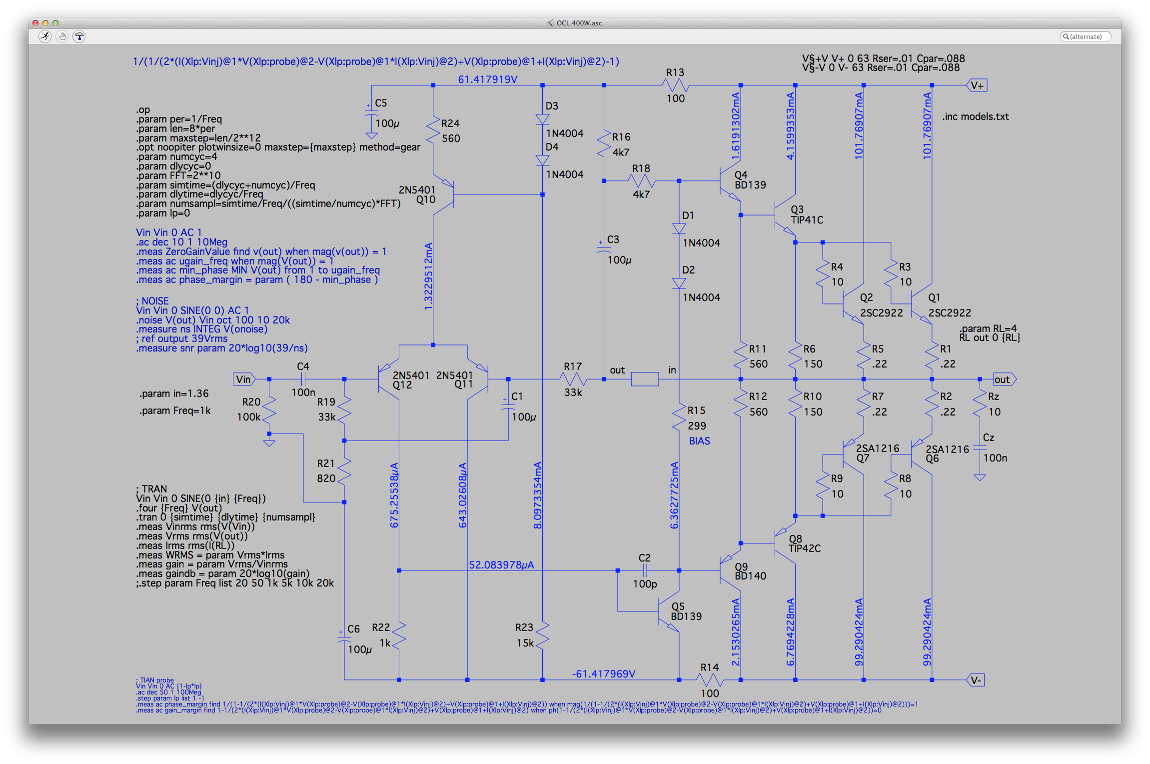

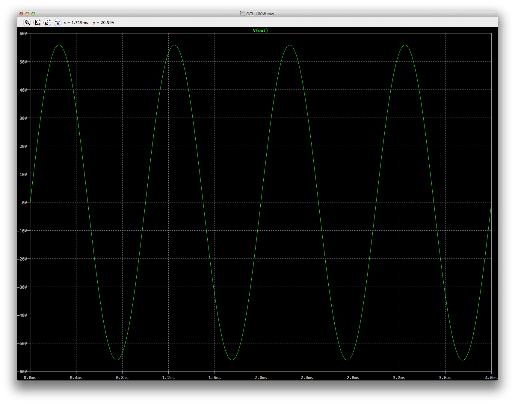

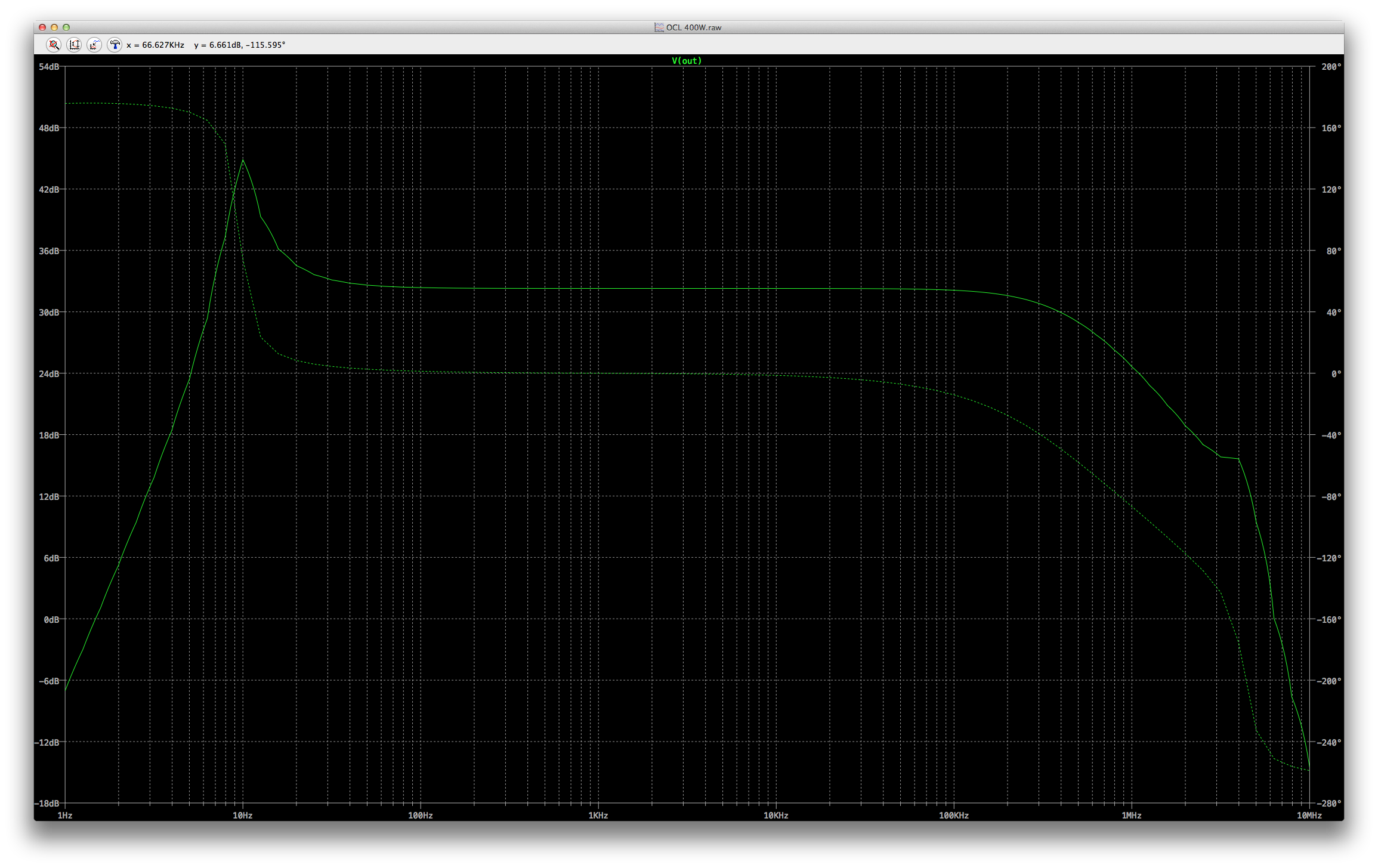

I was curious about that amp with the japanese parts, so I made a quick sim of it.
It's the same topology as the 3055 version, except mostly for the extra pre-driver stage (3EF), so although it's not a 3055 amp, I'm posting it here because this is where we're discussing it.
I suspect similar results to be expected from the 3055 (2EF) version.
For one thing, with the bias resistor left at 220ohms as on the schematic, there is hardly any bias flowing in the output, nearly nill on the negative side, a few mills on the plus side.
So I biased it at about 100mA per output device, rather rich, because I noticed heavy distortion.
The gain is around 41 (a little over 32db), and as it's not a symmetric design, as I expected, it starts clipping on one side before the other, so it clips on the negative side first, which brings the onset of clipping level down some.
At that onset of clipping level, it takes 1.36V (peak) to drive it. The load being 4ohms pure resistive.
The sine wave look somewhat ok, but that's at 1khz, and it gets bad when going up in frequency.
At 1khz the THD doesn't look overly bad. We're at full power, before clipping, about 391W rms on a 4ohms load.
But things change when raising frequency, a lot. I got more than 5% distortion at 20khz, and the input level would require adjustment to retain the same power level, because of the gain drop, from the overly narrow bandwidth.
Noise isn't a concern, as it's close to 118db SNR (referred to 39Vrms output).
The AC analysis reveals a big gain spike at 10hz. From the plot shape, I suspect some issues may be there when open loop.

I just ran the tian probe to see what the open loop gain looks like and get a reading on the phase and gain margins.
Amazingly, there isn't a huge amount of phase shifting in the useful band, so at unity gain, we're still at about -100 degrees of shift, giving about 80 degrees of phase margin. At least there's that. Then the phase shifting kicks in higher gear but not enough to bother it, and we end up with decent gain margin of about 15.6db. That part isn't bad and the amp seems stable.
But the oddity is at 10hz. It's funny how the closed loop gives such a huge gain spike right there at 10hz, from the 32 and some db nominal gain, to close to 45db at the height of the gain spike. And the open loop instead has just about zero gain at that same 10hz, and a big phase reversal happens right there.
I wonder what causes this, maybe the bootstrapping?
Since this amp is so similar to yours, even with the extra pre-driver stage, it probably behaves similarly.
Perhaps mooly could use his sim that he made earlier and let us know how that one behaves. 🙂
