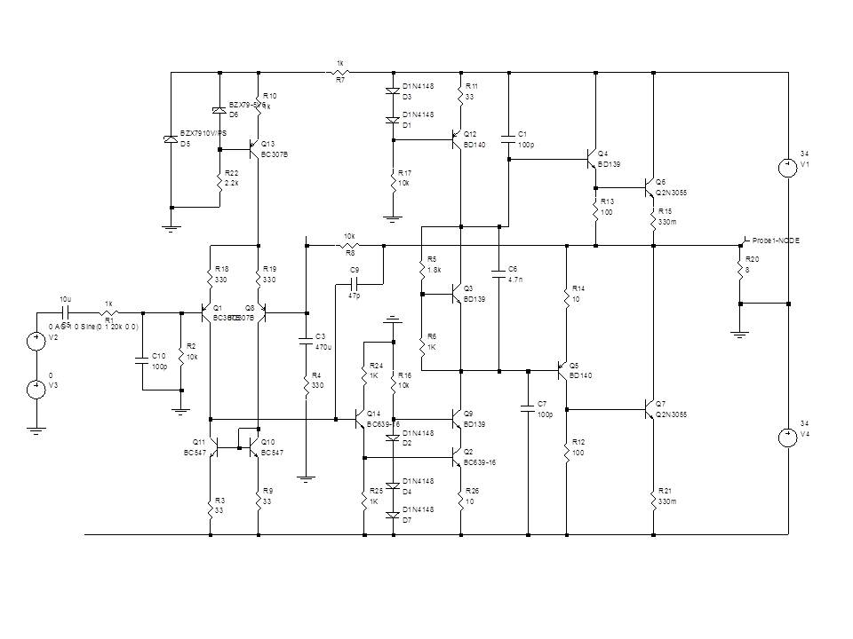

Oh all right then.
Features: "Cherry/Stochino" high input bias current to prevent cut-off during transients, cascode driver to eliminate Early effect distortion, high VAS current to prevent VAS cut-off during transient. Output stage quasi - excellent matching between halves, low distortion (but probably not as low as could be achieved with full complementary).
Effectively a Cherry-Blameless quasi combo!

Interesting.
Doesn't high current there increase noise a lot?
Why is there an extra zener D5 near the current source?
Bob Cordell described such an improvement, with the benefits. What I don't understand is the purpose of C9, which must be what you described as "inclusive of the output stage", instead of the miller cap. How does that miller cap make things worse?
That's ok, we know what we get when using quasi, but still, it's not that bad.
How low is the distortion?
What about TIM?
Have you actually built one for real or just ran sims?
Why not adding an extra pre-driver stage and 2 pairs of outputs?
Those have also good extra benefits, not to mention being able to drive heavier loads. Cordell also described this and it's all a plus to do so.
I am wondering about C1 and C7 though. Is the amp unstable without them?
What's the bandwidth obtained?
Too many questions.
Yes I have built one and it sounds good. Distortion simulated is .007% at 20kHz. Bandwidth over 200kHz. If you use a Miller capacitor the VAS driver is slowed down at the very point you want it to speed up to minimise crossover distortion. This is the whole point! Yes it needs "sprog stopper" capacitors. Try to get hold of Cherry's "nested Differentiating Feedback" articles. This isn't but it uses Cherry's approach to stabilising inclusive miller feedback.
John

Sorry about that, I'm just curious and I had never heard of that "nested Differentiating Feedback" before.
Ok cool, I'll dig something up.
Not bad result though. Probably too complex to attempt for the average diyer.

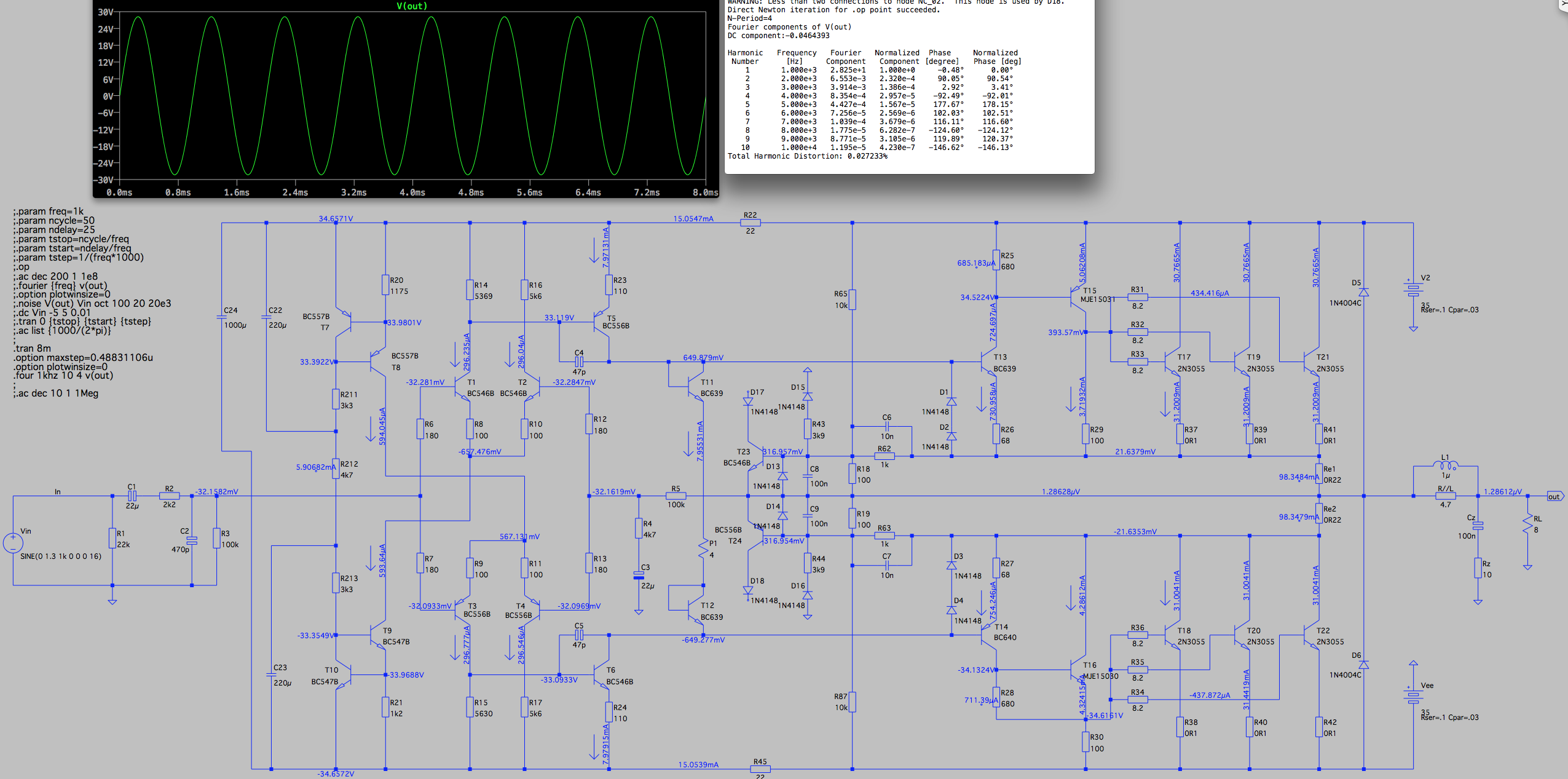

I am trying to make sense of spice with a sim of this 3055 amp. Using only the high side as we simulated before and trying to figure out the THD.
I'm attaching the sim file as it is now. I set it for a 1.3V for input signal, which gets about 28V peak to peak on the output, so roughly 50W for 8ohms load.
I see a THD of 0.03 and change... Is that about right?
How are we to interpret the FFT plot?
The protections are there but nothing really calculated, they're as they had been for some time and they don't seem to interfere with this for now.
I push the signal higher and it seems to clip at about 32V peak, so on a psu that doesn't droop too much, with the 35V on the rails, this gets close to 60W with an input at about 1.4V, but the THD goes up of course. The real thing could have its rails drop somewhat.
There is one thing I noticed though. When pushing it a little higher, such as about 1.5V input, then there is a kind of clipping towards the low rail but not the top. So it's not quite symmetric. How can we track this? Where does this difference could come from? Can this be corrected somehow?
Then I'm thinking about using this later to verify the protection action. What's the best way to test this?
Ok, I put the input signal back where it belongs before the input cap. I upped that input cap's value, but that's besides the point.
I thought that by adding a source to add an offset to the signal it would cancel out most of the existing offset present on the output (about 32mV), but now that I moved the input signal to before that input cap, it's useless, so I left it but put it at 0V.
Anyway, I was surprised to see that unsymmetrical defect go away with the input source before that input cap, even more, when the output offset went down from around 32mV to some 3.8uV...
The signal on the output is better now and at 1.3V on the input, we get about 28V peak and I put the load at 8ohms. The THD is then about 0.0293 and it's a little before clipping, but basically full nominal power.
That distortion goes up a bit on the 4 ohms load, but not hugely.

Alright, I did some tweaking on several values and here is a screenshot of what I have so far.
The offset on the output is tiny, due to the values tweaked on the diff amps.
I tried reducing the bias current because I though it was rather high, at more than 60mA per power transistor, and when I reduced this, there were still no signs of crossover distortion increase all the way down around 20mA per transistor. But to arrive at this low bias current, the trimmer (P1) value was down to 3ohms. I readjusted this to about 30mA, for a total of nearly 100mA, and that works fine, although it would work with a lower bias current.
The thing is, this brought to mind the fact that not only the bias trimmer will have to be adjusted just about all the way down, my concern is that in case the wiper loses contact, we'd get a huge increase in bias, which could be devastating.
So now I'm thinking it might be a good idea to revisit this bias spreader issue and find a better and safer way to do this. I don't trust it.
And if there is any way to make current mirrors working on the diff amps, it would make a good amount of difference. As ingenieus had suggested it before and ran a few sims. It might be worth the effort.

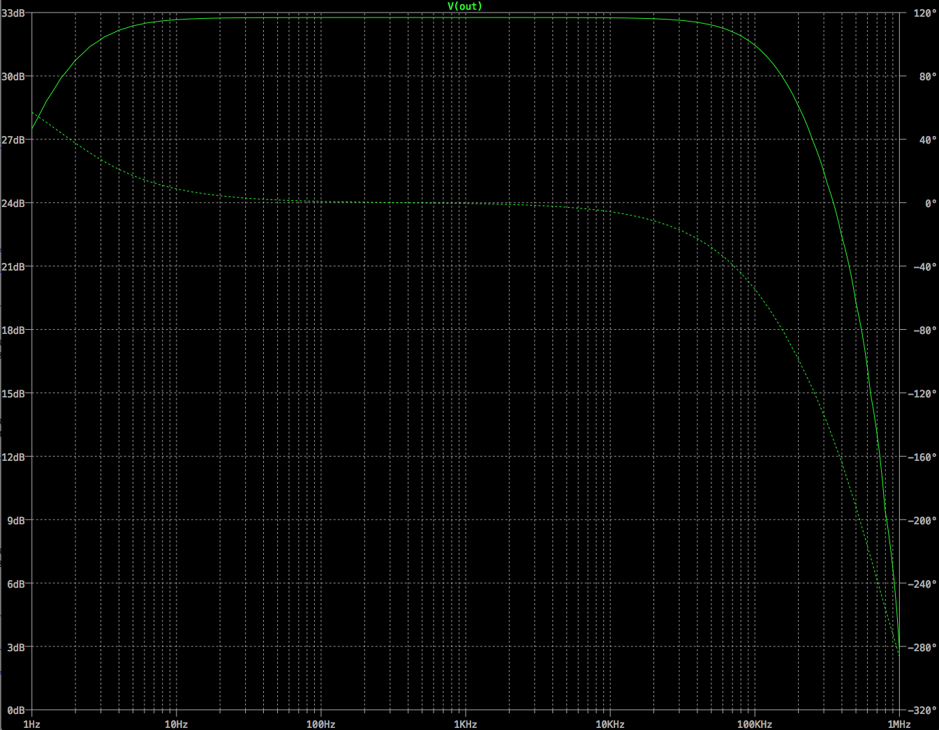

During my exploration with the tweaks, I reduced the overall gain via the global feedback, just a bit, but although the needed signal strength on the input would need to be greater to achieve full power, the THD went down to a tiny bit above 0.01%, which to me shows that by doing a little extra in the diff amp with the addition of current mirrors, we might reach a nice distortion level.
I played with the base stopper resistors on the outputs, and also the base resistors and degeneration ones on the diff amps. More simulation is needed to find out what all this did to other aspects, but so far the result seems to look nice.
I adjusted the caps on the input and the feedback for a lower high pass frequency and tweaked the high pass as well. The ac analysis now shows a rather flat response over the whole audio range, a low frequency cut off below 2Hz and the high somewhere above 160kHz.
I know the simulations are likely to be a little generous, but it looks like the result can be rather nice anyway.
What I'd like to know, is how to simulate to find out if there are any possibilities of oscillations. Is it even possible to locate and see where there could be any?
I am even thinking we could add base stoppers on the drivers, even if small values, in case there is any chance for oscillations.
However, when ingenieus did his early sims on the early versions when we were still working on the improvements, he had mentioned a phase margin of at least 50degrees, and so there were no signs of possible instabilities.
How is this simulated, to find out where we stand now, and what would happen if the current mirrors were added to the diff inputs?
If the bias spreader is changed to something safer, how would it affect it? And perhaps we could also improve the vas at the same time, which might be required to make the current mirrors work on the diff amps.
