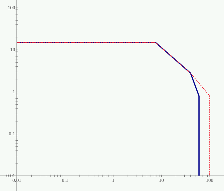

when Vce0 goes up from 70 - 80Vce to around 100 - 140Vce, what effect does that have on the Vce of the knee in the SOA curve?
Does the knee stay roughly where it was? i.e @ ~40Vce.
The location of that knee and the slope of Ic fall off, above that knee, determines the power capabilities of the amplifier with that device.

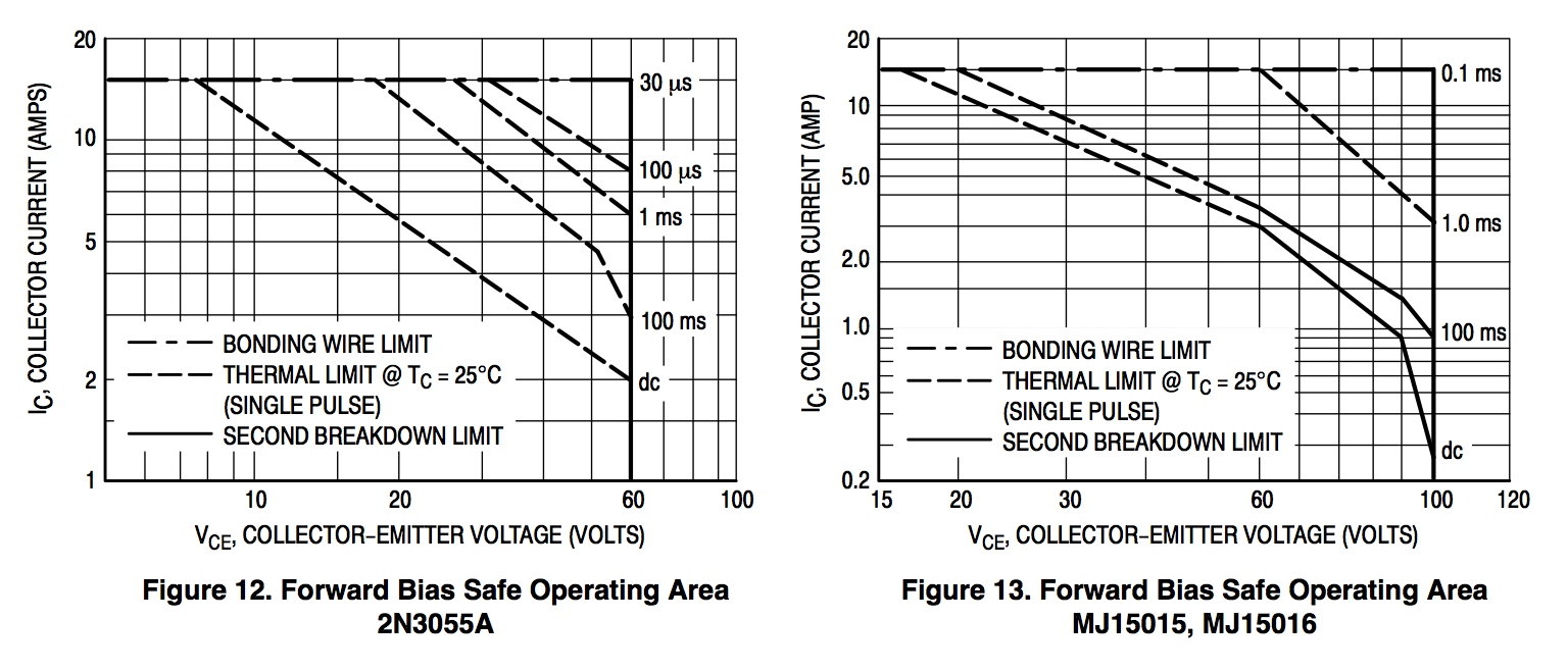

Here is a modified plot of the soa curve. I put both the original and altered curve with the Vce0 moved to 100V.
Does it look like it would go that way?
I put the curves from the onsemi datasheet as well, which has the MJ15015/16 on it. They are really representing those MJs as the actual new 3055 version. Besides the Ft, higher Vce0 at 120V and a few other parameters, how different are they?
Is it alright to simply move the curve to 100V that way? It does move the knee...

I am inclined to not believe either would apply to a 3055.
I don't have manufacturer's data that shows the knee moving up with an increase in Vce0.
I suspect the knee does not move.
I don't have manufacturer's data for the slope after the knee for the higher Vce0 devices.
I suspect the slope is the same as for the lower Vce0 devices.
If my suspicions are true, then that makes your composite SOA unbelievable.
The SOA at the knee and at the 60Vce should remain the same. The (Power) SOA @ 100Vce, or 140Vce, is very likely to be MUCH lower than @ 60Vce. Maybe 0.1A @ 100Vce giving 1W @ 100Vce and maybe 50mA @ 140Vce giving 0.7W @ 140Vce
Both very different from your guess of 10W @ 100Vce.
Even the standard can only manage 6W @ 60Vce.

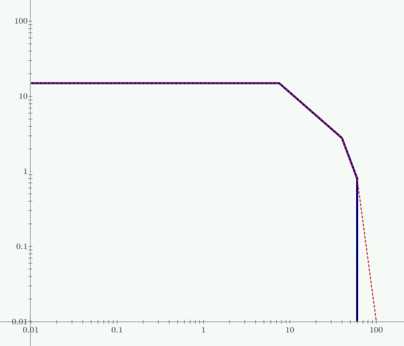

Ok, how about this one then?
You KNOW it doesn't move. Look at the SOA curves for the TIP41/A/B/C. Vceo increases with grade, but the s/b breakpoint is in exactly the same place. Real world devices can be much higher tha 100V, but they guarantee the C grade at 100V, andthe A at only 60. The grading is based on sample testing and statistical confidence limits.
Even the s/b limits for power transistors are based on sample testing and statistical confidence limits. It may handle more power, but they won't sign up to a spec saying it will. You can verify Vceo with a simple non destructive test on any unit you wish to test. You can verify if a unit will pass an SOA spec with a simple non destructive test. But you can't find out where it dies without killing it. Then you can't use it.
