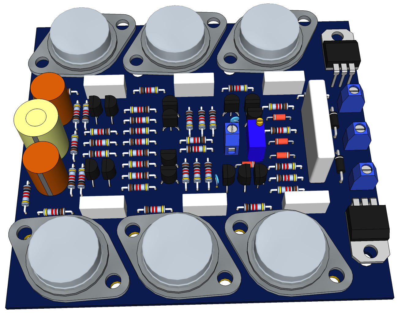

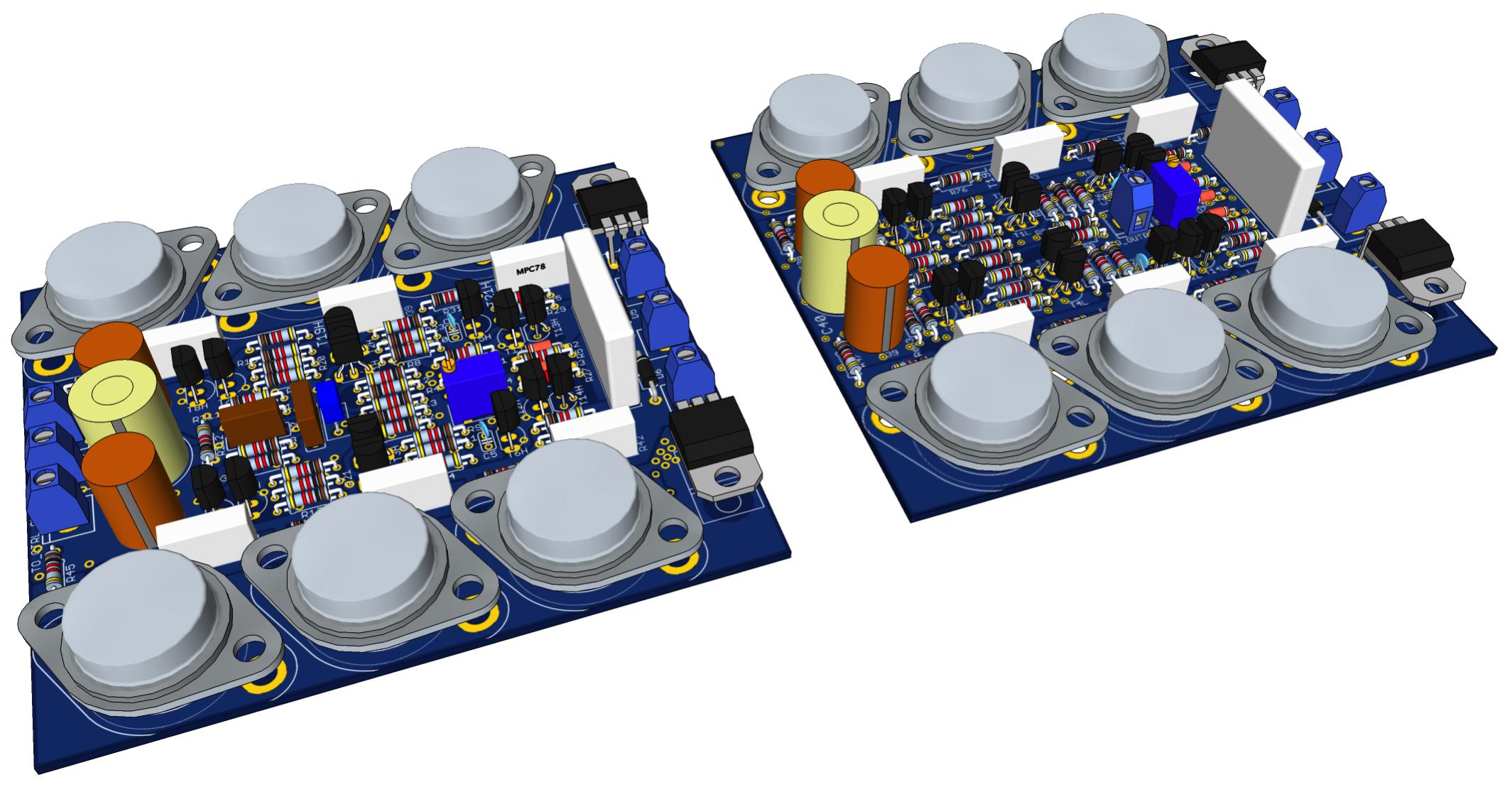

Amplifier based on 2N3055
The low side amp board in 3D.
I don't have the high side for now, some bugs in sketchup and eagleup are making it difficult.

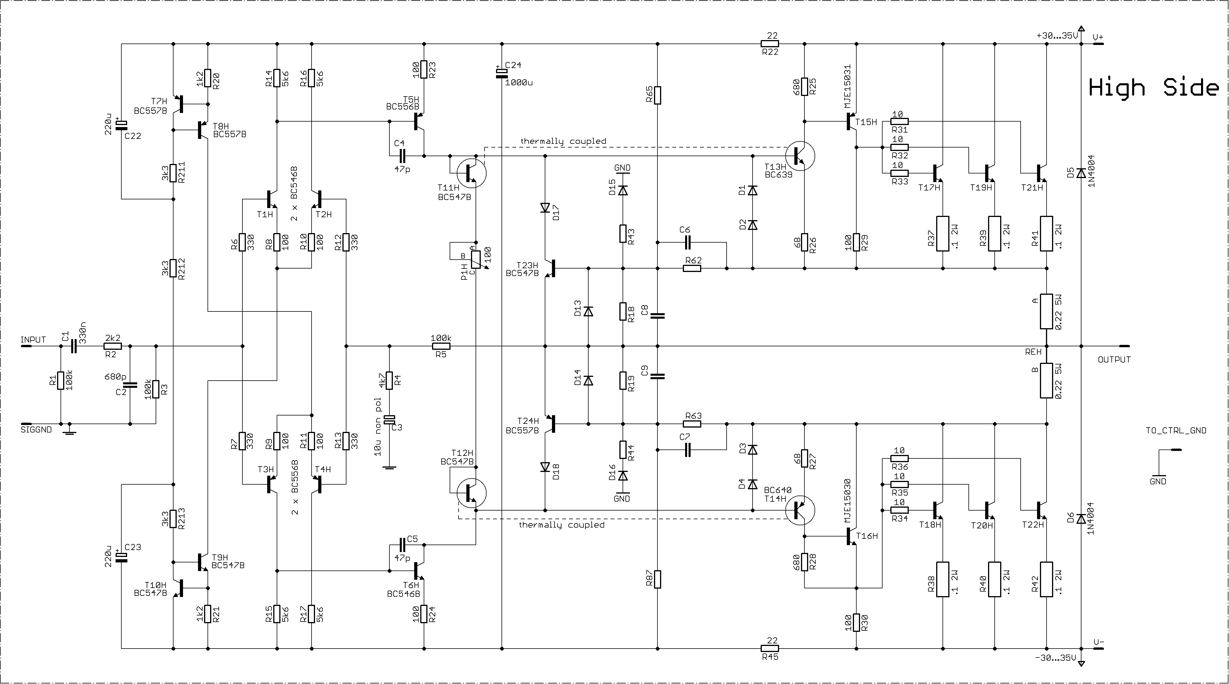

I am now considering the addition of the protection circuitry, as a VI limiter if we can get this to work right. I would hate to use a protection that operates on legit signals and within the normal range, so this must not be acting below clipping.
To be able to get the max out of the outputs soa, the VI protection should work better.
And on that note, I was giving some thoughts about the relation between high and low side, since the low always follows the high, then I don't think the low side needs those protection circuits, does it?

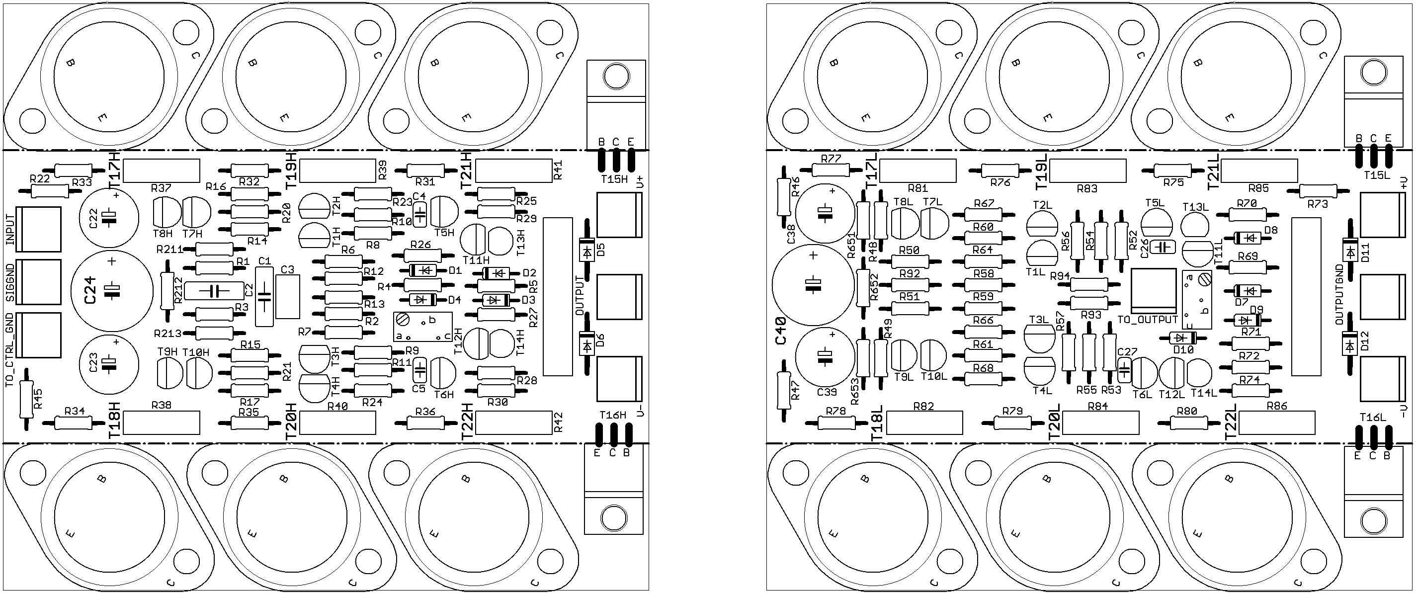

Adding this, no matter how small of an increase in the number of parts, it will require more space, so I'm going to widen the size to 110mm, so the board would be 110x110 instead of 100x110.
Here is a VI limiting protection circuitry added to the high side.
No calculations are done yet and that circuit is the standard basic one that is VI and not only I limiting.
There is the question of the R43-D15 and R44-D16 tied to gnd that I'm wondering about. This is a good thing on a standard topo with fixed ground in regards to the rails, but in this case with the ground floating around, is this an issue or not???
I think the use of D13 & D14 is warranted, as they protect T23/24.
The C8/9 caps are just there to prevent action on fast transients.
And finally C6/7 would only be there for stability, for oscillation prevention on those trannies.
Having this quasi topo with only a common resistor from each outputs group going to the speaker output bus is simple (only one sensing resistor needed).
If the input for the low side is fed from the high side's output, the low side will continue to provide the proper "ground" and split the rail voltage even when the VI limiter is activated. This is why you don't want/need a limiter on the low side. There are also several other VI limiter types that do not need a ground reference (it references the opposite rail). But this one is relatively easy to calculate and it works.
YES! I just now realized this as you explain this. Since the limiter would only activate on output short, then the high side output is then basically at ground level, which does split the rails even around the ground.
Make sense now.
Agreed, not remains proper calculations to be made, in regards to the soas...
btw: is my implementation all correct?
Implementation looks fine. Now we all get to argue about how lax/consevative the SOA protection needs to be....
Yea!!! Let's start arguin' 😛😛😛
Not being certain I had plotted my load lines right on the soa chart, I can't be certain about how comfortable we are within that soa. But if it's correct, or close to it, then we seem quite comfy there, with room to spare on the 2 ohms load. And if that is the case, then the protection should be set well above the clipping or any "normal" transient operation.

Could I have your postal address please ? Tomorrow (Monday) I am planning
to visit the post office for everybody else interested in the PCB.
I was wondering if that board would be easily modified for the purpose of making the grounded bridge. Our schematic has been evolving and the main amp has changed quite a bit and the low side even more. We've come fairly far from the original design and I wonder how this board could be adapted to handle this.
Plus it takes 2 boards to make the bridge, and they're not "configured" the same.
What do you think?

I am pondering the protection of T5 & T6 (high side) when the output is shorted and the protection is acting.
Although the drivers and outputs have their drive removed, the outputs on the pre-drivers get sent to the output, so they see that short almost directly. Now I'm guessing that with the high side output shorted, to ground, which is the low side's output, the reaction of that low side would be to bring the ground at the middle point, and freeze it there. Am I right or not?
The we would have for example T23 pulling hard on T5's collector towards that output shorted to ground.
Perhaps with the amp's input still driven at the max, let's say to the point to want to make the amp clip. Then T23 would probably win in regards to T5 to bring that driving signal coming from T5's collector down. So, then we would have not far from V+ across T5 as Vce (minus the drop on R23, D17 and T23's Vcesat).
With driving current coming from the input diff stage, trying to saturate T5, and the Vce that would resist coming down, I'm thinking the dissipation in T5 would be too great for it. Doesn't this require some attention? Do we need to add one more trans on each pre-driver to protect them?
You can add additional protection for the VAS if you want. As it is now, you'll get about 22mA through it if you activate the VI limiter into a short. If this is on half the time, it's probably tolerable. With a diff pair input this stage's current is limited by what you get when the diff pair is steered all the way to one side. If your input stage topology can go into class B in normal operation (ie, opamps, CFA's), then you've got to worry about how hard the VAS can be driven in overload.
If it was on all the time, then we would be at the limits of dissipation, but perhaps half the time is ok then. So we'll just leave it as it is now.
However when this amp is going to be used with 3773s instead of the 3055s and the rails increase, then it might be a good idea to protect those, or perhaps use beefier ones.

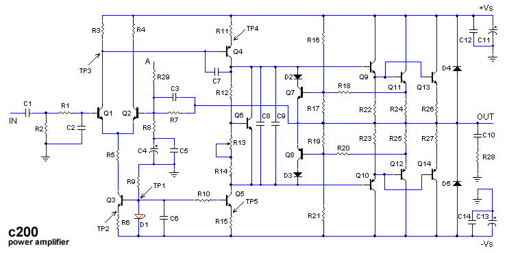

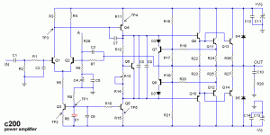

"Would you have a higher resolution of that schematic sheet? "
Sorry, no.
That is the only copy of the Hadley that I have come across. I used it as the basis of the complementary design I posted below it. The new one should be clear enough to show how it works. I think Bongiorno worked for Hadley about that time frame, and I know Nelson Pass was aware of it.
