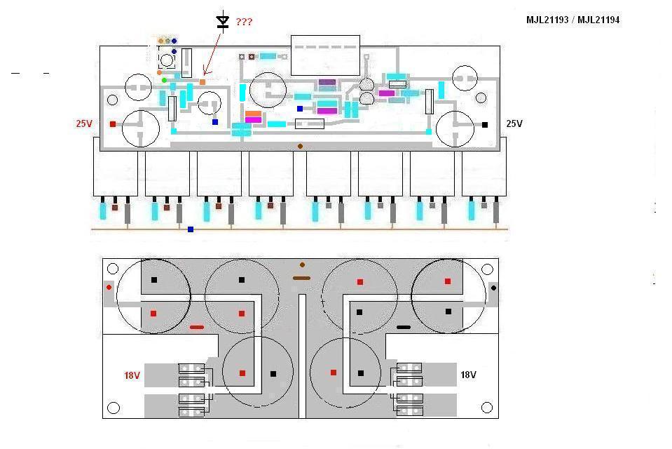

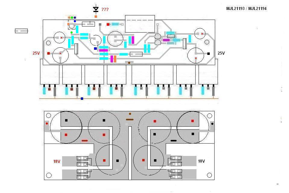

Corrected a few mistakes and hopefully better now
I had feedback from ground, instead of output, oh boy
There may still be errors tho
changes changes changes

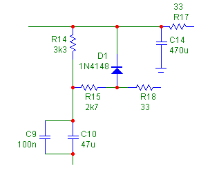

Any comments to the diode, marked with red arrow ?
Also, should the bootstrap cap optimally connect directly to output
No series resistor or anything ?
