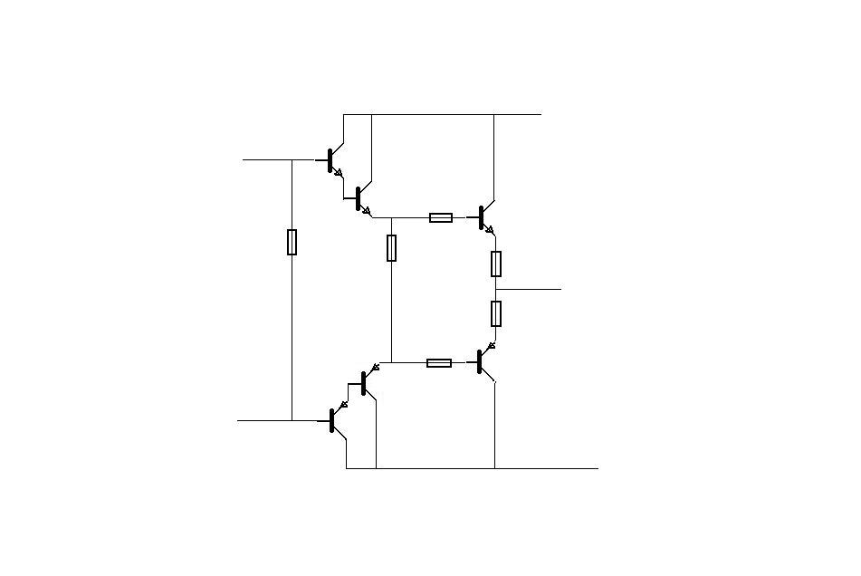

Hi, I wonder, is this a cascode driver stage ?
A little more than a darlington, it s a triple emitter follower.
Since there s no resistors on the emitter s of
the transistors that are in the middle of the arrangement,
the crossconduction range around the 0V crossing point
will be somewhat wider..
Also, the lack of this resistors make it imposible to discharge
the stored charges if even the transistor is driven to saturation,
wich is not a poblem in this case as they are fed from the same
supply voltage that their drivers, so they can t be driven to saturation.
A cascode generally has the emitter of one device connected to the collector of a second, whereas in your first circuit the emitter connects into the base of the second.
Of course you can build the circuit with FETs, where it's source->drain, or valves, where it's cathode->anode.
Just because you see the devices stacked in this way, it does not necessarily mean that the circuit is a cascode.
As with most circuits, it's worth googling them and looking at wikipedia... cascodes are characterised by a high input impedance and high frequency response, the latter due to the minimisation of the effect of Miller capacitance.

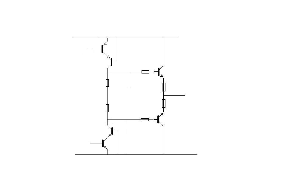

Thanks, maybe this is closer
I have no idea why a PNP drives NPN
But seems to be normal that way
There something wrong with that cct. The second transistor on the bottom is wrong (its always off). Its base voltage needs to be raised up at least 2 volts. What this does is keep the Vce and the load of the trans. before it constant.
Look at common base configurations. The cascode can be looked at as a 2 stage amp, common emitter feeding a common base.

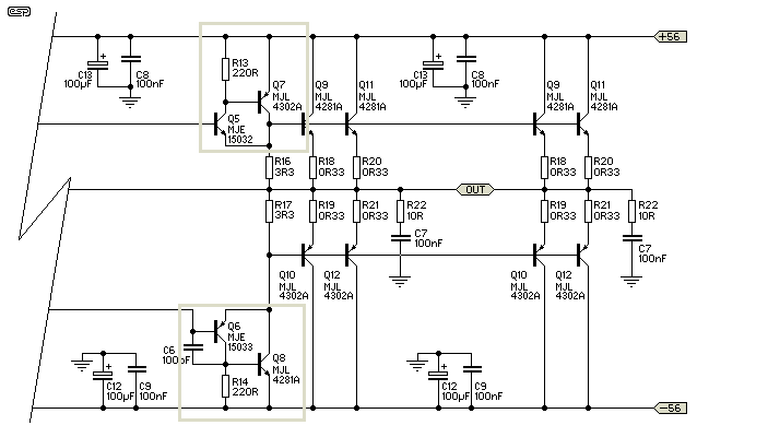

I have 8 pairs of MJL21193/94
Maybe I wanted to use them in a Dx
Maybe with a cascoded driver stage, but seems impossible
But would be easier to just use a tougher driver
But as someone said, it will blow up in my face
I give up, and will look in a different direction

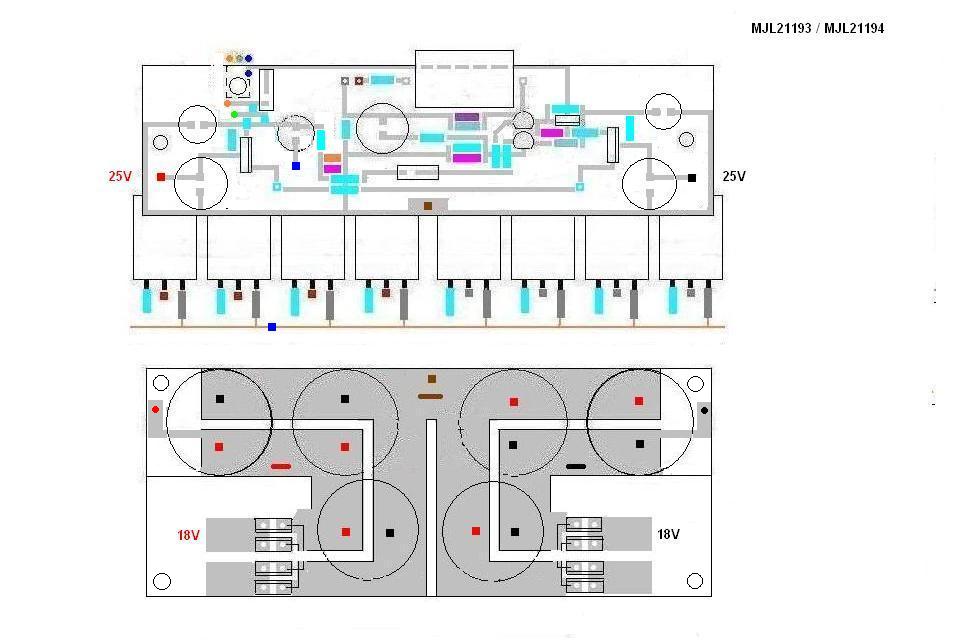

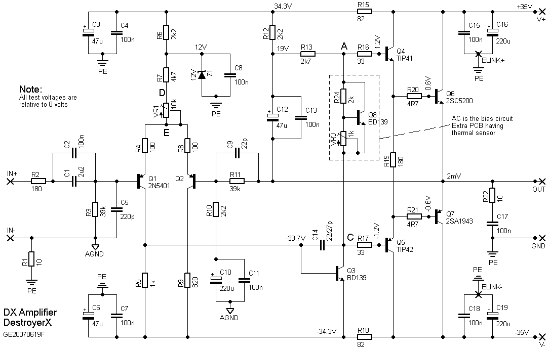

Ahh :idea: I could just use the "standard" board to drive the 4 output pairs, at low +/-25Vdc, it would drive 1ohm ribbons without sweat
Im building ribbon tweeters right now, so it would be a convenient amp to have 🙄
I have all the output pairs, and a couple of heatsinks
And trafos would fit F5, if it doesnt work 😀

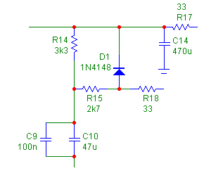

Ah, maybe I will figure out this bootstrap diode, suggested by BV :scratch2:
Not sure why I connected bootstrap to ground, obviously a mistake, and should be connected to output
Corrected and hopefully better now
Probably more mistakes to find
