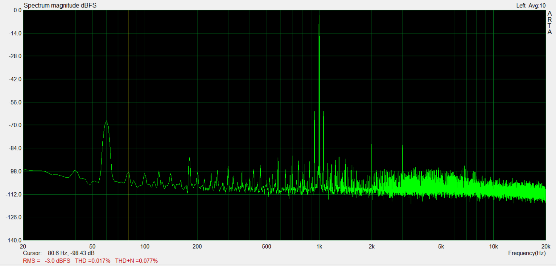

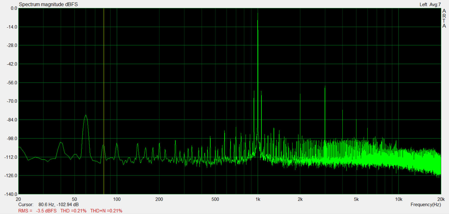

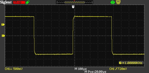

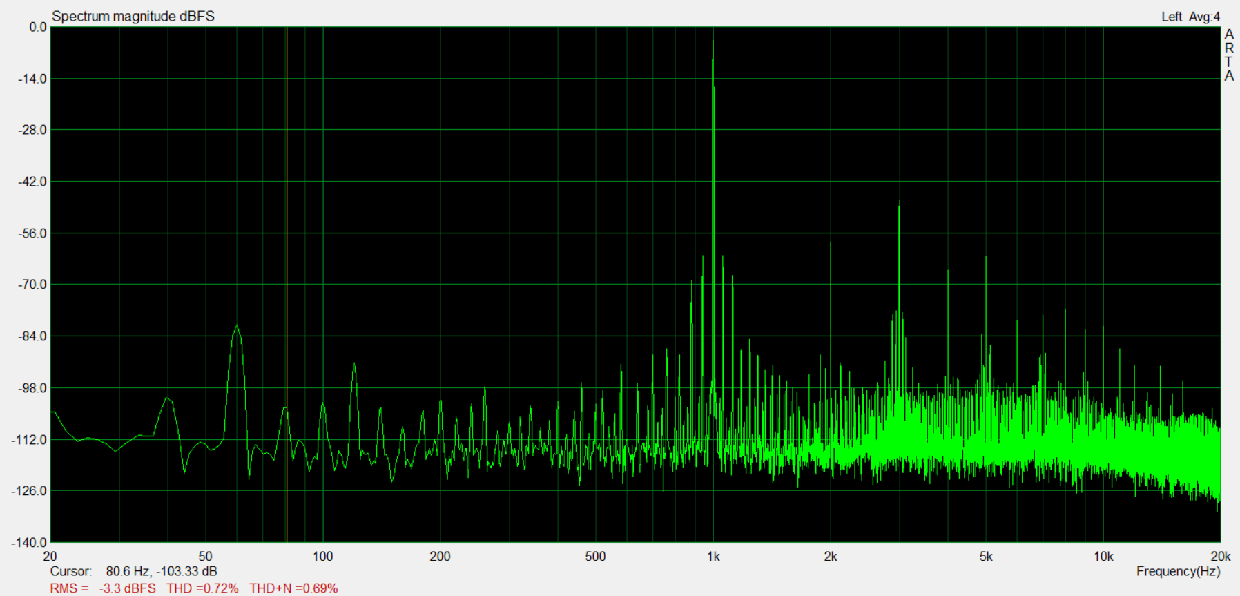

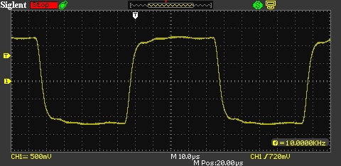

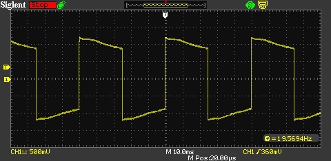

I just got this amplifier back from my brother for a repair and so will be taking comprehensive measurements in the near future. My measurement setup is much better now than it was when I originally did this. The repair is complete so here are the first measurements:
Zout @ output tube bias current:
3.6 Ohms @ 50mA
3.3 Ohms @ 60mA
3.1 Ohms @ 70mA
Overall, Zout is probably in the ballpark I would expect. I think Pete Millet's 300B amp was somewhere near this. It is difficult to go much lower than this on an open-loop amp. For comparison, my open-loop Unity-Coupled amp achieves a Zout of 1.1 Ohms at 50mA with about the same supply voltage and a little higher turns ratio in the output transformer.
I also measured the DCRs of the Hammond 1650R output transformers and the primarly was a little less than 100 Ohms and the secondary is 0.20 Ohms (configured for 8 Ohm operation). I am impressed with the low copper losses of the 1650R. If I were doing this amp again I would build it as a cathode follower amp. :devilr:

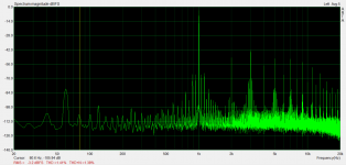

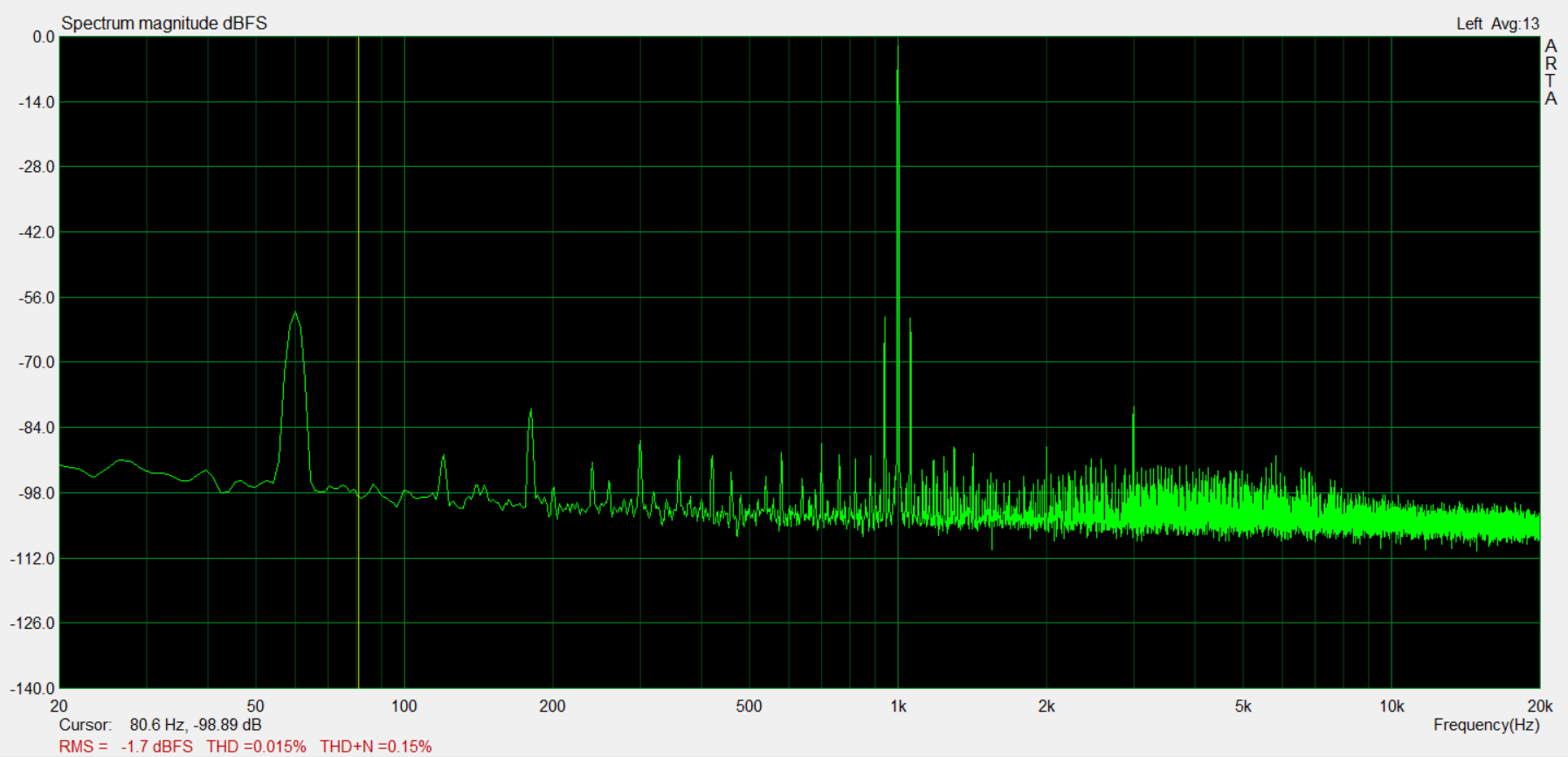

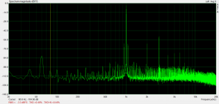

I plan on running a series of distortion measurements at various power levels and various output tube bias currents after I install a bias servo board into this amp. Stay tuned.

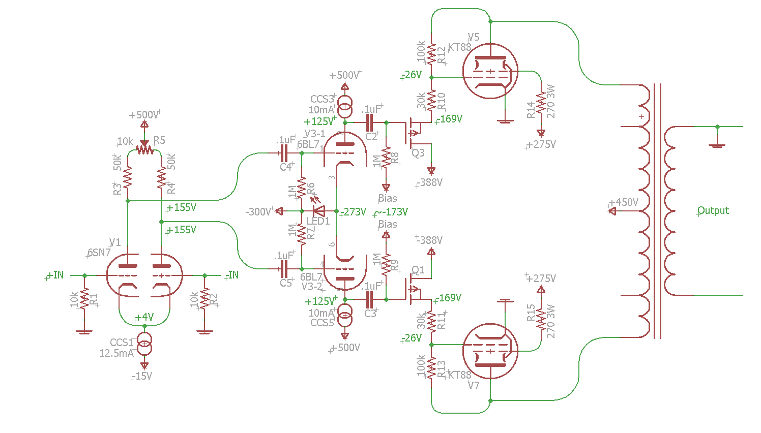

I have updated the amp a bit. Schematic is attached. I modified for a balanced input and changed the feedback ratio from 20% to 30% in the output stage. I also reduced the current in the feedback divider since I don't think 10mA was really necessary. Output stage effective mu is now ~3.3, a little bit lower than a 300V.
Zout @ output tube bias current with new feedback ratio:
2.9 Ohms @ 50mA
2.4 Ohms @ 60mA
2.2 Ohms @ 70mA
