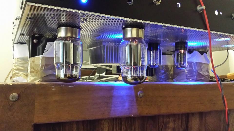

I like the use of the heavy perf for the top plate. Great ventilation and freedom to mount boards pretty well anywhere . . . .

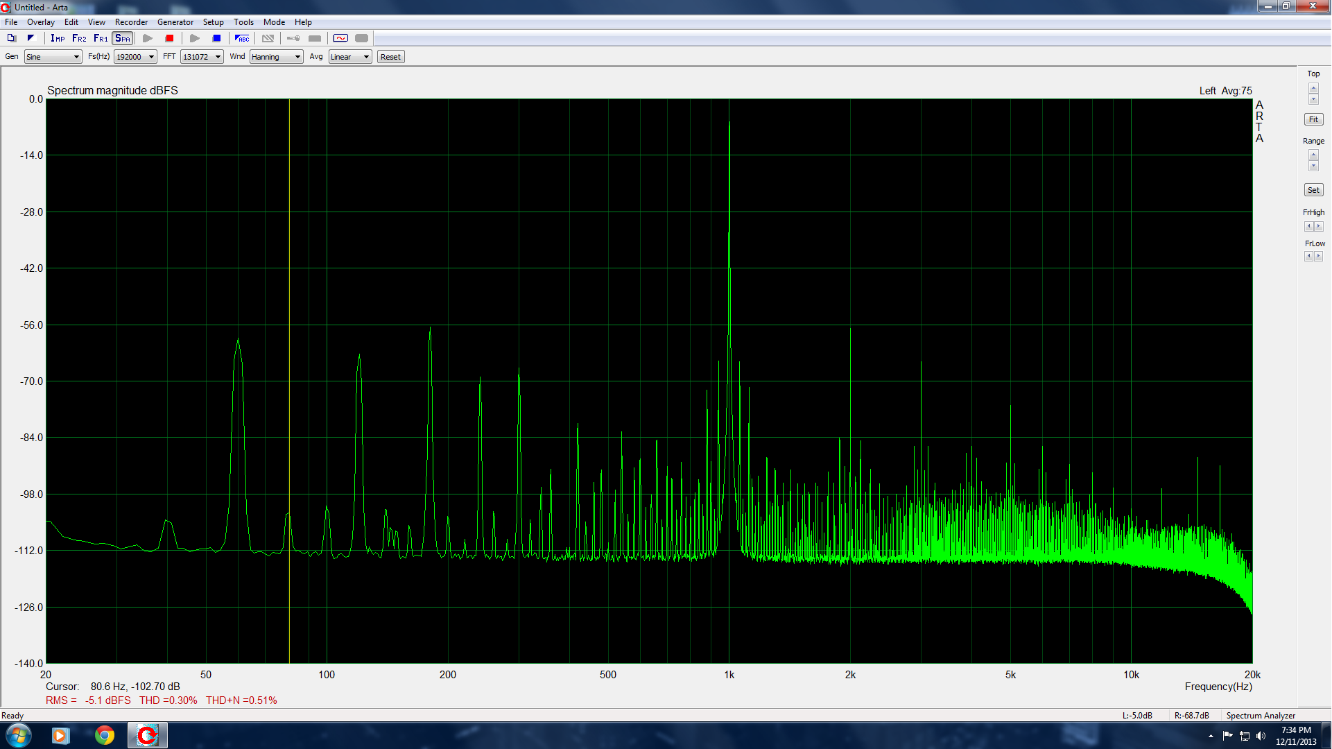

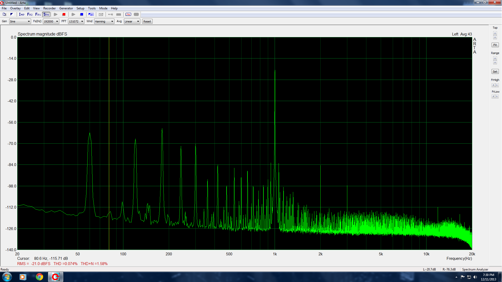

Looking at the graphs I have a question. Are the peaks at the bottom end 60, 120 etc. from the test gear power supply ? I see that they don't move much with power output but otherwise I don't know how to interpret them.
I'm planning and getting parts together to build a 6BX7 or BL7 > 6336 differential amp and lately, looking for ideas and details, I've been reading threads you've posted on but this is the first time I've seen one of your creations. Thanks for sharing it!
I'm not sure. I was really rushed when I took these measurements as I was trying to get this done before Christmas so I could deliver the present. I would have liked to get to the bottom of it. I would like to say that it was not the amp, but I used some 800uF caps for the power supplies that I had laying around and I fear that may have been on the large size and some of the large charging current surges may be coupling. 60Hz is hard to explain, though. I don't know. I would have liked to play some more with it to get to the bottom of that but didn't have any time. Also, the amp had a buzzing that I could only hear with my ear about an inch from the speaker cone. I was hoping it would be totally silent with no signal, but some of that is getting out.

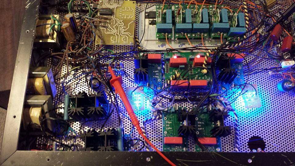

What are all the PCB's? I recognize your maida regulator boards. I'm guessing the ones w/ the single heat sinks are the CCS's.. What are the PCB's w/ the red caps and no heat sinks? And the ones w/ two heat sinks each? And what is the DIP ic in the back?
I made a board for the input stage, a board for the driver CCS (cascode depletion-mode fets) and a board for the output stage. The output stage board includes the p-channel fet and an n-channel fet source follower regulator for the output tube screen with a current-limit. The screen voltage will sag if the tube is driven into the screen-current danger zone:cool:.
