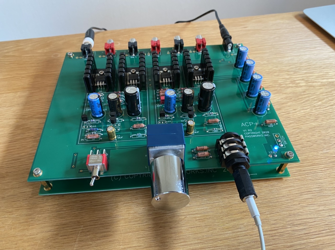

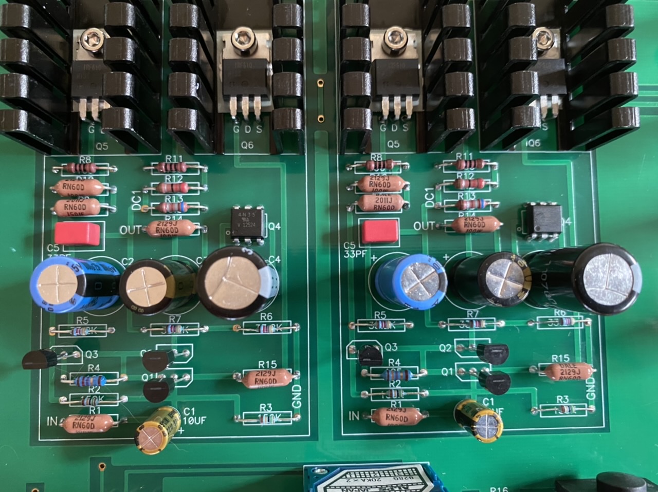

It’s alive. Drops across R18, R15, R11 as expected. DC/gnd at approx 10v7. 10.29 and 10.31 mA through the 113s, a tad higher than jig (0.3mA). I hope happy days.
Porn to follow tomorrow. The cheap kind, and probably not arousing even for solderofiles. And then a listen. If I can find some headphones 🙂
Andy
Andy
Ready for listening

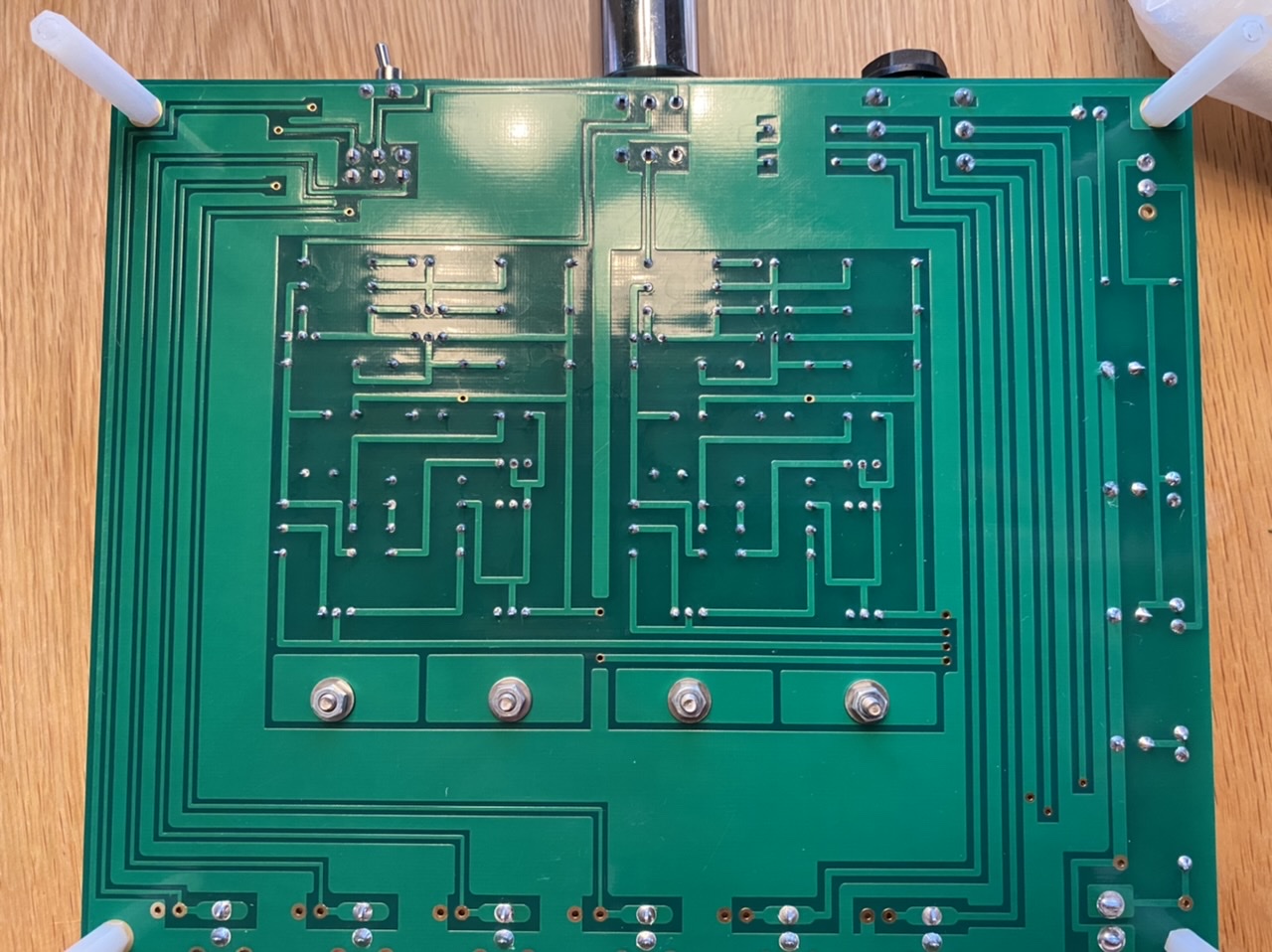

Following up with a few pics. Managed to sqeeze in the final mounting this morning.
Very happy with almost everything, but as always I have a few things that I know may be improved. But good enough it seems, measures fine voltage and current-wise. Tested with some terrible apple earplugs, and sounds promising. But something else is required to really hear what this baby is good for.
This project I tried to do some things for the first time. As reported earlier, I matched J113s and resistor pairs, and that turned out to work. Really happy with that. I used the same jig / breadboard to pair J74s, also a first for me. Baby steps.
Thanks to Mr. Pass, ZM and many others!
3rd project done, ready for more when time allows

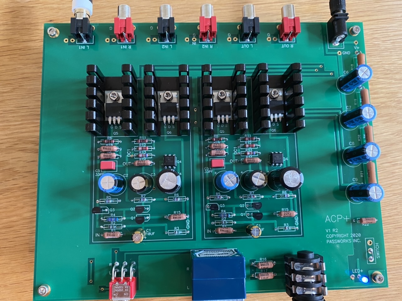

Andy glad u found Bens post and pix.
Great....its an easy mod...and I use the ACP+ with my HD 650's...excellent results.
For 300 Ohm headphone, add a 36 Ohm resistor at the two positions shown in my picture and change R16 and R17 to 300 Ohm.
2 - 36 ohm
2- 300 ohm
Alex
2 - 36 ohm
2- 300 ohm
Alex
