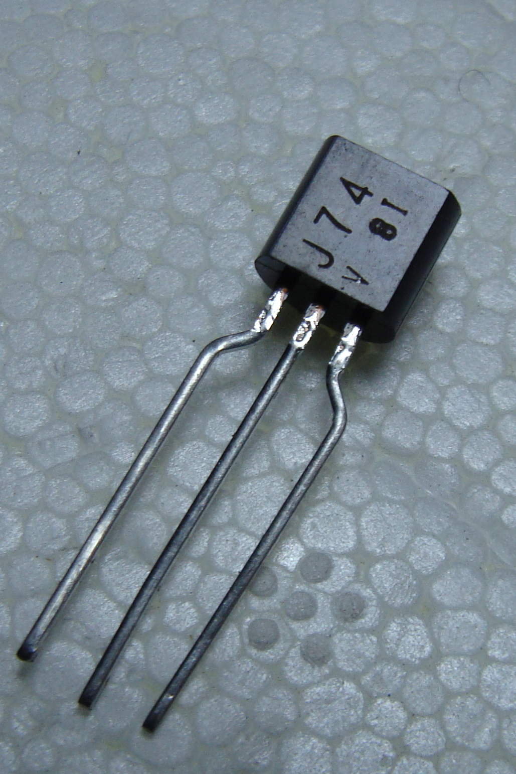

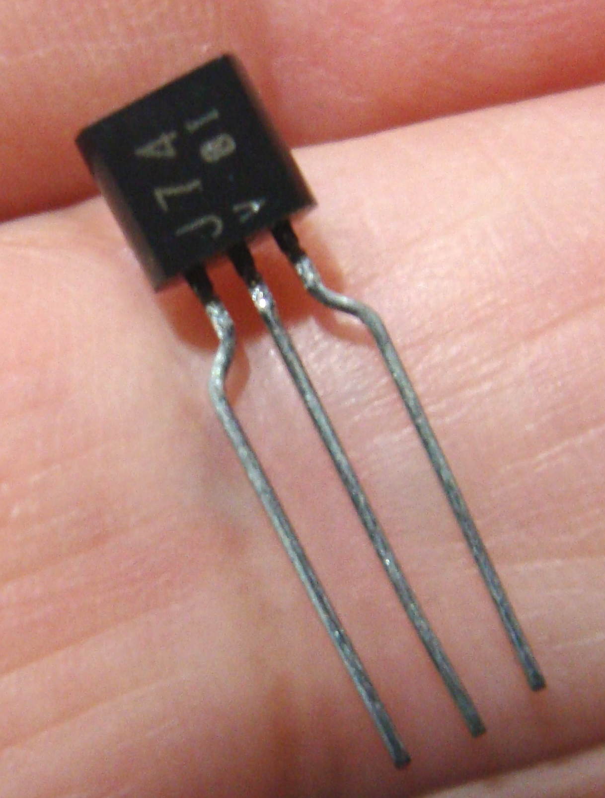

I bought four 2sj74 from a member of this forum. They have all the physical characteristics of the original fet. However, when testing on a multitester, I verified that it has the source on terminal 1, the gate on 2 and the drain on 3, contrary to what is reported in the datasheet. Where did I go wrong? Or does the multitester have some error? Or is the fet not original?
I had the same problem with that tester. Flip the orentation of the Jfet and test again. You will get the same result. It's the tester. Go by the data sheet
Or drop the tester and make a simple breadboard jig, test with battery or PSU. I found a lab PSU with current limiter for approx 100 dollars, best investment ever.
There is noting really wrong with the tester except the lead identification. It is my understanding that Jfets can be built physically in such a way that the source and drain are interchangeable. I don't know if the K74's are built this way.
Too right, to quote papa from link earlier today:
«Most of the little Jfets l play with, like 2SK170 / 2SJ74, are symmetric, and
you can switch Drain and Source and they work fine, even identically.»
I guess testers are useful for a bunch of reasons. But for matching and jigging / J113+resistor matching, I found the breadboard solution fast, cheap and easy, for starters at least 🙂

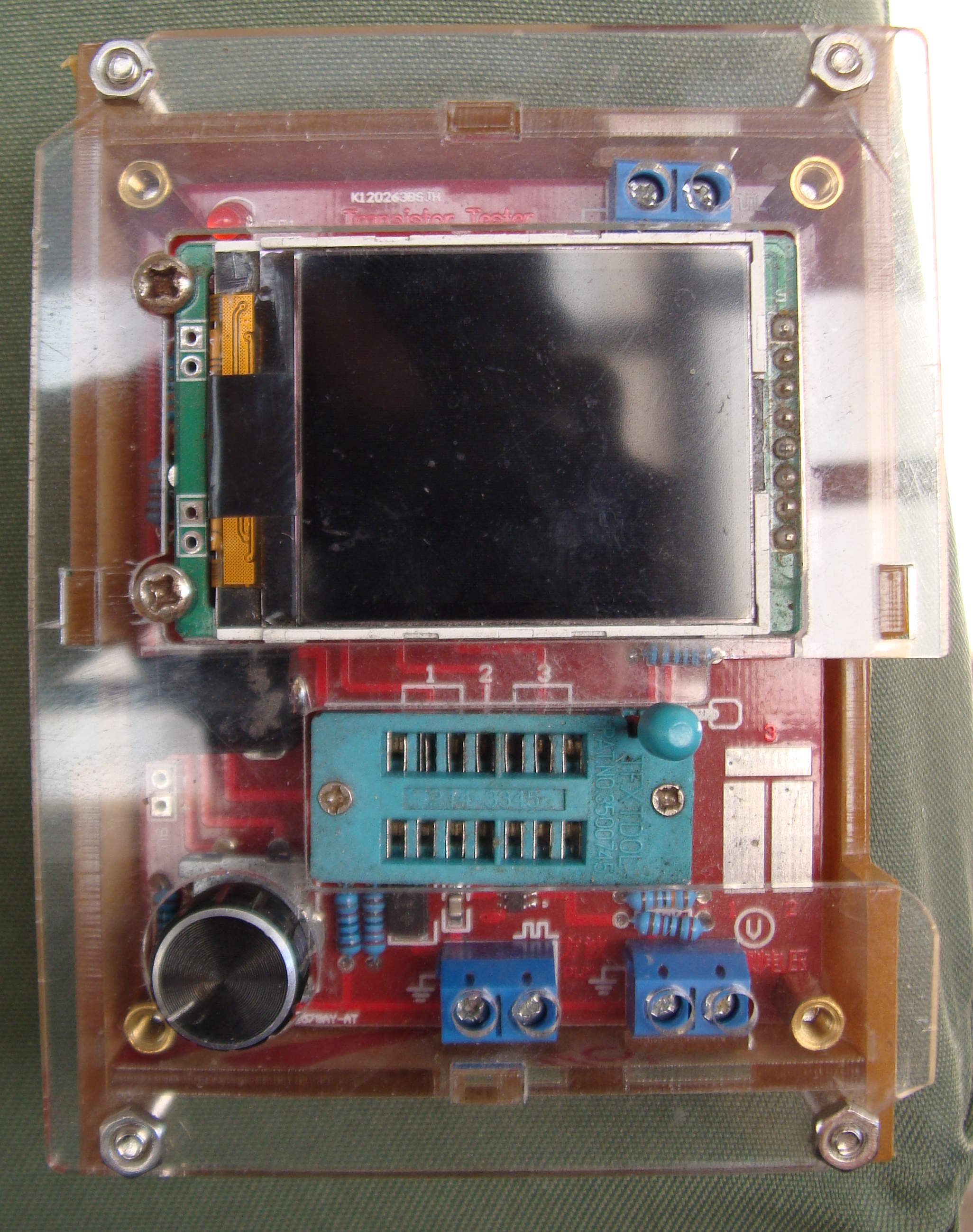

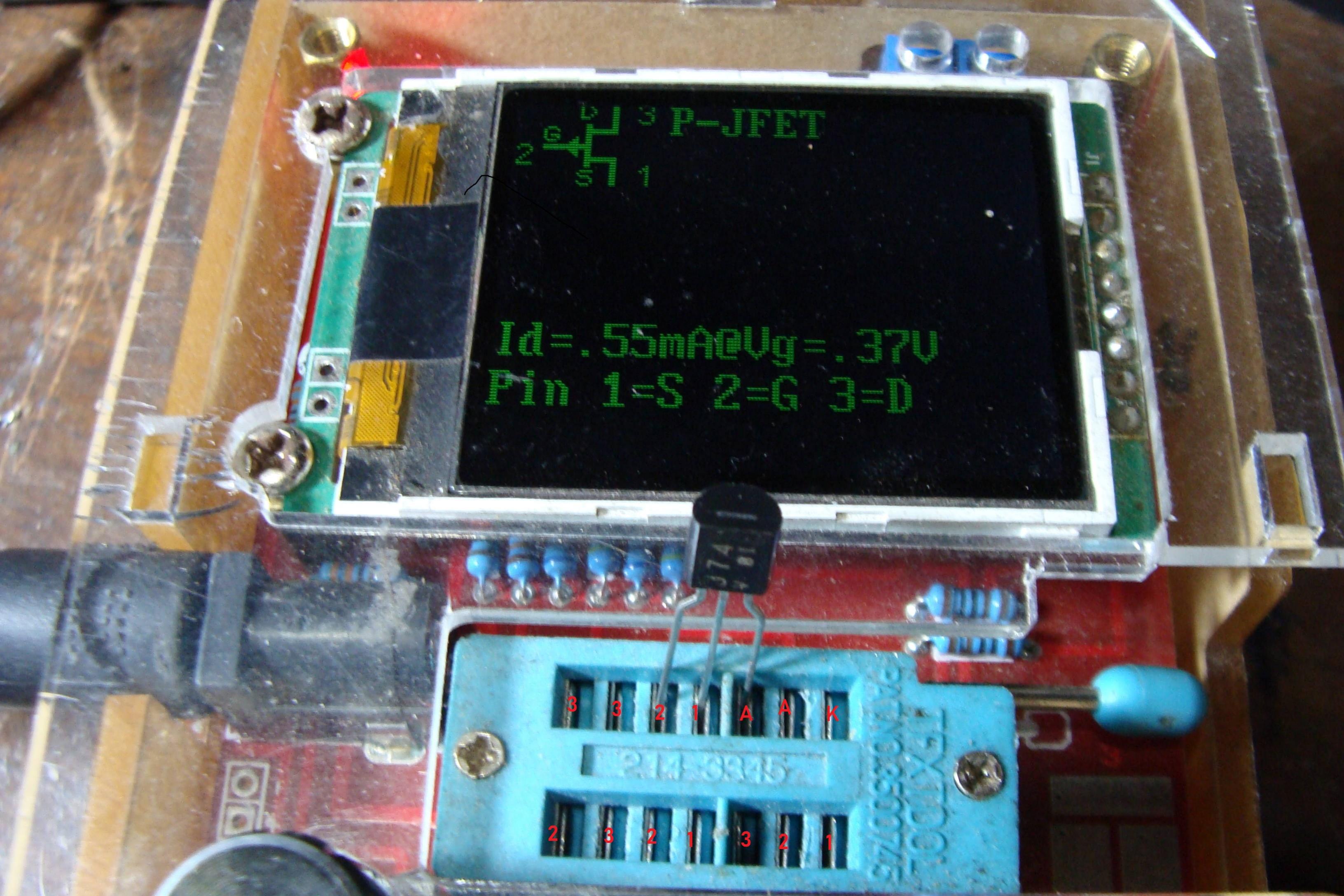

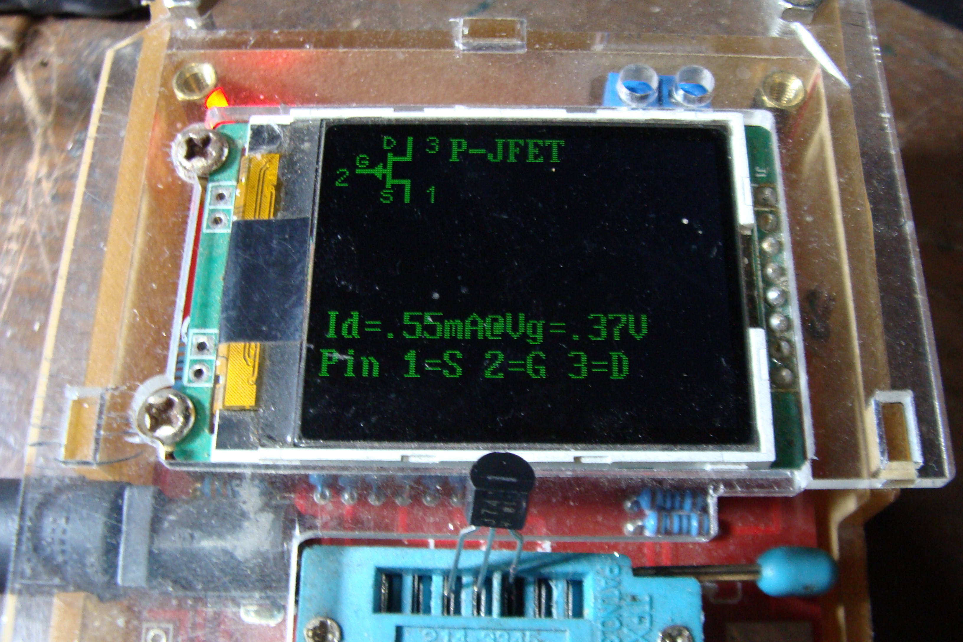

I marked up the picture with the terminal numbers as shown on my tester:
This is my tester. At the bottom the indications where the terminals must be inserted.
It's the most likely hypothesis. When I invert the terminals, the result is the same. I have never seen reports of 2sj74 forgeries so perfect. The person who sold me has a 100% positive rating. I also measured the resistance between drain and source and found 25 ohms, within the normal range.
