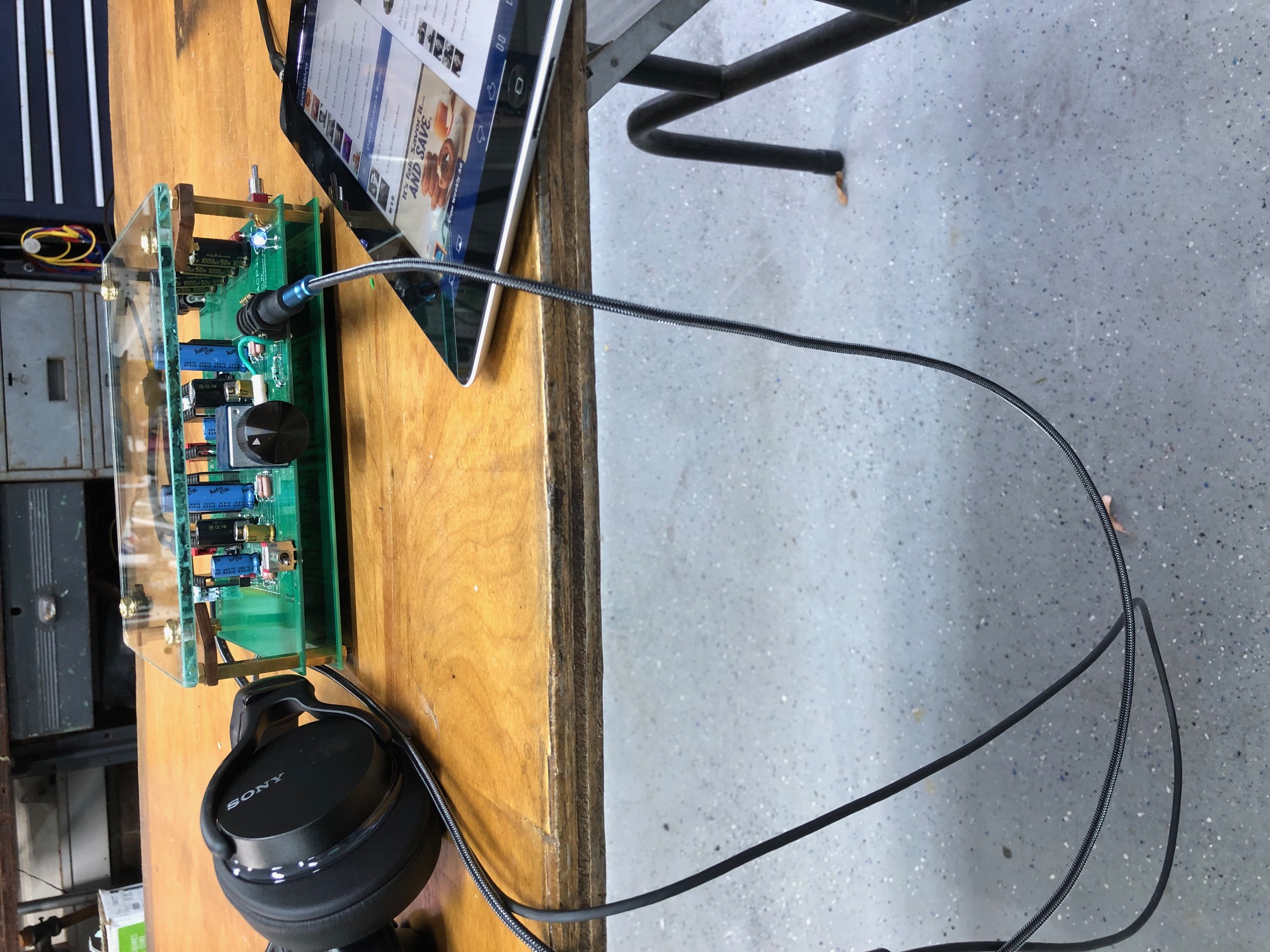

I finished my basic ACP+ (no ground plane bottom, no other embellishments) a few weeks ago and it has functioned way beyond my expectations both as a headphone amp and a preamp for my Sony P-channel Vfet amp. It works so well that I could not stop listening long enough to put a bottom and glass top on it...
Well, three days ago I finally broke down and moved the ACP+ out of the house and into the garage for its "dressing" session.
I had the brass 1/4" x 1/4" channel as well as a piece of 1/4" glass -- I just needed to get the glass cut and holes drilled & come up with a way to attach the glass to the ACP+. Unfortunately, the glass shop could not drill the holes close to the edge where they needed to be to match the holes in the circuit board. So I told the glass shop to drill the holes as close to the edge as they could and I'd figure something out. That turned out to be some scrap pieces of mahogany that I had in the scrap pile and some brass machine screws and washers and a 12" piece of 6/32" brass threaded rod.
The only "mechanical interference" issue was the power on switch -- it was right in the way of the brass channel on the front right of the amp. So after a bit of head scratching and junk bin digging, I found a solder in switch that fit the board and hung off the side of the amp. Not pretty but functional and I did not have to re-engineer the standoff on that side of the board just to clear the switch.
I think this will do nicely in a minimalist sort of way...
