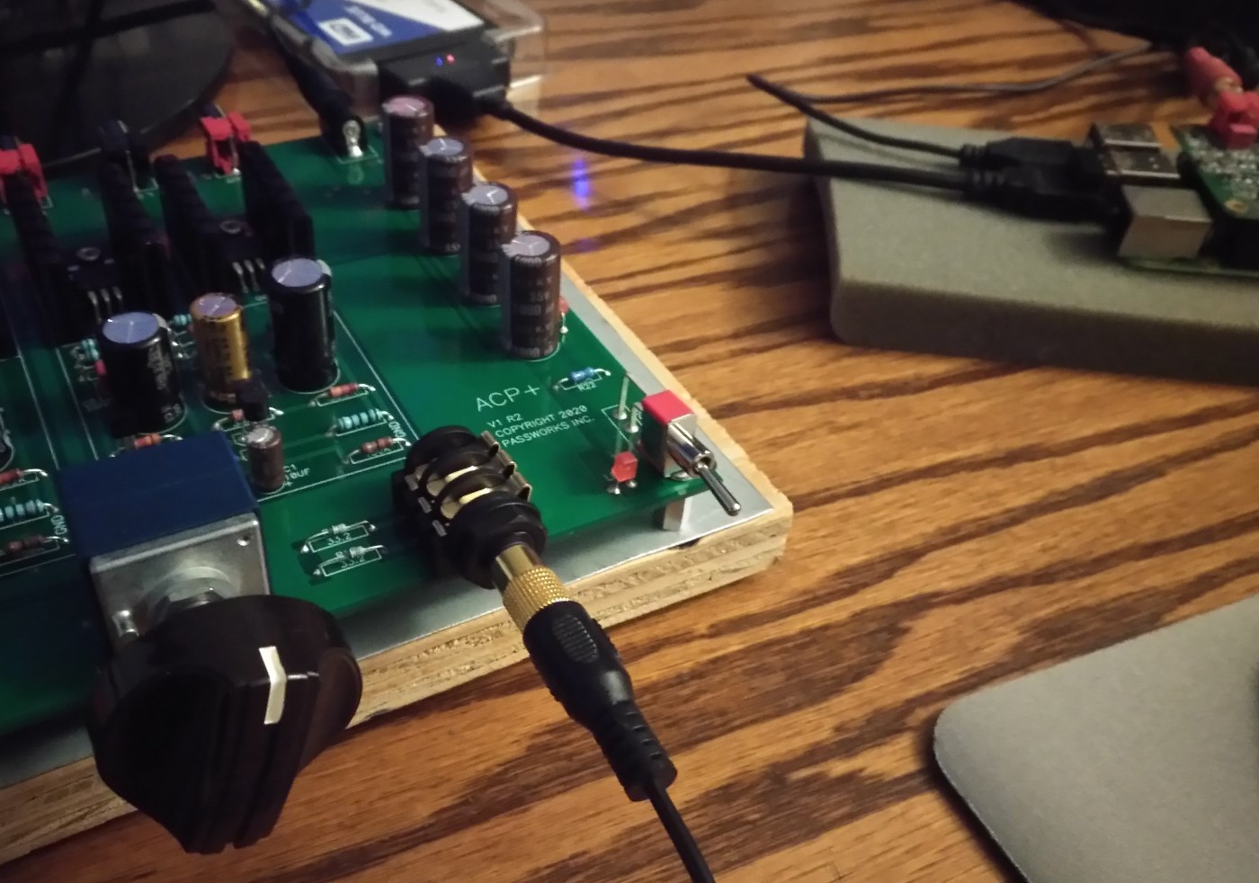

We need an updated R1V2 power supply schematic - it's not the same as shown in Firstwatt ACP+ article.
Here's a clue. When I jumpered between R19 and R20 it bypassed the power switch! Now always on no matter what the position of the switch and the cute blue LED doesn't light.
Tom, Those are great clues. Perhaps your switch is not mounted correctly. Since the switch has a built in LED, perhaps it has a built in voltage dropping resistor to drop the voltage to 5V. .
Maybe if you remount your switch rotated 180 degrees, you will get the switch working properly, but the then LED will not work. If that is the case you can probably attach the third pin of the switch to a point in the power supply to power the LED. Then you can remove the jumper.
That is my guess anyways.
Ben I think you are on to something. I am going to leave it as is for a few days until the new J113's arrive and then explore further.
I did verify that the switching function is between the two red wires. I had wired it in the pin block with black to Ground, one red wire to V+, and the other to the third "dead?" position.
Apparently in the new R1V2 scheme C6-R18-C7-R19 always see the power supply. Switching on sends current to the left channel C8-R20, or right channel C9-R21.
The two functioning switch wires should go to the "live" positions (V+ and Ground) and the non-switch wire should go to the "dead" position. The non-switch wire is probably the power wire for the LED. You can take a wire from a switched power component (R20 or R21) to the non-switch wire to power the LED.

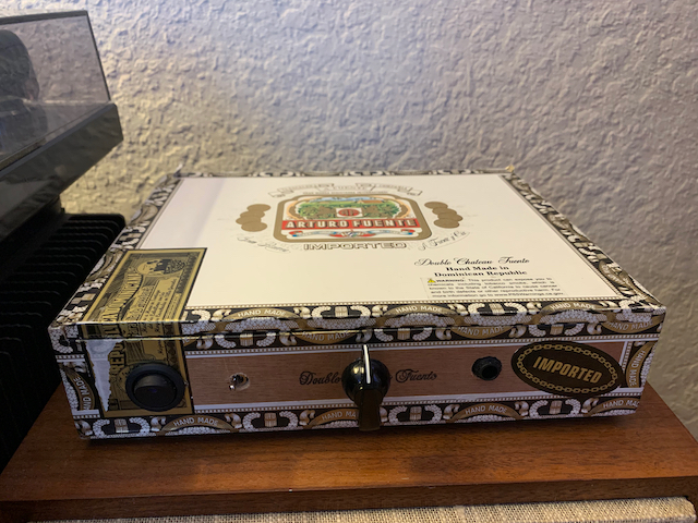

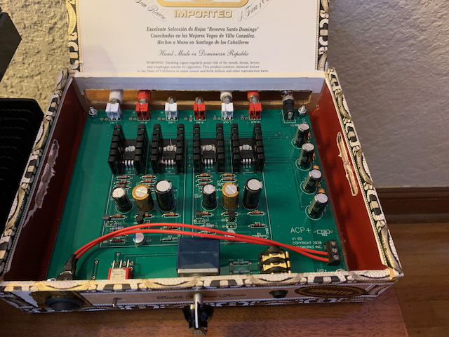

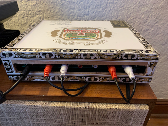

It's Done!
And loaded into it's cigar box case. Some Mozart is playing thru the F6 to the Dynanco/Seas A26 speakers.
I cut the hole for the power switch too low, and the back of switch interfered with board, so some surgery was done. In the process the power switch lost the connection for the pretty blue pilot light.
-Tom-
-Tom-
Thank you Ben Mah for your help!
Turns out my assembly was perfect! Until I wired in the power switch! The two red wires go to the power switch, the black wire (now removed) goes to ground just to complete a circuit for the led light.
My other problem was the pair of J113s I got off eBay. They were sad and low energy. One with zero resistance in the circuit only passed about 7mA of current to the left channel. The other got to about 9.6mA with 6 ohm resistance.
I got a roll of 25 J113's to replace them and the first two off the roll matched perfectly! With a 62ohm resistor at R5, I get a voltage drop of 625mV on left and 630mV on right! Bang on specification!
-Tom-
PS: If anybody needs a pair of J113s, PM me.
-Tom-
