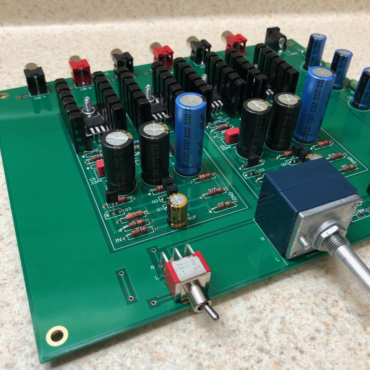

Help please....
My amp is assembled, but the LED is pulsing constantly. Reading the trouble that Audiobear had I plugged in some older headphones and found that both channels are working fine. The sound pulsates as do measurements I am taking.
My power supply is the recommended class 2 SMPS at 24VDC and 1 amp and I checked the polarity, which was fine. I measured all of the resistors (in place though) and noticed a couple are different values than in the BOM, but I believe as they are in place that can happen. Is that correct? I measured all components before stuffing the board, except I only measured the first resistor if they were on tape. I noticed I that C2 and 3 and different in other builds, whereas mine are the same. C3 is specified as GOLD and C2 not. Is that maybe the issue?
Forgive the big honking screws holding the MOSFETs in place. When I came to fitting the ground plane I saw that they were meant to go there. I tried the amp with and without the plane and it made no difference. The resistor for the LED is 15K, but I read in the forum that's fine.
C3 not being gold is not a problem. The gold C3 is an "audio grade" capacitor but a regular capacitor will work correctly. The difference is a "possible" difference in sound quality, but no difference in electrical function.
The larger LED resistor reduces the brightness of the LED, and will not affect the function of the amplifier.
The pulsing LED, voltages, and amplifier volume sound like something is causing the power supply to malfunction, possibly because more current is being drawn from the power supply than it can provide. You are getting sound so that is a good sign.
One member had that problem because he had installed much more capacitance for C6, C7, C8, and C9. I could only get a glimpse of your capacitors so please confirm that all of your capacitor values are as specified.
Or possibly you have a bad power supply. Please post a picture of the power supply label.
Also please measure some voltages:
1. At power supply input, between V+ and GND
2. Across R20 and R21
3. Both channels across R12 and R4. What is the value of R4?
For the voltage measurements, please try to get the maximum and minimum voltages if the voltages are pulsing.
