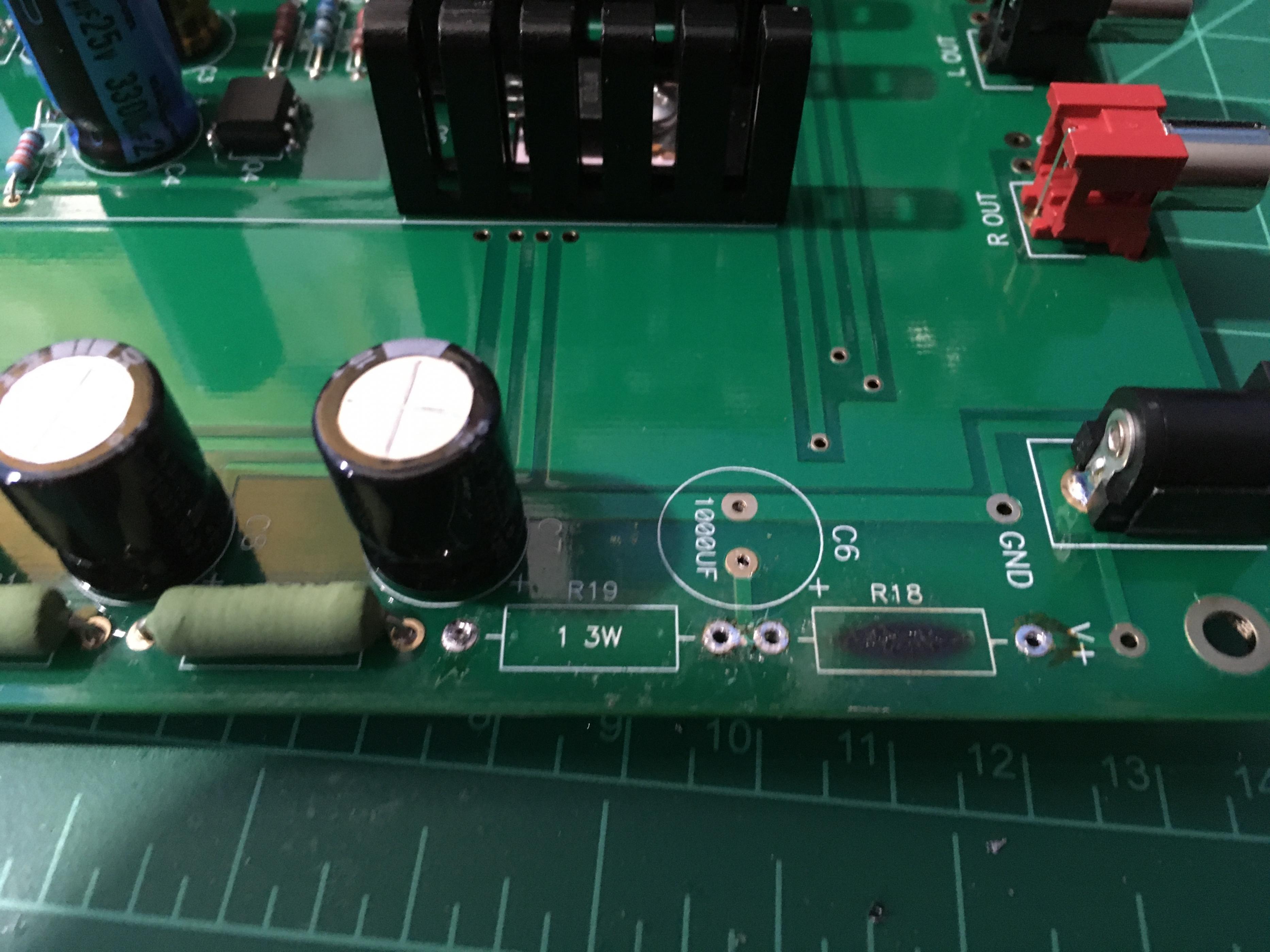

C6,7,8,9 appear to be 3300 uf not the specified 1000 uf. Little switching supply could be struggling to fill them. Are the other big caps the correct values? Camera angle seems to make them look wrong, not equal from side to side.
@Fusor. Good eyes! They are actually 1 x 1000 and 3 x 3300s. I ran out of 1000s and have more on order. There's an illusion in the photo; the furthest one is actually a shorter 1000. I should have mentioned this on my original post. People are always putting larger caps in power supplies so I figured I could get by with the 3300s. With R8R lifted they seem to work fine for the working left channel but maybe your are right. I have some Nichicon "non-audio" 1000s that I could substitute.

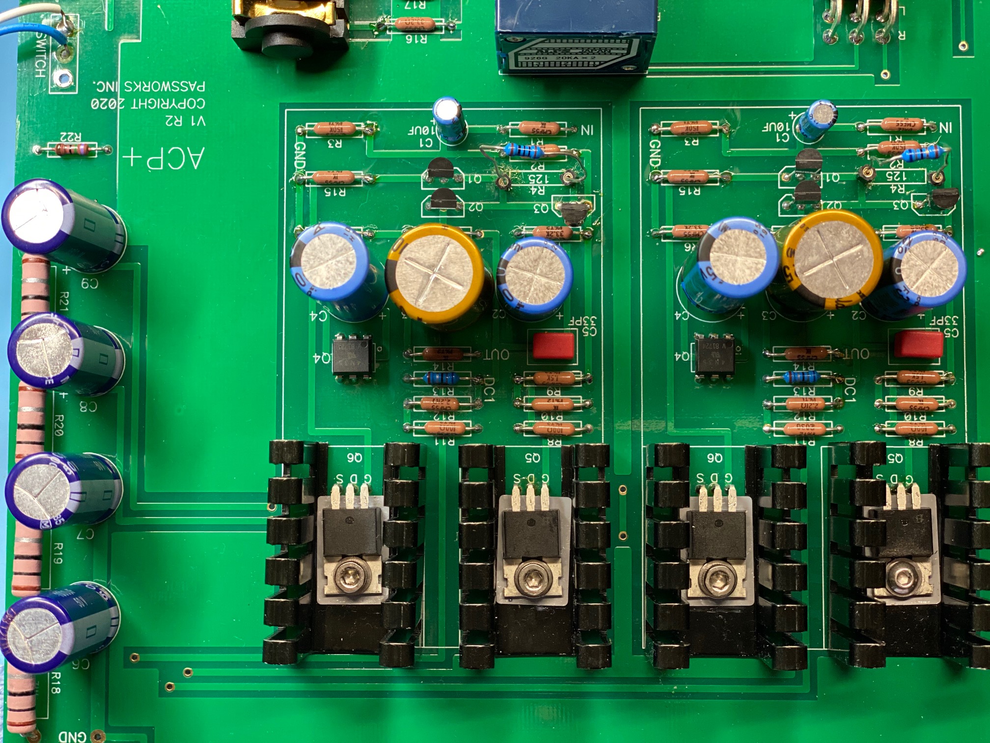

This is a different board from post 1278, correct?
When I look at the attached image, the R4 on the right side has color bands
blue, grey, black, gold (maybe reflection, it actually look silver from my old laptop), violet.
This color bands is 68R.
Looking at the left side of the image, the color band is
violet, black, black, black, violet
If this is the case, this R4 is 700R which will be way way too high, 7R or 70R will be more likely.
Can you confirm the value?

@pchw: Yes it is a different board and I think I'm going to cry. The one thing I didn't check was the two resistors that I was switching in and out of R4 to get 10mA. They should be the same 68 ohm resistors since I was swapping them in pairs. @pchw, you have sharp eyes. I don't think the resistor is a 700R because I don't have any of those but it should have been a 68R. I wish I had looked as carefully as you did at the photo I posted. I am not at home until tomorrow morning but will verify then that you have found a major problem--hopefully the only problem. I sort of know you're right because when I cleaned up my bench this afternoon before heading out I found a single 68R resistor sitting on the desktop. Instead of realizing where it belonged, I just put it back in the store of 68R resistors without giving it a second thought. I had lots of other things on my mind. Another lesson learned today. I'll post the outcome tomorrow.
@pchw I have an afterthought; if the resistor is brown black black black brown which it kind of looks like to me, it's 100R. That's more likely since I have 100R blue Yageo resistors. That brings the question if a 100R would produce the problems I am seeing. Since the original R4 value was 125R I kind of doubt it. We'll find out tomorrow afternoon.
All's Well That Ends Well with second ACP+
@pchw: The R4 right resistor was in fact 100R.
With the schematic and DVM in hand, I went point to point measuring voltages until I decided Q3 was the problem. I replaced Q3 with a J113 that nearly matched J113 Left. The voltage across R4 now measured about 560mV instead of 0. Switching in a 47R for the 68R resulted in 10.9mA across R4 right which fortuitously turns out to be the same current observed across R4 left. Both channels now play and all sounds good. I guess I must have fried the J113 when soldering it or else shorted it out somehow. Whatever fried Q3, all's well that ends well. Thanks to those of you that helped along the way in this adventure. It was a good learning experience.

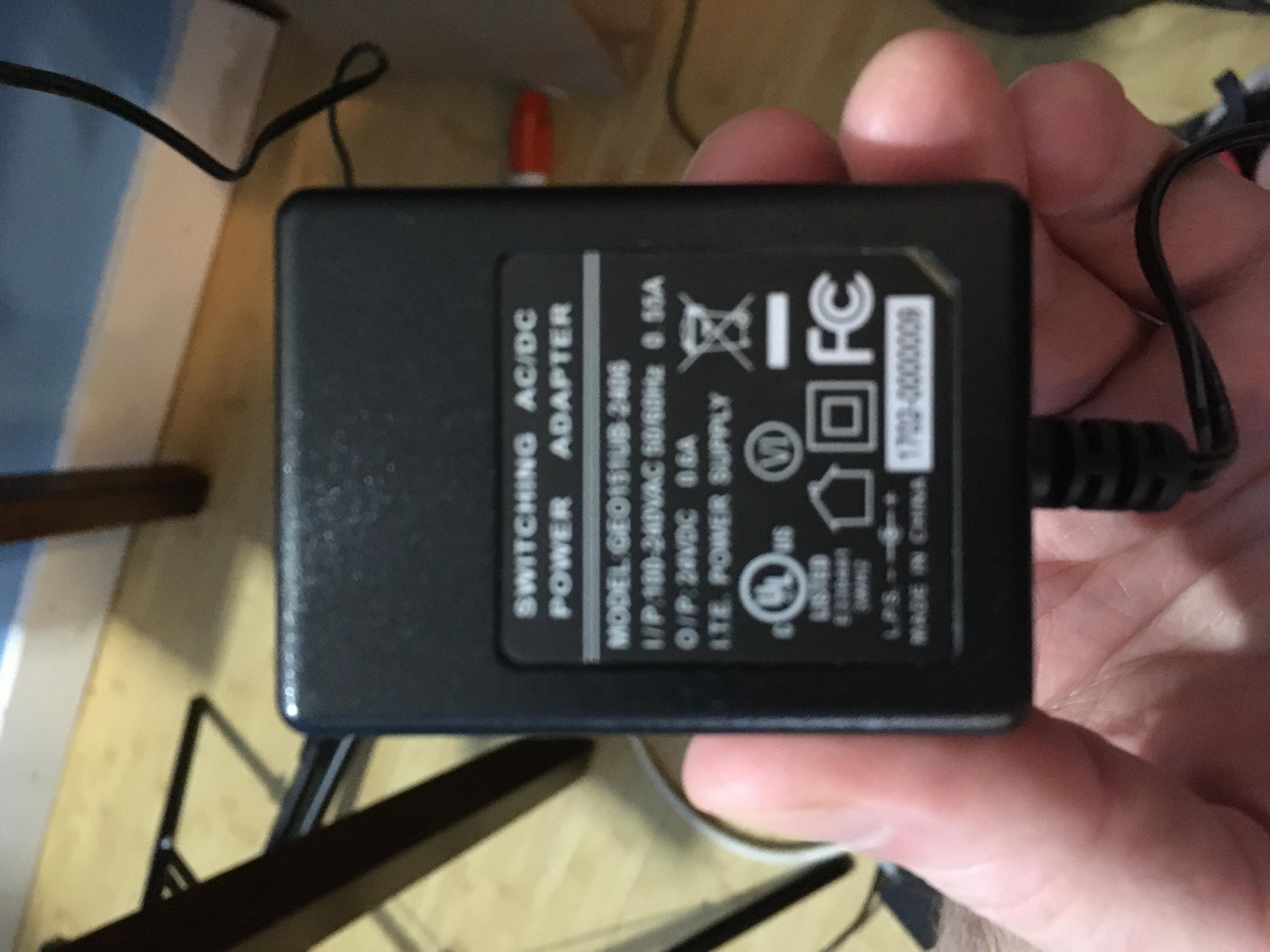

Hi All, I've been following along at home and got everything installed (and learned a decent amount about jfets in the process). Reached the point of plugging it in and testing voltages when I realized I had the wrong size power socket for the Triad adapter. Went fishing through my rack gear and other adapters and found a 24v that fit...plugged it in and...a few seconds later a burning smell and some smoke! LED glowing solid. Unplugged and with great embarrassment realized the adapter was 24VAC.
Went the next day and got an equivalent adapter with correct barrel size, plugged that in and it seemed to be charging the caps and blinking the LED as NP describes, did that for a minute or two and then gave up. LED dimmed and gave out.
So, best guesses, what have I fried? I've already desoldered and replaced R18 and R19 (one of which had a nice searing underneath, as you can see), as well as C6 and 7. I've been following the voltage down the line and get 24v up to R20 but I was hoping for some guidance as to how to debug this and get it working...or if I've completely shot it...😕

Some voltages seem to be oscillating?
DC1 (this is the same as V+ ?): 0-13.5V
Both R4s: 0.52V across 100R
R R15: 0-4V
L R15: 0-3.9V
R R12: 0.03V
L R12: 0.13V
Also below is the new adapter:
Maybe relatedly, I was assuming the switch near the LED was either to switch input or output, but is actually on/off?
