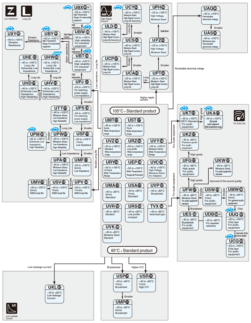

to feed the audionervosa
NICHICON ELECTROLYTIC CAPACITORS
TVX Axial General Purpose
USA General Purpose (USR smaller, UST high temperature)
USR General Purpose
UMA Standard, Low Profile (UMT high temperature, UMV long life, UMF low impedance)
UHE Miniature, Low Impedance, High Reliability (UHD lower life)
UKL Low Leakage
URS Low Profile (URZ high temperature)
URZ Low Profile, Wide Temperature
UPM Low Impedance, High Reliability (UPW smaller)
UCS Miniature, High Reliability, High Ripple (UCA larger, UCY smaller)
UVR Miniature (UKL lower leakage, UVK smaller, UVZ high temperature)
UVZ General Audio, Miniature, Wide Temperature (UKT higher audio quality, UVY smaller)
UKT General Audio, Wide Temperature (UKA higher audio quality)
UMW Standard Audio, Low Profile
UKA High Grade Audio, Wide Temperature
UFW Standard Audio (UFG higher grade, UKW higher audio quality)
UKW Standard Audio
UFG High Grade Audio MUSE (UKZ higher grade)
UKZ Premium Audio MUSE
UPJ SMPS Low Impedance (UPS smaller, UPV long life)
UPS SMPS Low Impedance, Miniature
UPV SMPS Low Impedance, Miniature, High Reliability
UPW SMPS Low Impedance, Miniature, High Reliability (UTT long life, UPA low impedance)
UTT SMPS Miniature, High Reliability
UDB Bipolar, Speaker Network
UES Bipolar MUSE
UVP Bipolar
- not my work, and I don't recall where I grabbed it from but I have used this as a reference to Nichicon caps when building / setting up BOMs

Nichicon offers a ton of “audio” caps, and they describe them all in a nearly identical way. I just pick the best looking 😀
I think the smaller (22mf) is NP and the larger (1000mf) is P. It’s hard to say how they sound, as I’ve never tried any other caps in this circuit. It does sound fantastic, but not sure I can attribute that to the caps. I’ve not used them before the ACP, so can’t provide much insight. Sorry.
Nice!Nichicon's graphic is pretty helpful too, since it shows relationships between their product offerings:
_
Definitely referencing this moving forward. Thanks Mark!
Yes, same here! I don't know where you found that. I've looked for something like that on Nichicon's site several times. Thanks Mark!

I was just spending my free afternoon drawing (trying to, to be honest 🙂 ) exactly such an Infografic (with some of the types missing), but now it’s here.
Cool.
Nichicon's diagram is proudly displayed on their website under the not-confusing title DIAGRAM SEARCH
LINK
And, oh by the way, if you need a capacitor to build yourself a 10 second or 30 second timing circuit -- as I often do, when building output muting / powerup-be-quiet circuits -- the "Low Leakage" capacitors called Nichicon UKL are truly wonderful. See how quickly you can find them on the diagram! It's fun!
_
LINK
