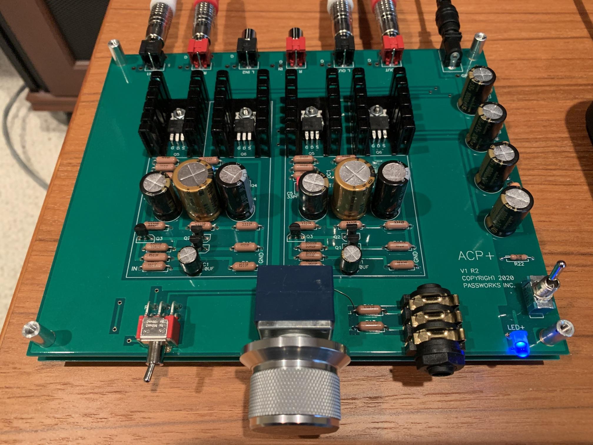

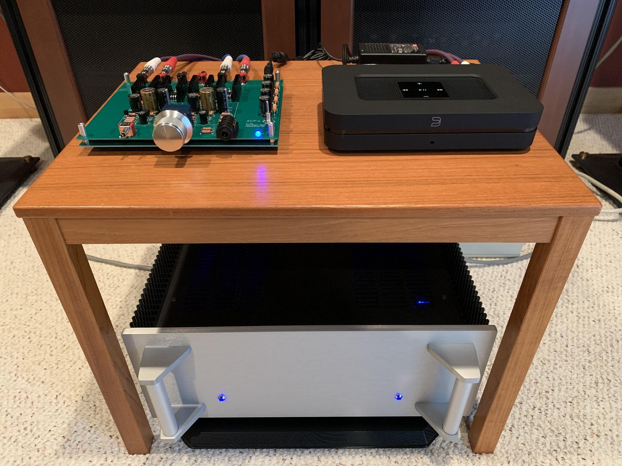

Totally enjoying this preamp/headphone amp. Plenty of drive and headroom with HD 650 and LCD-2. Just connected it to my F6 and being bathed in wonderful warm sounds!

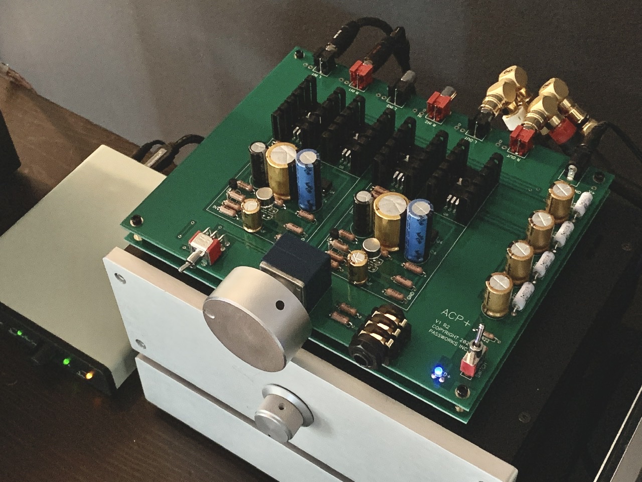

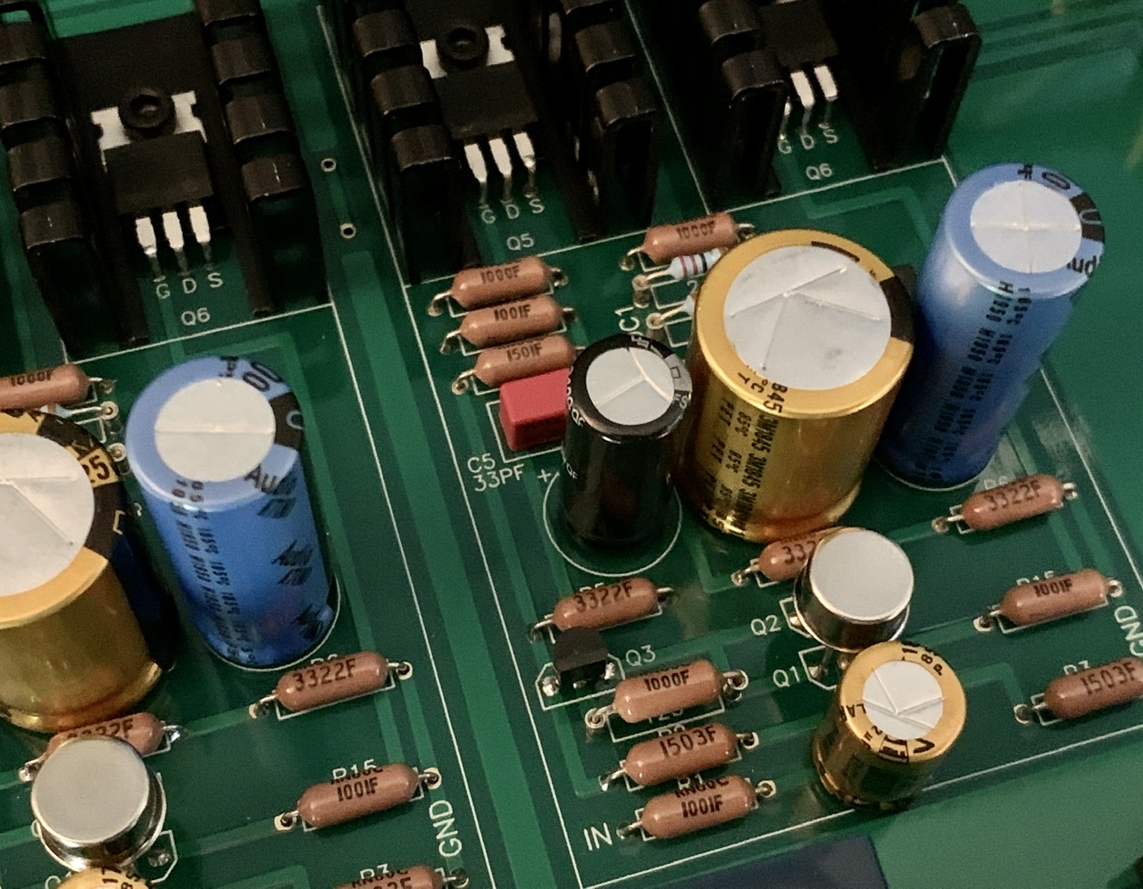

No electrical insulation necessary. I used heat sink paste but Keratherm works too to assure thermal conductivity.

Maybe a silly question, but the DIYAudio Store has a PCB and a "naked" PCB which looks like a blank PCB from the images. It only refers to "A ground plane is also available for purchase so that you can build it naked just like they did at BAF (if you're into that kind of thing)." Since I wasn't at BAF I have no idea to what this is referring to.
Can someone please clarify ?
The ground plane board is basically an electrical shield to reduce hum and interference if you are building the ACP+ without using a metal chassis.
The "naked" PCB is the ground plane. If you look closely at the first picture, you will see that it is mounted under the circuit PCB.
Ah fantastic. Thanks for clarifying. I'm going to put it into a small chassis so I'll stick with just the PCB.

Finished up my ACP+. Sounds fantastic! Especially like the combo with my 32R Grado’s 😀 I used pin sockets for Rccs (R4) so I could measure and dial in according to my specific J74 and J113 combo. I also used pin sockets for the output and follower Rdegens (R12 and R13) so I could play around with distortion spectra, though I’ll say it sounds perfect as-is.
Really enjoyed this one! And building case-less allowed me to indulge my ocd for a clean and tidy build. Thanks Nelson and co!

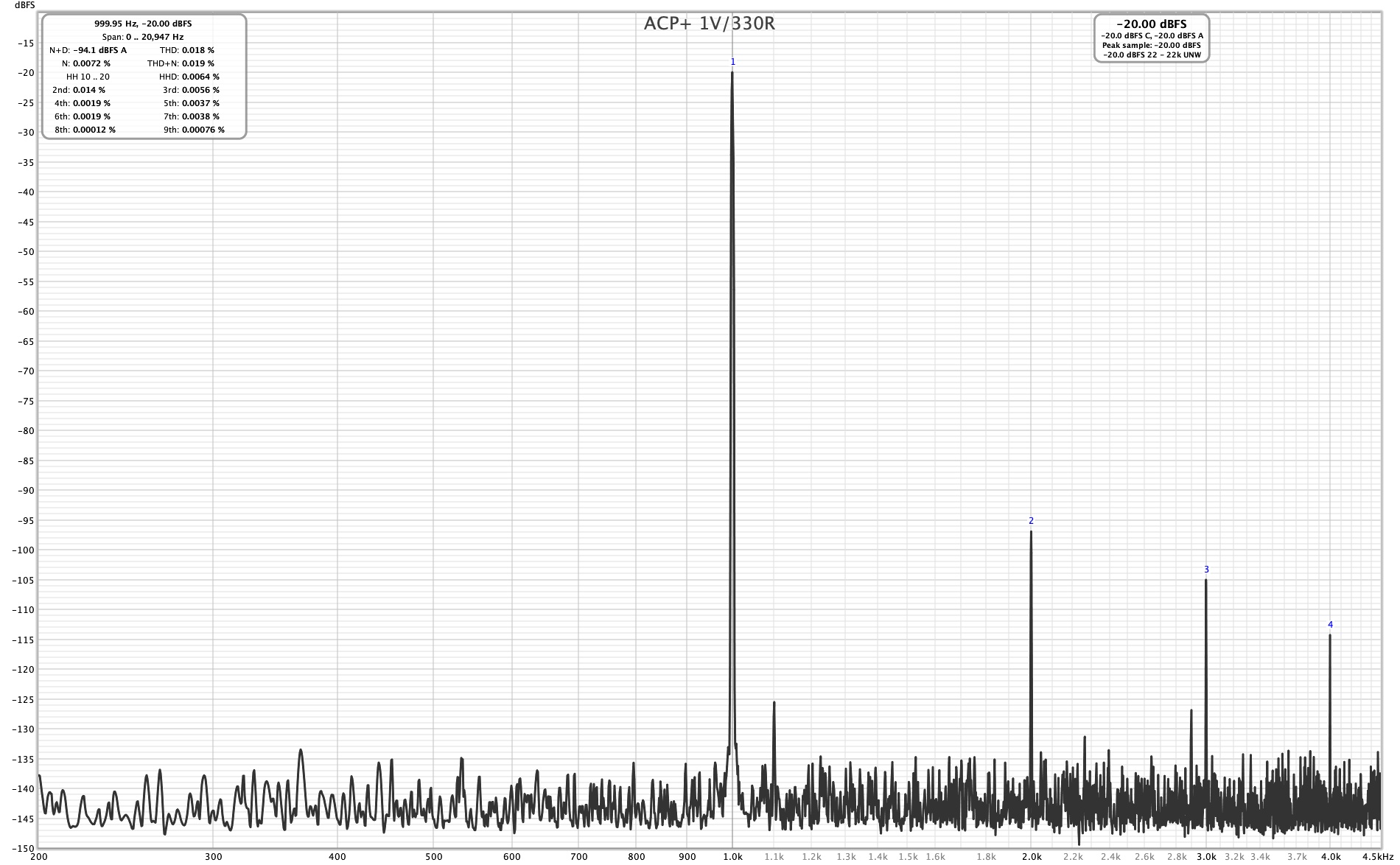

Here's a quick distortion measurement, 1K at 1V into 330R. Please note that I don't have much of a 'setup,' just a Focusrite and REW. That said, ACP measures really quiet and the distortion signature does look a lot like the J2. Pretty good, especially considering its sitting in open air and surrounded by gear.
