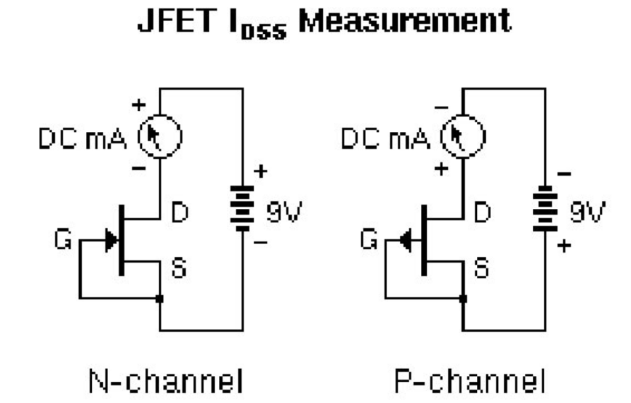

During our project we followed the matching instructions here for the J113s:
JFET matching information – diyAudio Store
And picked up a matched quad of LSJ74s from the store.
Wasn't really prepared for the J113 matching and only ordered 2! They were a match 😀. All said, we still used 125R R4s per Nelson's guide. Wasn't simple (to me) to verify the 10mA noted on the schematic

How did you verify those 10 mA? I have a bunch of J113 and want to do the same.
Couldn't "verify" the 10mA, my understanding is that to actually take that measurement you need to lift an R4 leg while in circuit. Based on the link above I posted with instructions for testing Jfets—it indicates that 1V = 10mA, while that might be accurate, I understand it's different in circuit—maybe someone who knows more can weigh in with details. Our J113s measured 1.68 and 1.66VDC under the test conditions in the instructions.
You can verify the current in circuit by measuring the voltage drop across the 125 ohm
resistor R4.
resistor R4.

Next question: Is it possible to measure it before inserting into the circuit?
The range of J113 Idss is quite wide..
Building this little circuit on a breadboard, will this be ok when I measure 10 ma here? Here I can choose the FET or resistor as i like without damaging the PCB...

Ok, thanks, I know that circuit.
I don't want to measure Idss, but the current that I can expect from that current source, when inserted into the ACP+ circuit.

Ulf,
The circuit you drew in #491 will work. Just stick V+ at 12V and
select a pair of j113 where the voltages across the 125 ohm resistor
are close to 1.25V and you're done.

If, like me, you still don't have a breadboard or lab PS, is there anything wrong with dialing in 10mA thru R4 by temporarily using a trimpot in place of the R4 resistor, then replacing the trimpot with a standard fixed resistor once the ideal value of R4 is determined?
That is a very appropriate thing to do.
