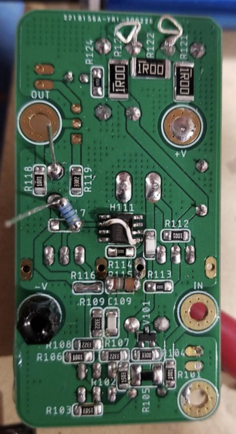

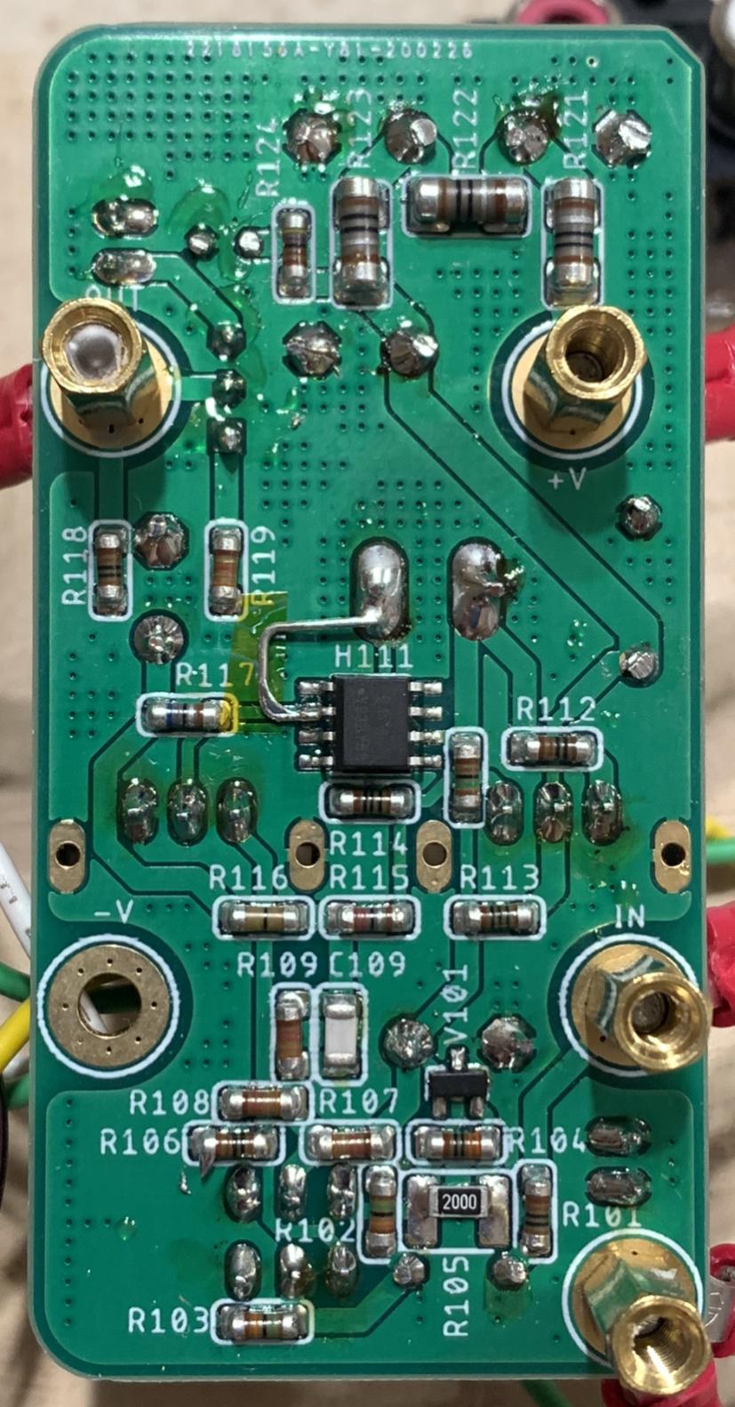

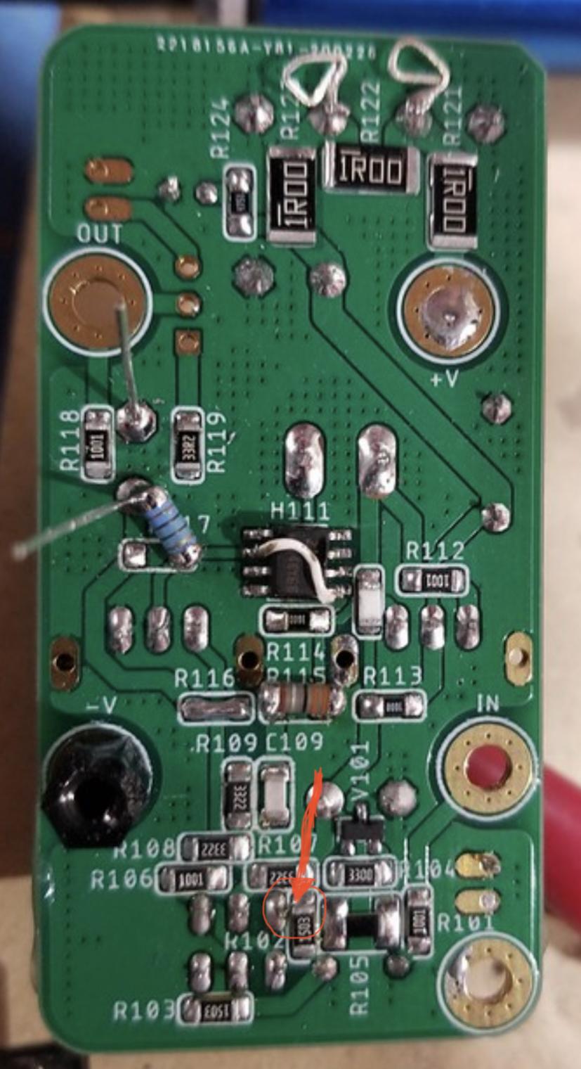

Is C109 (or is that R115) and R109 unintentionally solder bridged together?
Component numbering is all over the place
yes - component numbering on the board is not always apparent.
I think you are looking at R115 - R116 ( I had tried not to have them bridge, but they are linked anyway , so probably does not impact the circuit )
I have attached the schematic so that these part numbers make more sense
Resistance across gate and drain is as follows:
upper mosfet - V111 ~ both boards around 4K
lower mosfet - V112 ~ slowly increases ( starting at about 1K5 ) after 3 min 45K

Sorry to see you are having trouble with this board. I seem to to recall you said it used to work but the bias current was too high so it was running hot. Then you tried to change the output source resistors (per my recommendation) and that’s when it started smoking. Did it ever work? I can’t make out the colors on R117 but is that 6R8? Also what do you have on R105 it’s unlabeled? It should be 200R.
Make sure R116 is not shorted to the trace beneath the solder mask that travels beneath it. A 0R resistor is insulated across its body, whereas the wire jumper is not.
Here is a photo of my working amp. It seems to compare well with yours except for the two I indicated as not clear. I put your photo side by side to compare.
I think it had trouble before which is why it was running so hot , it also pulled the voltage down further than I had anticipated which would make sense if it is was draining close to 2 amps.
R105 is indeed 200R, I changed R117 to 10R. I wonder if it is as simple as the wire jumper. The 0R resistors I bought were too long to fit an I could not use them which is why I substituted the wire.
I will correct this as a next try
Thanks ..dB
2A is a short it sounds like.
Probably not this as it’s affecting both boards. An you check for solder bridges here?
