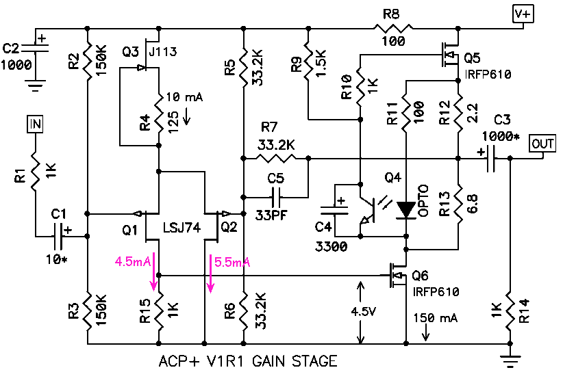

reducing bias in the circuit
I know enough to be dangerous and clearly not enough to get myself out of trouble
I am trying to implement this circuit into an integrated amplifier as a preamp only
as you can see the space is pretty tight and I had dropped the bias current a little based on another DIYAers advice [TungstenAudio] but it still runs too hot for this application. ( those tiny heatsinks are a scorching "&%$^&*%E$" on NPs finger test ~ 65 degC with an IR meter )
When I initially built the ACP, I dropped the bias by increasing R9 to 3K and increasing R12 to 3R2. Could someone help me understand the theory or the formula calculation for adjusting the bias and if there are other things to consider when changing the bias - my aim is to shoot for about half of the original bias in the circuit. It will not be used to drive headphones.
thanks..dB

thanks picoD, i tried doubling source resistors last night trying to figure this out and the moment I powered it up the supply voltage was pulled down and both those resistors started smoking - so it appeared as though I dramatically increased current flow by increasing the source resistors..dB
EDIT - for clarity, I changed R13 to 13ohms and R12 to 6ohms
Are you using 3W resistor, at least 1W should be used. You could use 0.5W but when the amp first turns on, there could be a bit of a current surge.
That shouldn't happen.
I think you have an issue with the optocoupler.
