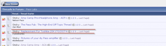

there is also sticky thread - Replacement For Toshiba 2SK170/2SJ74

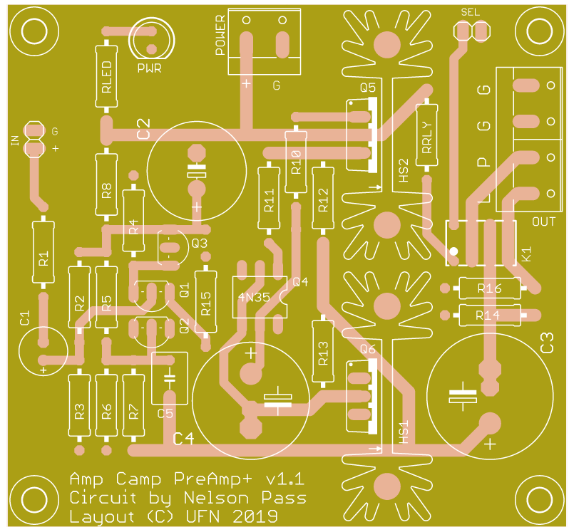

There are a half dozen diyAudio members who offer their services doing PCB layout at reasonable hourly rates. Among them: Prasi, jhofland, JPS64 and several others whose names I don't seem to recall at the moment. Why not pay them to lay out a board right now rather than waiting? Then you get your ACP+ immediately, and you also have the option, but not the obligation!, to donate those Gerber CAD files to all other diyAudio members, so everybody can get their own ACP+ boards fabbed too. You also have the option to organize a committee of like-minded people, who all agree to split the PCB layout cost. Then the expense to you falls by a factor of N. The greater the committee size (N), the less the expense.
Somewhat different from the original design in terms of layout (and I don't normally advertise my own design), but I've posted one here a while ago 🙂
Project files: The ACP+ clone… | theslowdiyer

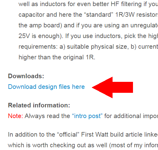

For a quick test, I downloaded the Gerber CAD files from Nisbeth's web page. They appear to be correct. My free, in-browser Gerber Viewer software ( at www.pcbxprt.com ) reads them without trouble. See 2nd attached image below.

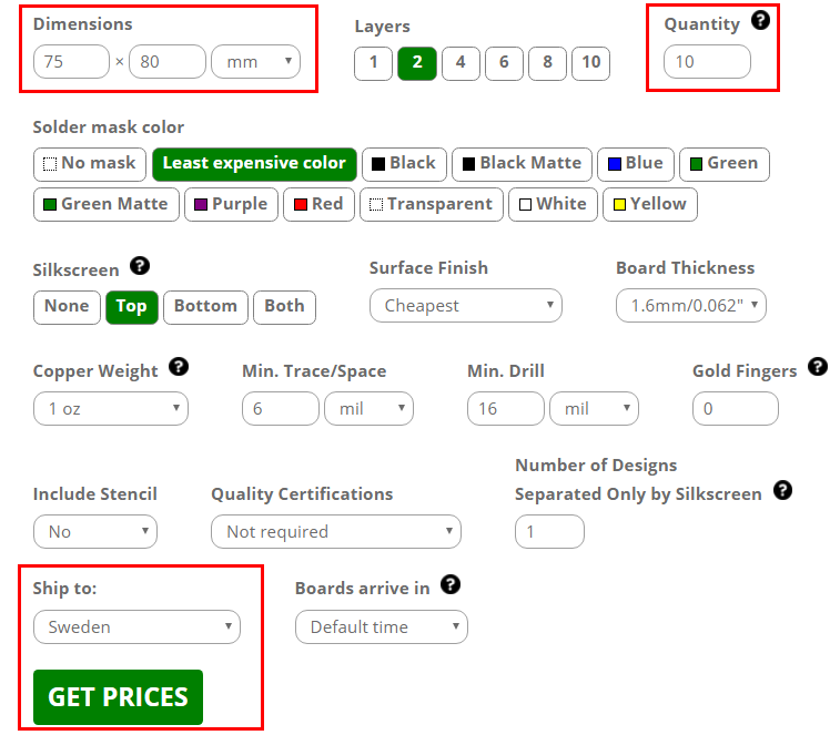

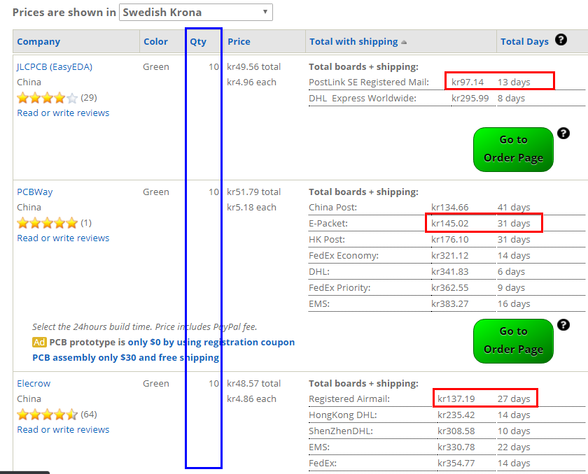

I visited PCBShopper – A Price Comparison Site for Printed Circuit Boards to get price quotes, including shipping to Sweden. Price for ten copies of the PCB, delivered to Sweden, ranged from 100 SEK to 350 SEK depending on which fab and which shipping option (speed) you select. Remember, each PCB is one (mono) channel. You need two PCBs to make a stereo headphone amp / preamp.

Mark: Thanks. Gerbers are generated from Eagle with the SeeedStudio CAM-job which is also where I mostly get my prototypes made, but yes they should be readable without issues by any other manufacturer.
