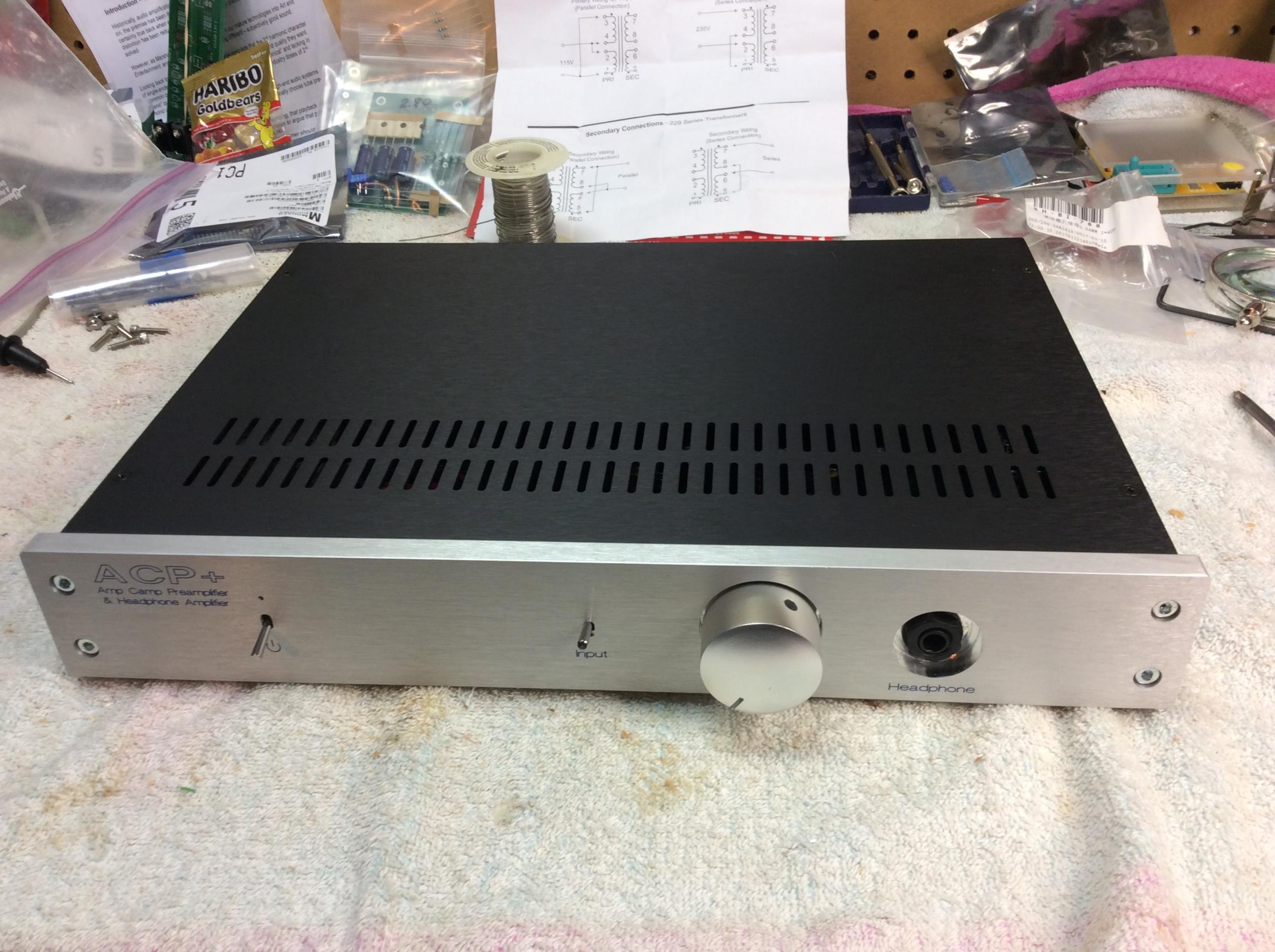

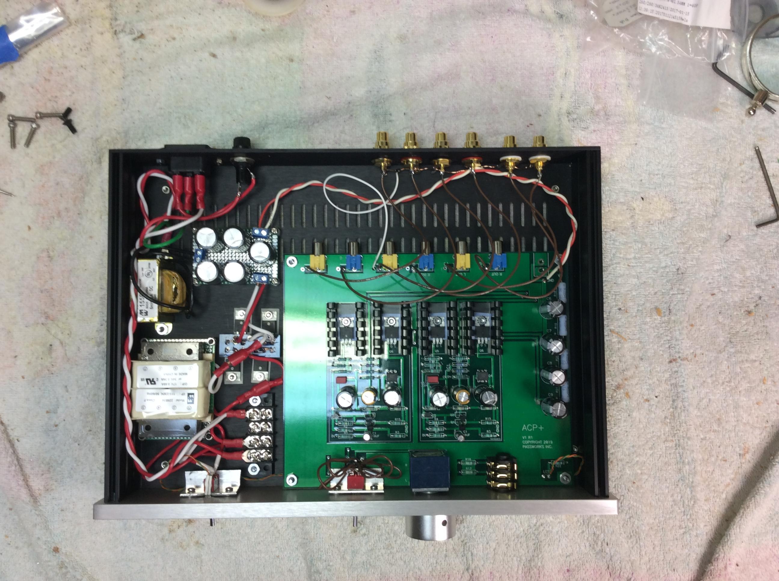

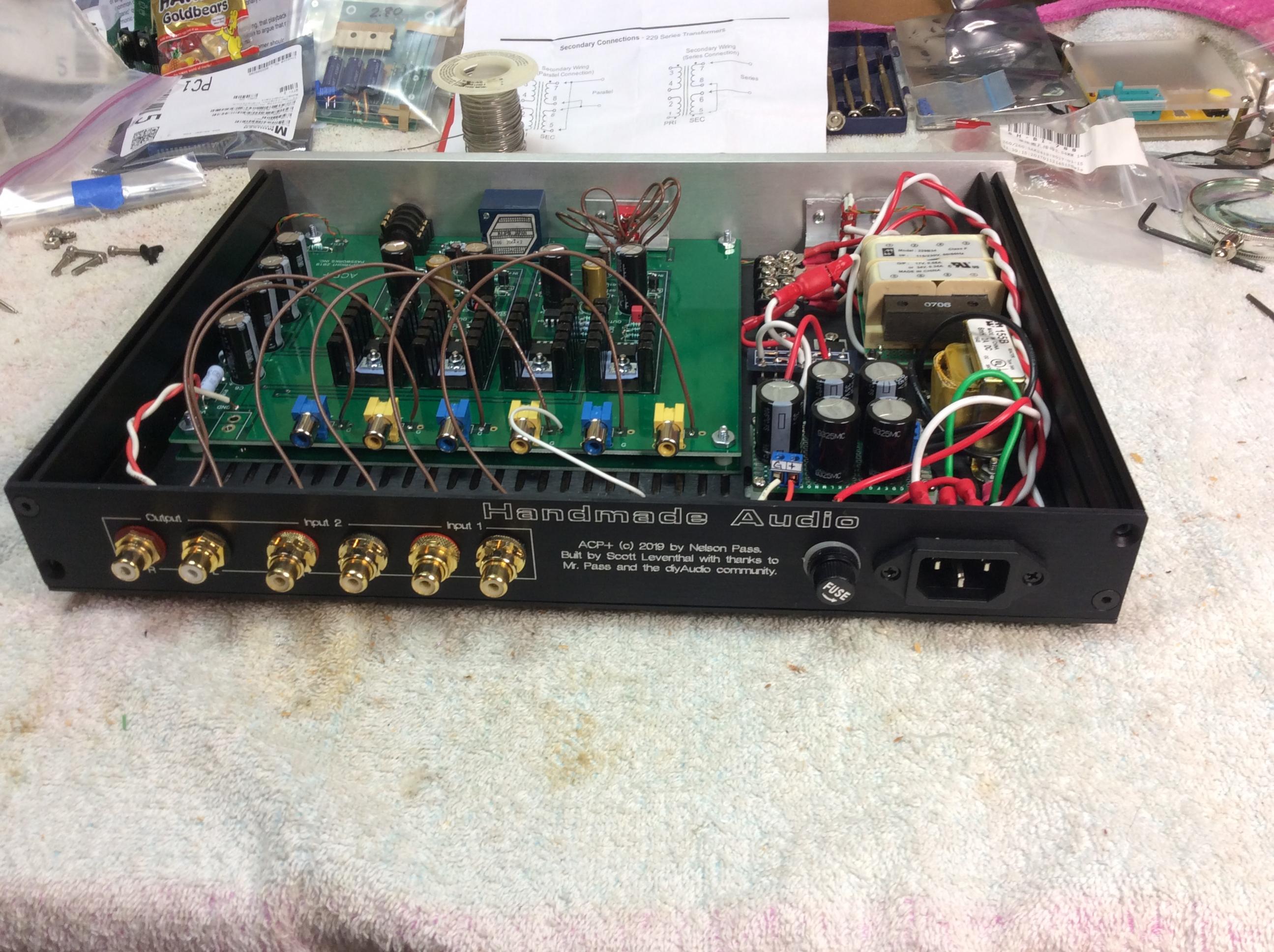

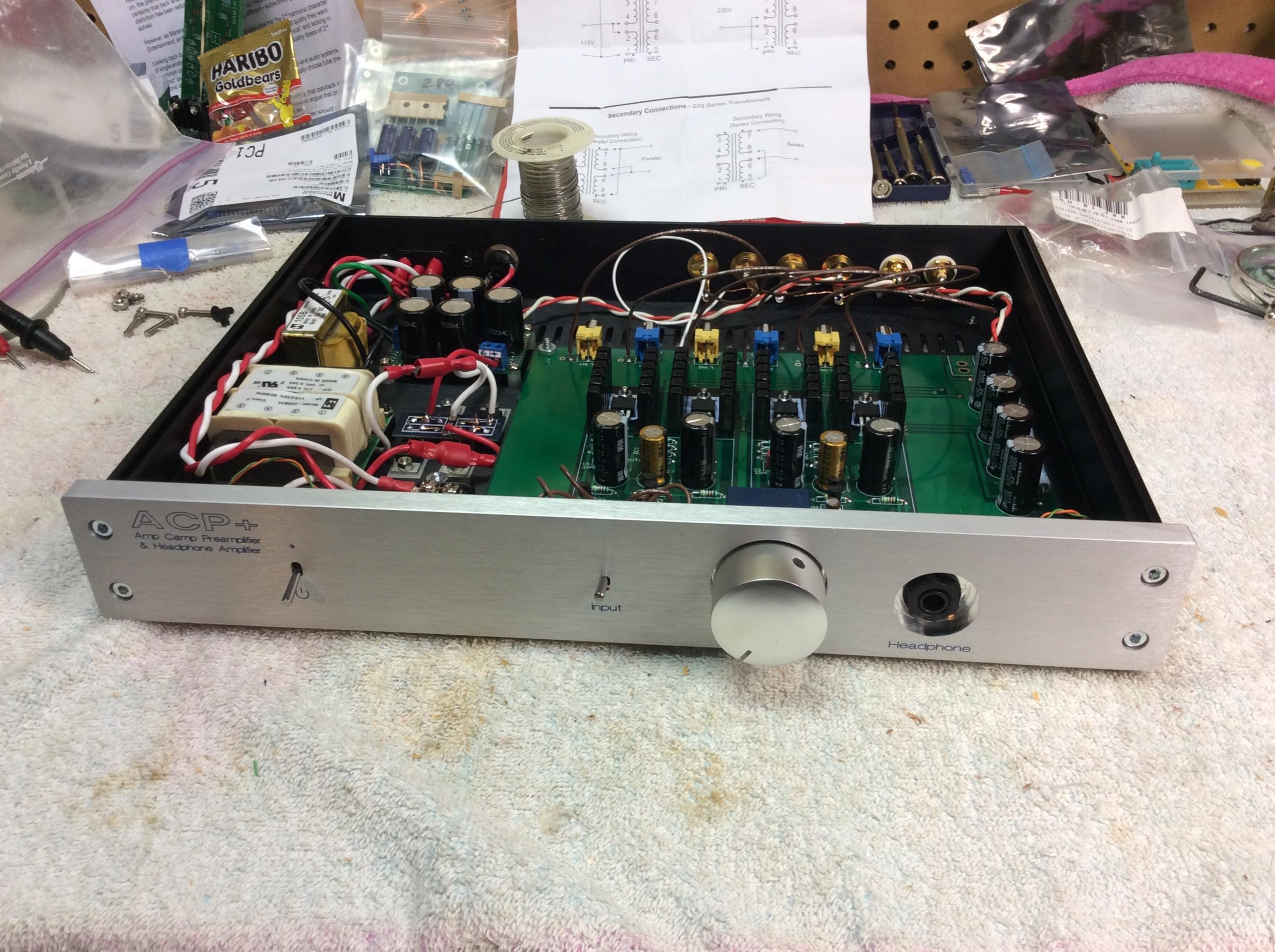

6L6:
I posted a quick write-up on the Pass pictures thread, but here are those photos.
Regards to all,
Scott

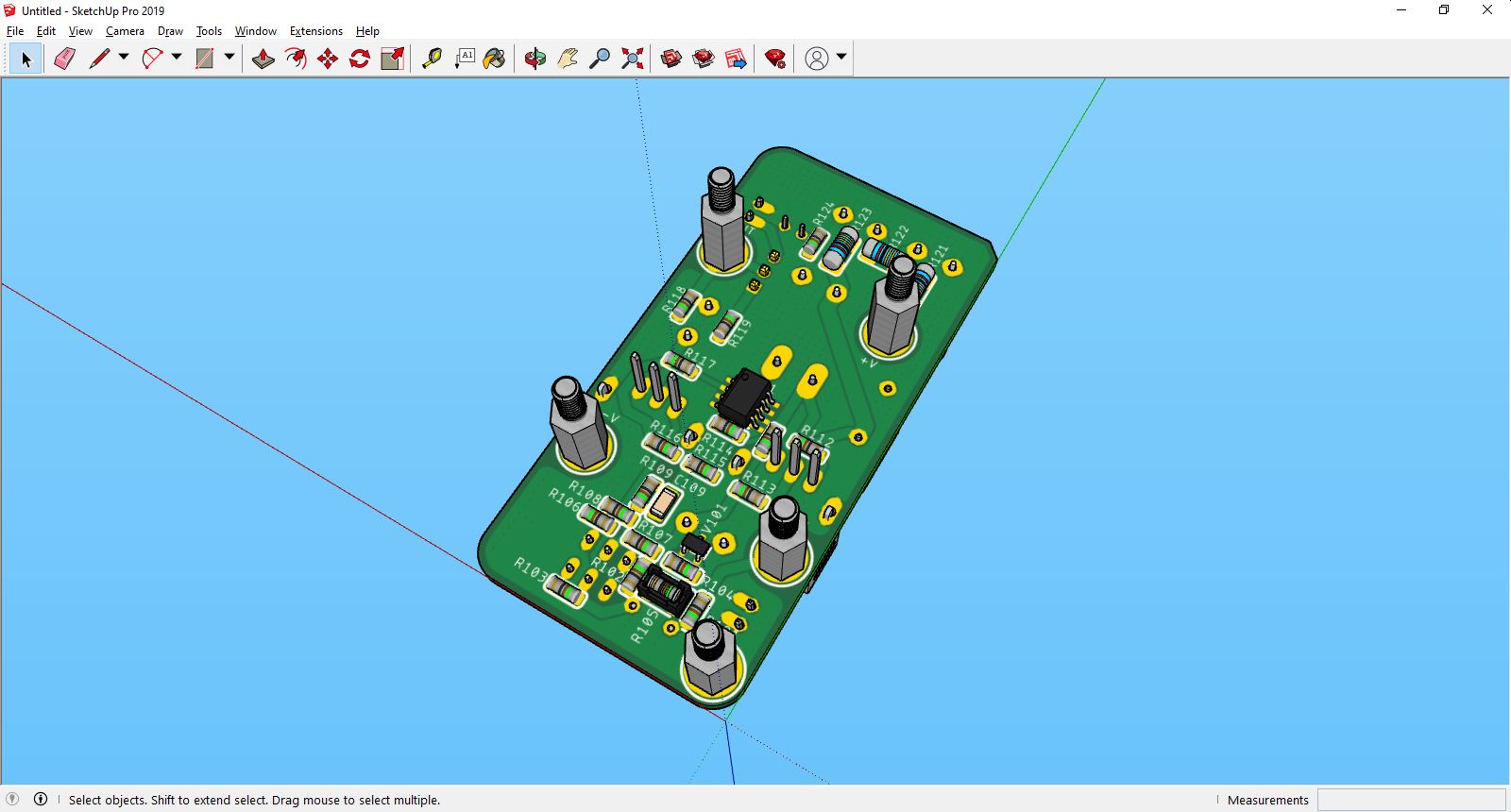

Hello Mr. Pass,
like H2 M2x, I´ve designed the ACP+ compatible M2x, so I´m asking for your permission to offer, if builders interested, this board in a future GB.
If interest to low I´ll put all the manufacturing datas online so everybody could order PCB´s and built himself this excellent circuit.
JP
JP

... I´ve designed the ACP+ compatible M2x ...
Since ACP+ is designed to drive 32 ohm headphones, while M2x presents an impedance of about 600 ohms which the daughter card must drive, I think you can safely reduce the output capacitor (C112) without affecting the low frequency response of the amplifier as a whole.
Also have you checked and double-checked your schematic for errors? (the one in post #226) ... I can't quite put my finger on it, but somehow, something just doesn't look right. The original by Nelson Pass is HERE.
