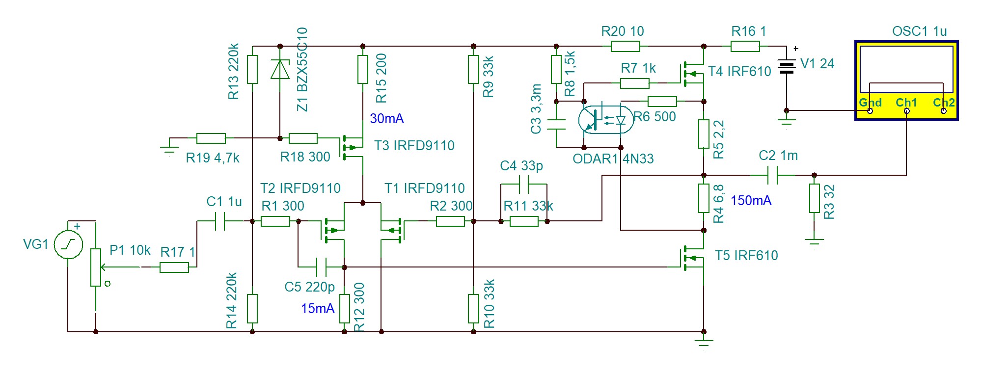

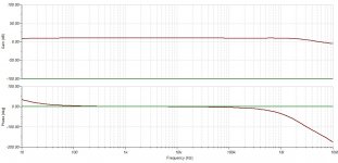

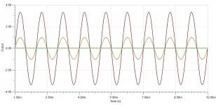

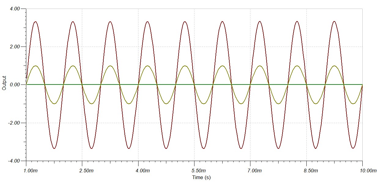

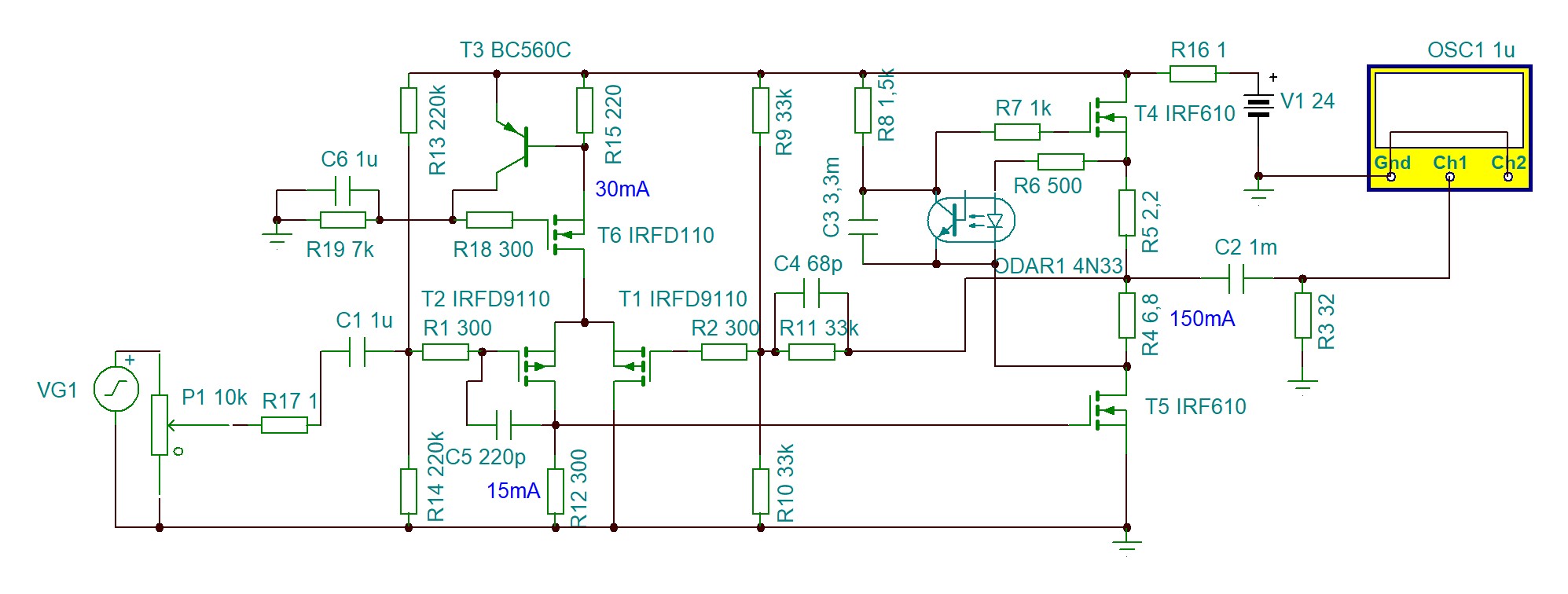

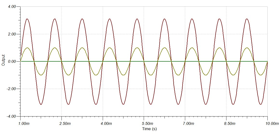

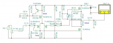

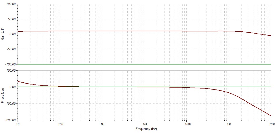

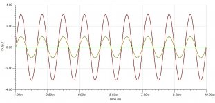

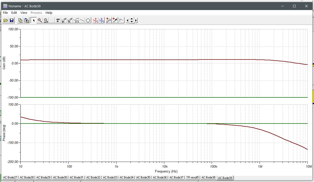

Mosfet input variant
I tried simulating schematics with mosfet input. Do you think everything looks fine and it is worth building prototype?
Thanks.

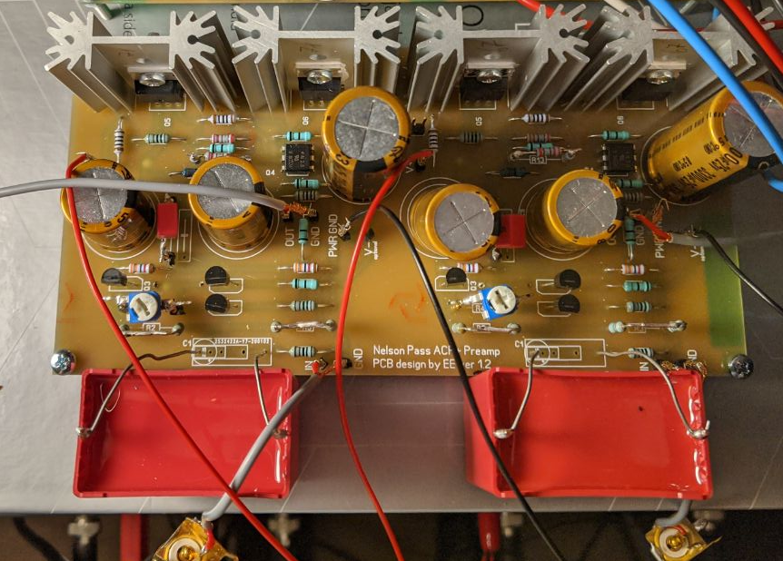

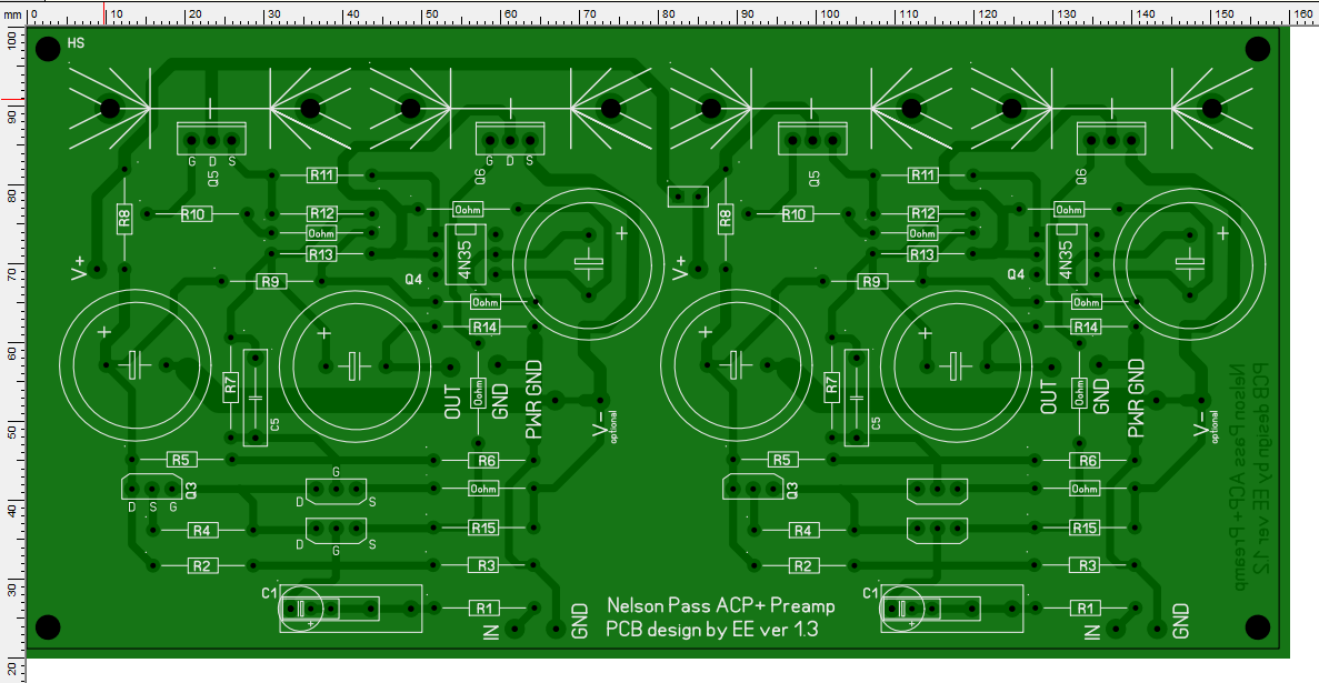

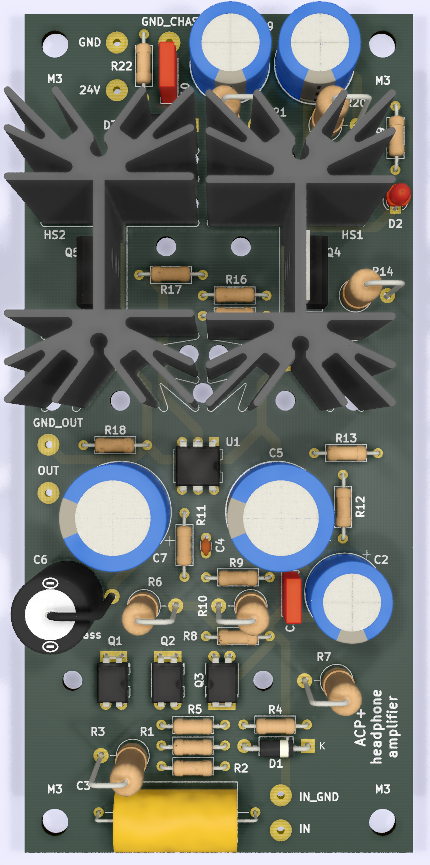

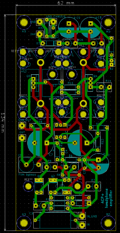

I've designed an alternate PCB for this nice project.
It's a 160*80mm one sided PCB.
If there is interest and Mr.Pass is ok with it then I can post Gerbers too. One proto has been built and the one mistake I had with traces is fixed in this snapshot... (on real thing the fix is hidden under the board ;) )
PS. I left in an option to cut the GND trace and have a dual polarity supply instead to avoid the output cap... have not tried it myself yet though.

Thank you. I normally buy all my parts from Mouser or DigiKey. I thought they didn't have the J113 but I was looking for "2SJ113". Your suggestion prompted me to look for "J113" and of course found it. Thanks for your guidance!
I'm trying to learn PCB layout and this will be a good project for me.
