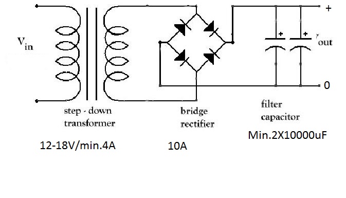

just to commend.I skiped the smp for a trafo based PSU:2*18V/4,44A.driving both channels.retifiers and caps for each channel.
Not much difference in sound,exept the bass.
Firmer,more precise and more autority.
No noice.just a low thump when turning off.
BTW:The smp distubed my tv

Jan, can you please share what kind of psu or circuit are you using?

Very simple:see att.Jan, can you please share what kind of psu or circuit are you using?

I don't doubt that you hear a difference, but do you have a thought as to why your psu setup would give better bass?
I struggled with the thought of the smps bricks from the beginning given Papa's choice to use them was for simplicity at the amp camp and not for sound quality. But as the article said I quickly "got over it." Mostly!
Could the slight difference in output (18v, 4.4a vs 19v 4a) or an even lower noise floor (Papa tested output noise at 100uV using the bricks) impact the sonics? Others here have spent hours and money upgrading the power supplies so it's not just Jan.
