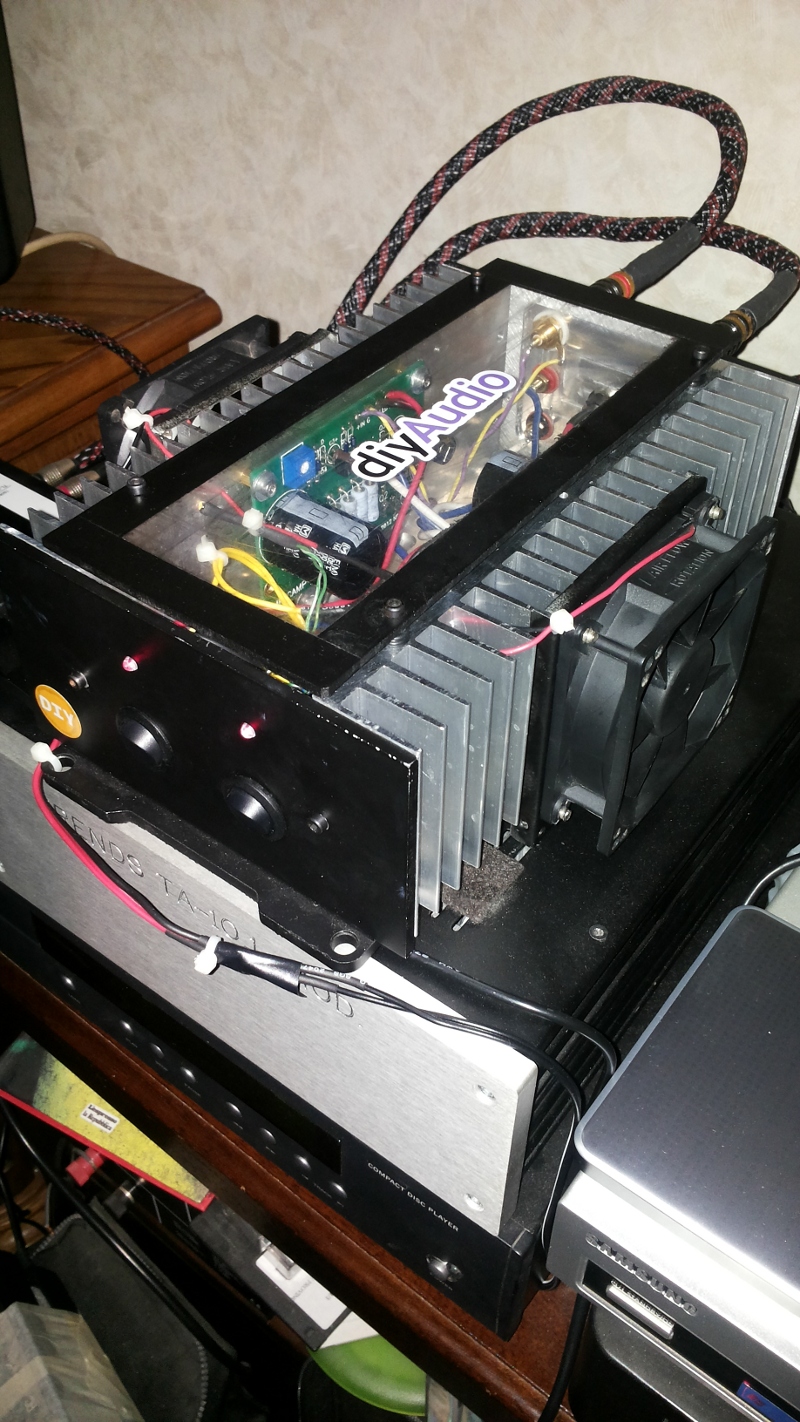

I did the mod with the resistor and I've noticed the heatsinks now get really hot. I'm not sure I've noticed much in the way of sonic improvement with the mod so I'm tempted to remove it.
This is the same I've experienced! I added a couple of fan, each in front of the heatsink with a simple circuit that reads the temp of the heatsink and keeps the temp between about 42 and 48°C.
Without it the temperature is about 30°C over the ambient temp.
The fans are 12V and I connected them in series, just to reduce the speed and then the noise.

I don't really want to fit fans-I don't know how they would fit my chassis. How much current are your amps using?

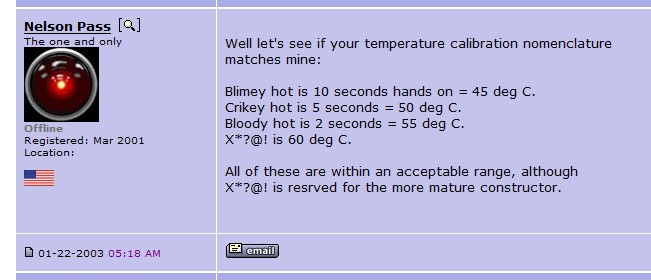

I believe Pass says you should be able to keep your finger on the heatsink fins for about 8 sec. A bit less is OK.
I obsessed over this in my F-4's which were in the 5 sec range until I think I just trained my fingers to withstand more heat...
Now I can do 8 seconds easy!
That is about what I was getting. I've never had anything class A before and I know they get hot but it was quite unsettling. Would there be any benefit in using a slightly smaller resistor just to bring the heat down a notch?

The fans are from old pc power supply and are connected to the fins by the metal cut from the same pwr supply. I added them as after the resistor mod the temp was +32°C plus ambient temp.
Now is winter and there is no problem but in summer they could easilly reach 65°C or more...
I haven't measured the current yet, I think to do it next week.
