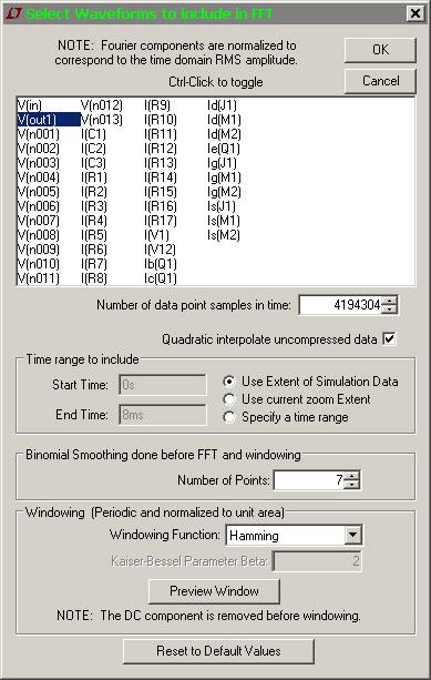

not easier to me to describe THD sim , then already described in tutorial
though
run
click on graph - view-FFT then as on pic

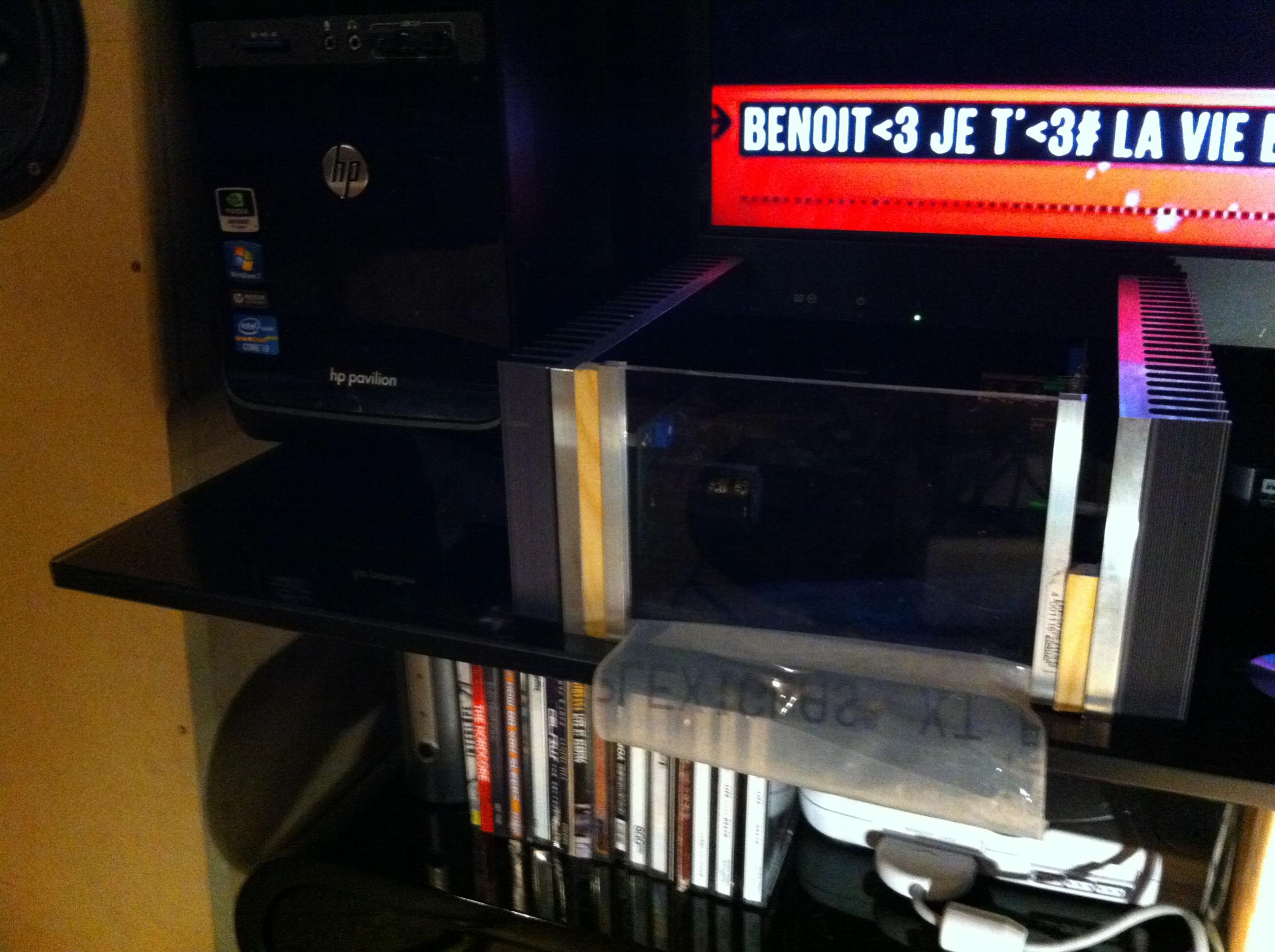

hello

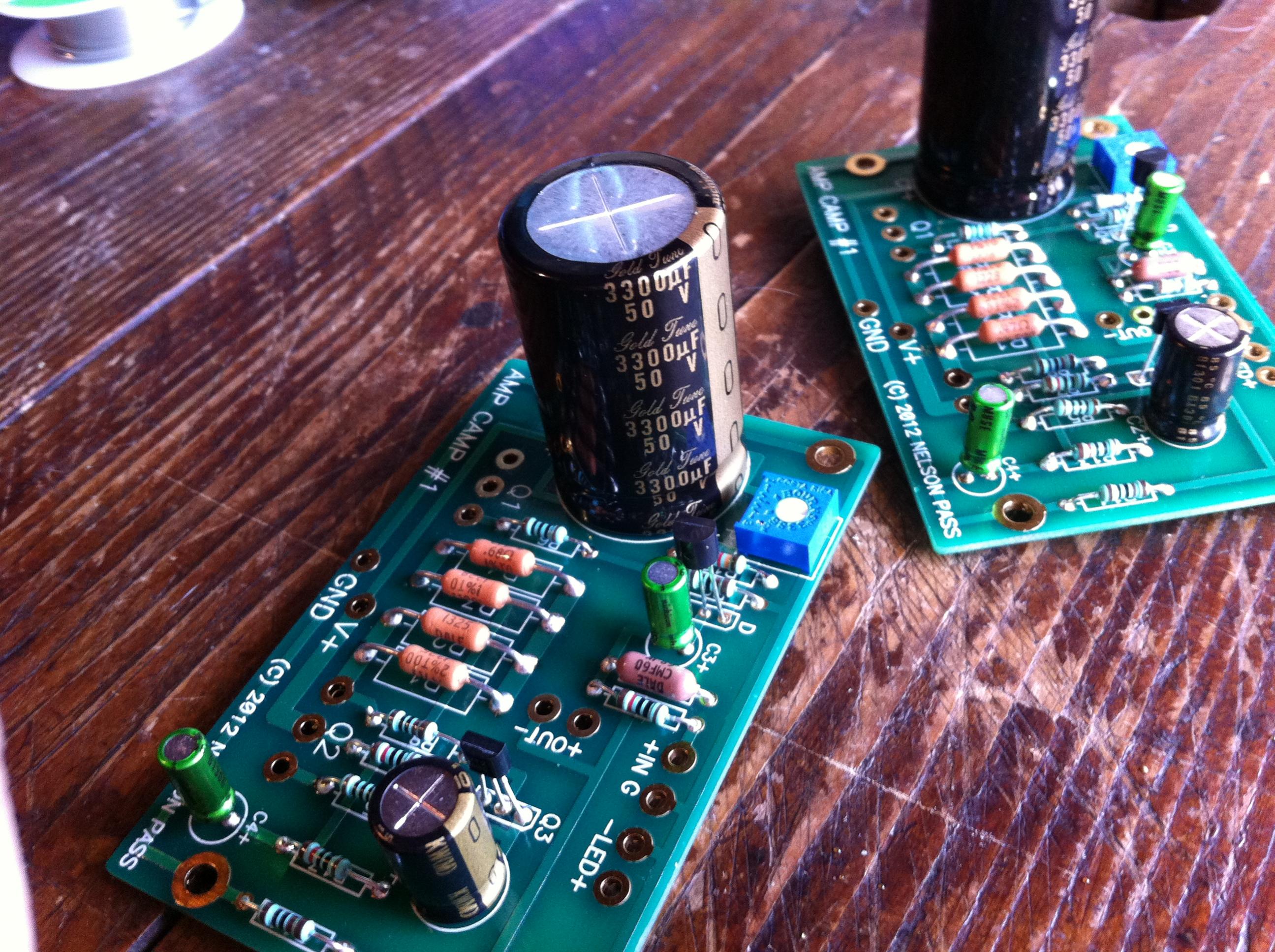

I am new to the diy. I currently working on my ACA, my pcb is complete, and I work on the chassis. My first idea is: aluminum, wood and lexan.
the assembly may not be easy, but I still trust;).
power is not yet done, but my brain bubbles ..... for preamp that could go with. may one day be a "camp amp preamp" :D :D.
is not very endow in electronics, a simple diy would be welcome. you think of a headphone amp could do the work if possible as the ACA. implementation simple, affordable and exelente sonority.
I thought for example O2 headphone amp.
do you think this way would respect the design of Mr Pass?
