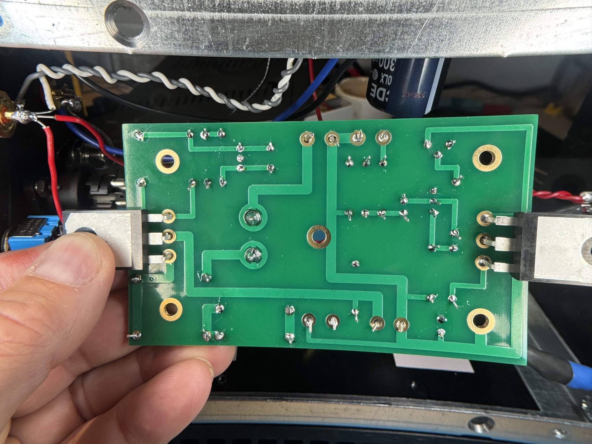

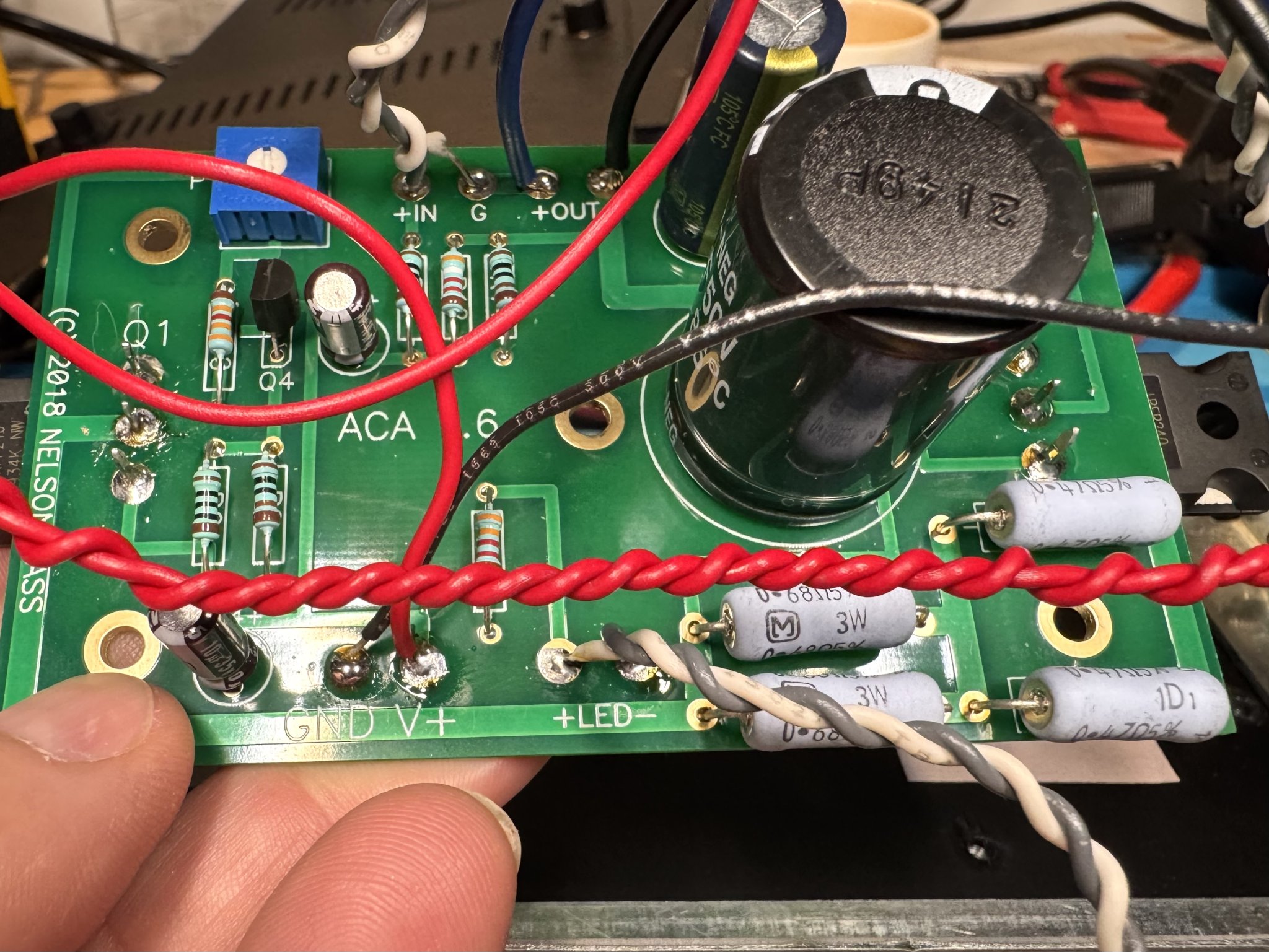

The simplest place to start is to please post a series of well-lit, in-focus photos, showing the PCBs and wiring, and let the collective eyes and brains here do their magic.
Okay. Good morning! I am working through some of the ideas. I did a reflow on a few areas on the bad channel, thought I had a reading, waited until the transistors cooled, but now nothing...except now the leds and the power supply are blinking.

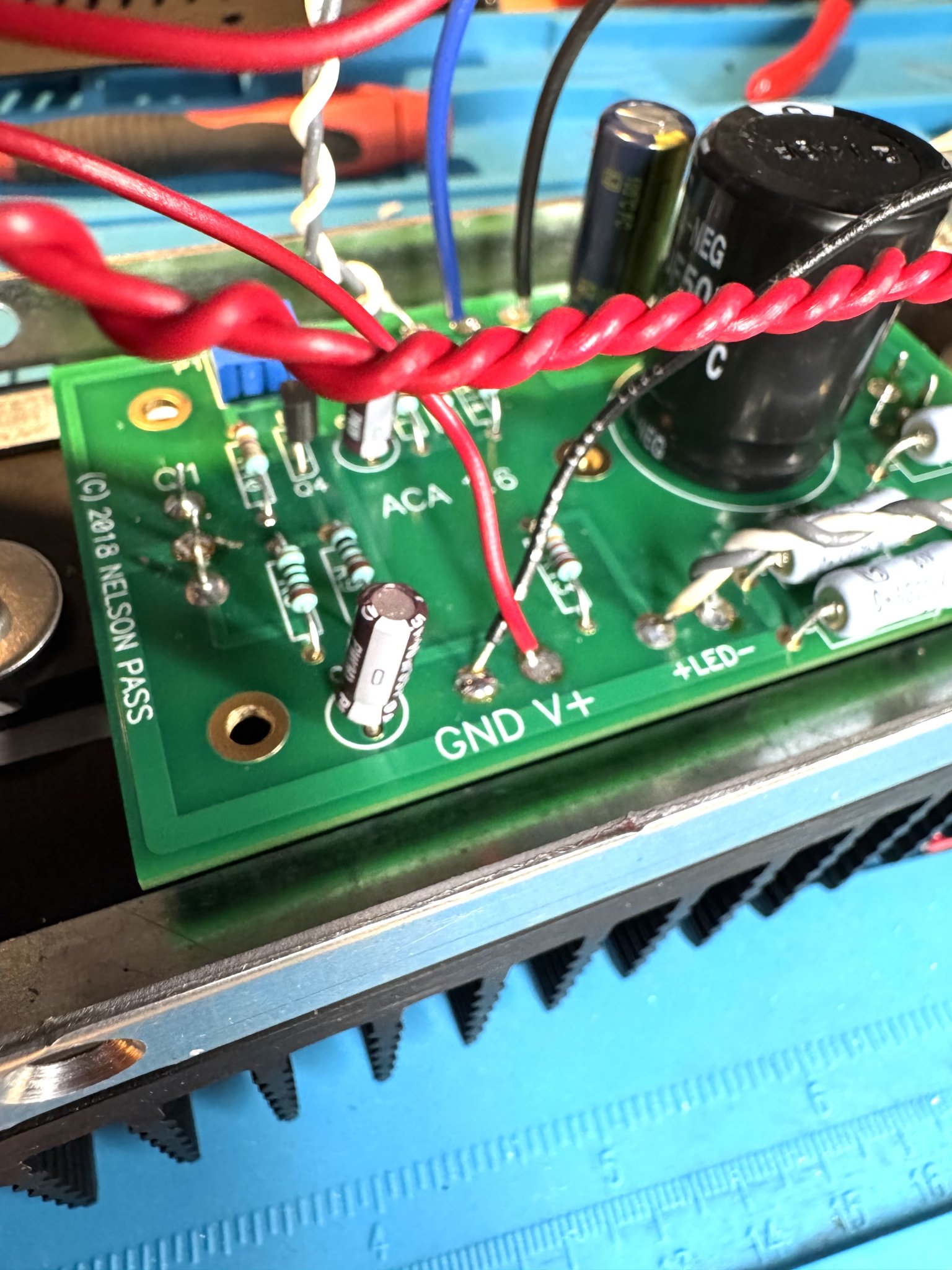

I have attached photos.
Hmmm, now with the board detached I am getting a reading with the bias pot turned up, but it cycles from 10 to 4 with the blinking.

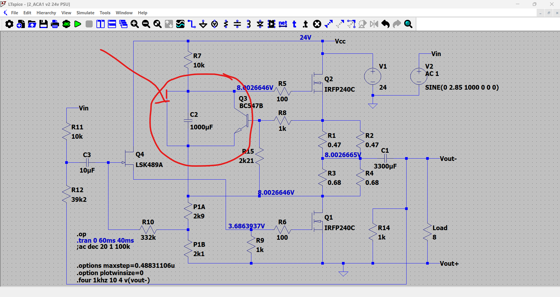

The cycling suggests an overload situation and the SMPS is going into protection mode.
Make sure you haven't mixed up Q3 and Q4.

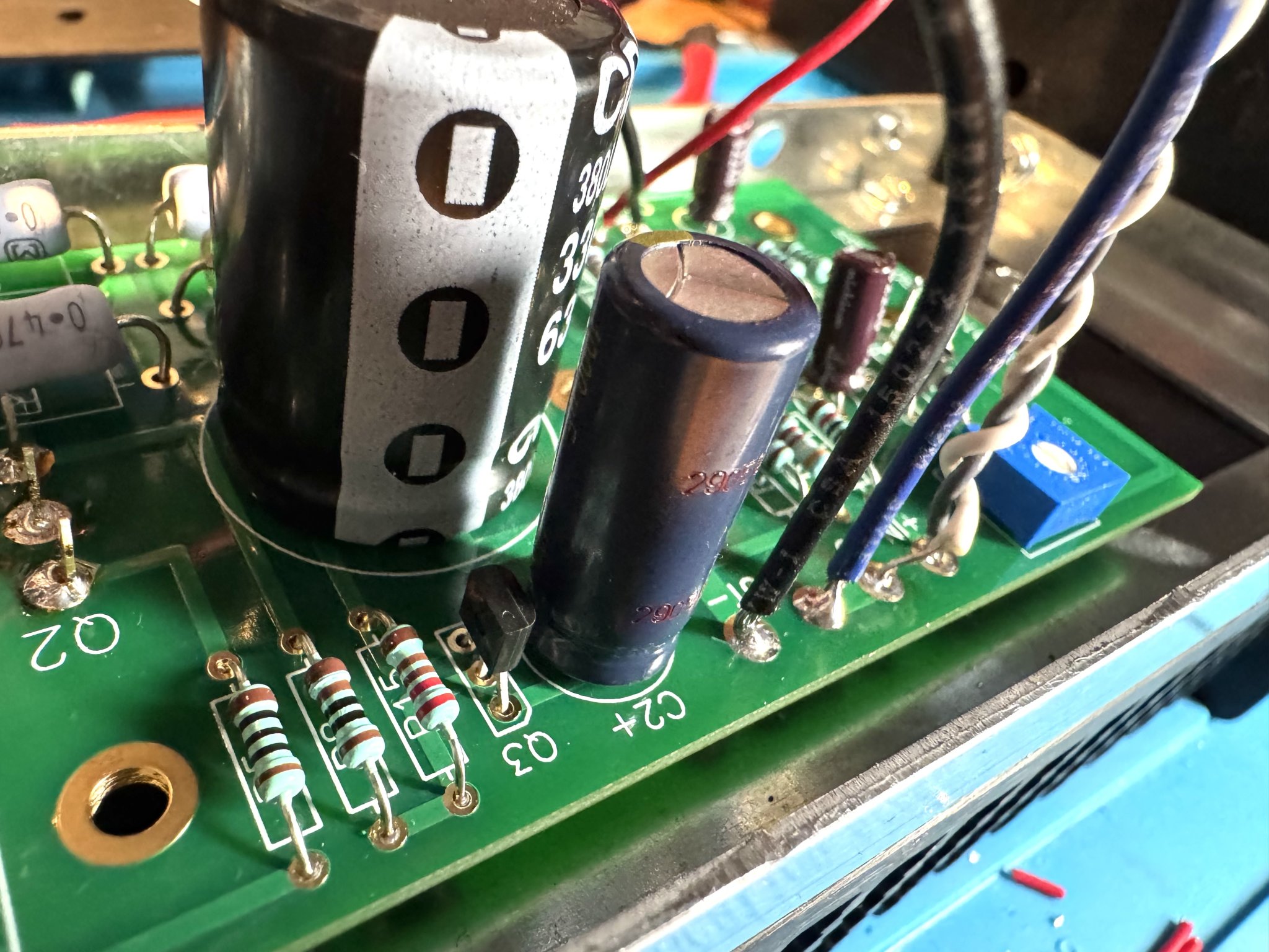

We need to be as minimally invasive as possible when fault finding. Look at Q3. If you short the two outer pins (collector and emitter) does the cycling stop and the full 24 volts come up on the middle leg of Q2?
If the voltage comes up and the cycling stops it suggests a problem around Q3 and the current sensing part of the bias regulator.

Swap the PSU for another one to see if that'll make any difference. There is a chance that your current one might have a problem.

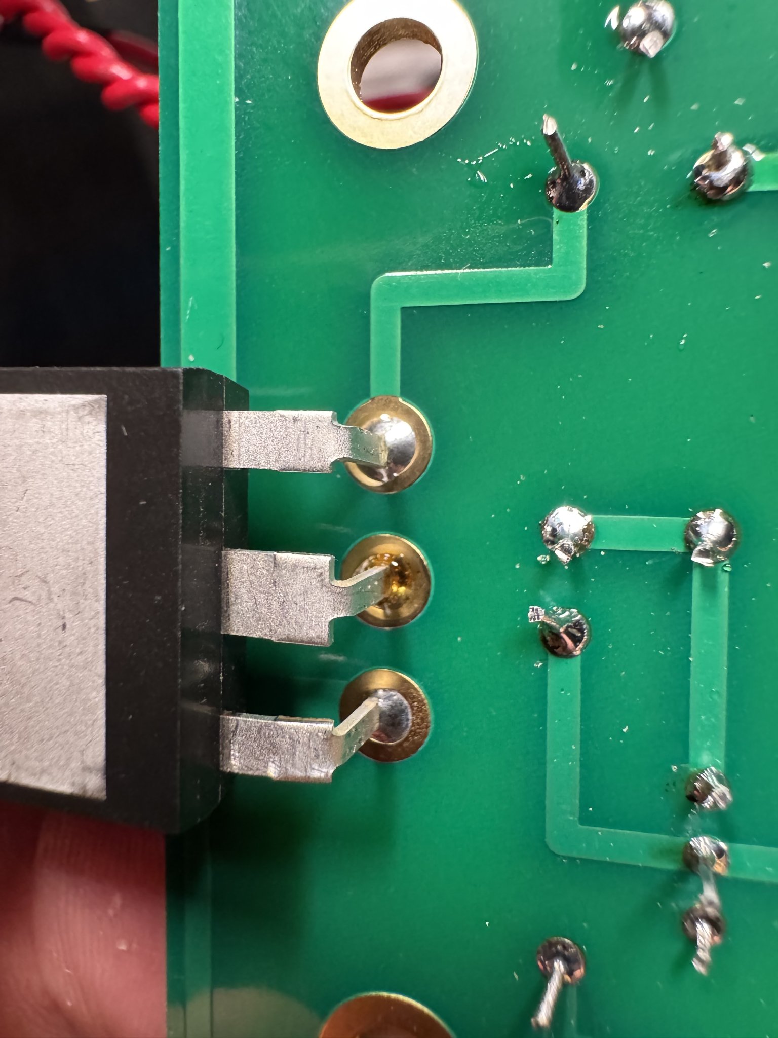

Also look for shorts and reflow most of the solder joints as your soldering looks a bit iffy.
Use 60/40 solder at 300 - 350 C.
Trim the legs of caps and resistors.

Ok. I "shorted" Q3, but that made no difference to the cycling as per the slowly flashing less, nor did it change the readings on any of the middle legs.
Work on one channel at a time. Disconnect the 24 volt supply to the other channel to remove it from the equation. Leave Q3 shorted on the channel you are working on.
Put your meter on DC volts and measure the voltage between these two points (even though the amp is cycling). With Q3 shorted you should not see any significant voltage between these points.
Q3 shorted means this. It forces zero bias current and the amp draws under 0.01 amps. The 24 volt supply should come up to normal.

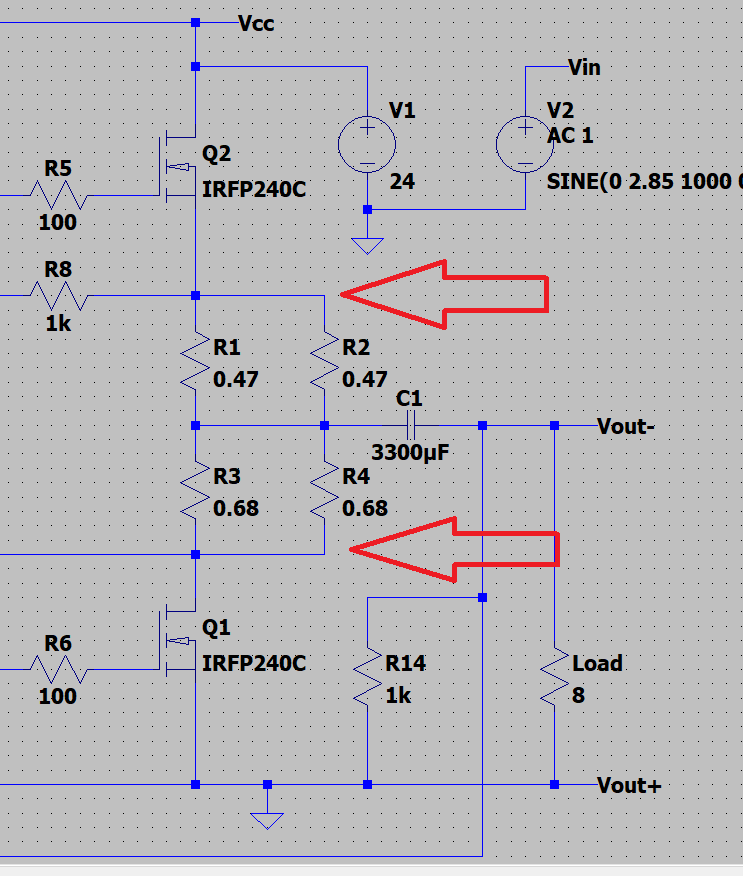

The good channel when operating normally (no blinking of the LED) should see about 0.9 volts between those arrowed points on the earlier image I posted. Can you check that. The supply should also measure 24 volts.
In circuit resistance checks are useful for checking for shorts etc and open circuit low value resistors but beyond that they do not count for much imo because the readings are all inter dependent on interaction with other parts, the polarity of the test probes can play a big part too and also any stray charge (even a few tens of millivolts) can all alter readings.
It has to be voltage checks all the way really (imo) 🙂
When I look at the images I see many bad/cold joints.

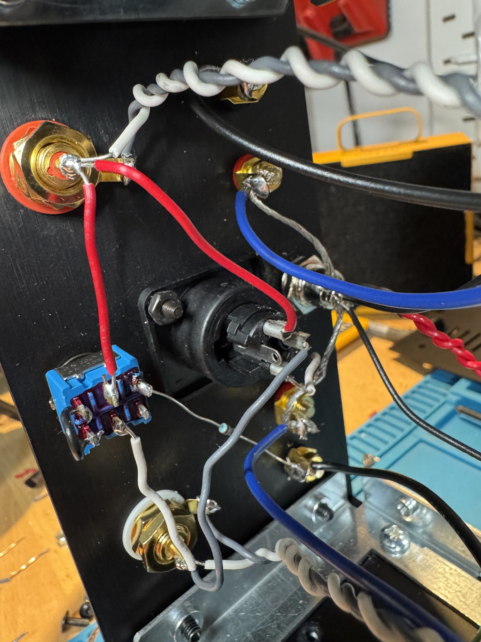

When I look at image below the resistor from the blue switch......one of the legs seems very close to short the output?
It may just be the view-angle........
Edit: It was just the view-angle looking at another of the images........
Meper - I see the resistor, but that is just the angle of the shot.
Sigh, and I thought that I had done a good job of soldering :-(
