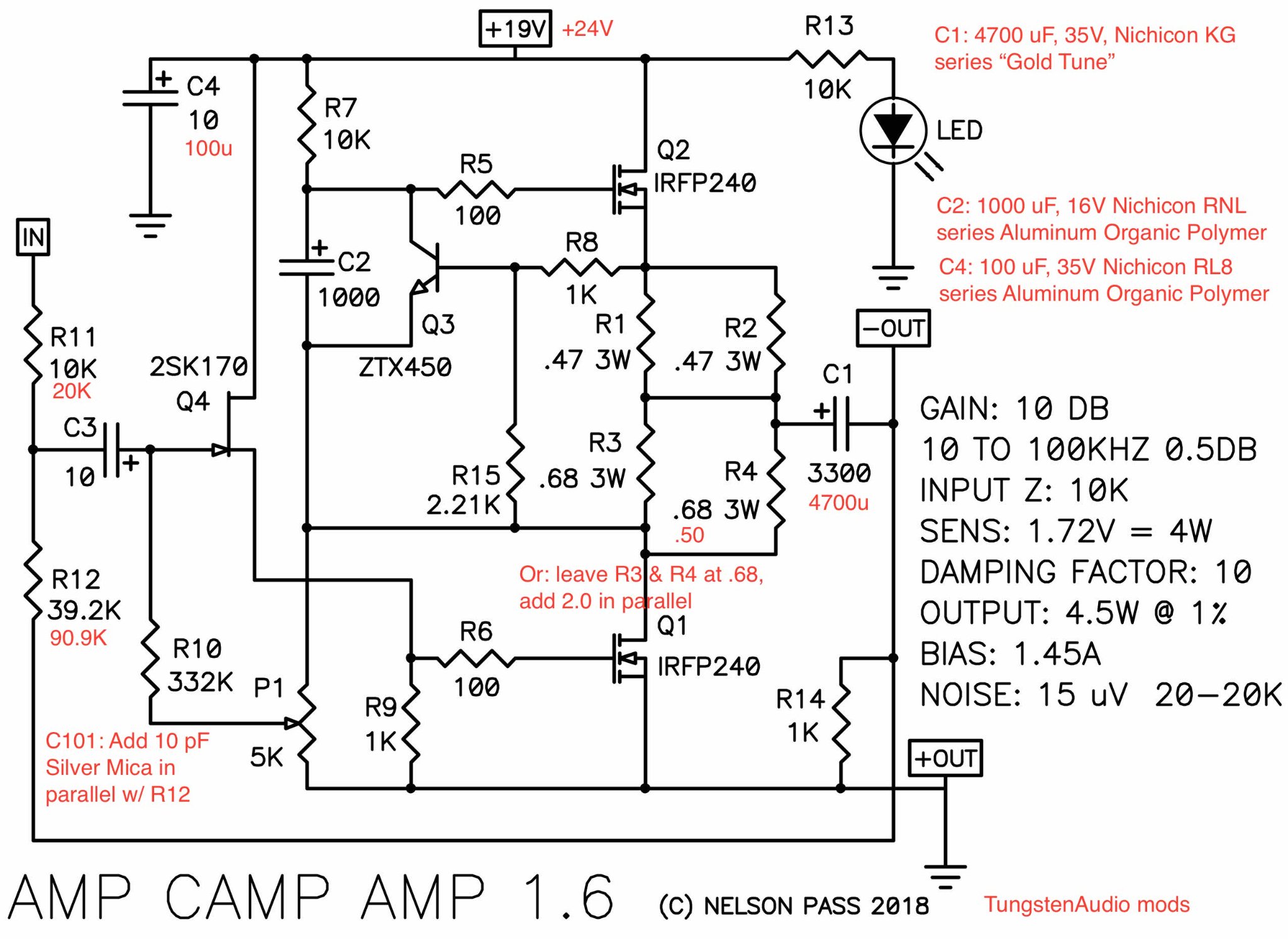

AH, nothing like the good ol' "Fonzi" technique!! And of course, yep.......I think I saw my screw up leading to very small volume, or the kind on gets when you have a point to point wired preamp and can faintly hear the audio bleeding through from another input, etc....but maybe a bit more than that, it's just the best way to describe it. ANyway, yep....it was definitely a resistor issue. Or more precisely an Eric issue of reversing the the resistors R11 and R12.....which blows, since it means I gotta switch the paralleled pF cap from one to the other as well. I forget which picture, but I was using a picture of someone elses build when adding those 2......anyway, I hope that's it.......found it pretty quick due to the member who ordered the 90.9 sans the K, resistor a few pages back, as I was ruling out that same mistake, or me maybe receiving the wrong resistor and not checking it closely enough. And while looking at the board, I was obviously trying to figure out how my feedback resistor could be located in that position etc......and obviously it's because it's not supposed to be in that spot on the pcb.

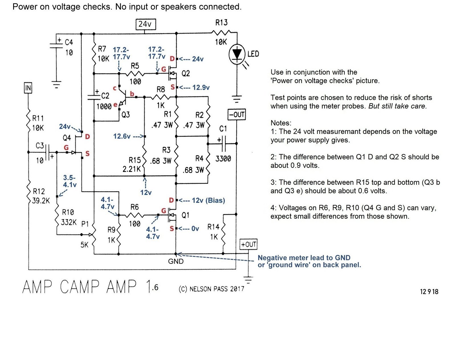

I have completed my ACA v.1.8 build and Channel B sounds wonderful...Channel A, however, has nothing playing.
Before I post a bunch of photos or go too far into metering, I thought I would ask if there are simple places to start?
Both leds light, but the Q1 pin reads 0 on Board A and 10.1 on Board B when I read to bias.
Any places to start will help. If I need to meter each spot, do I need to remove the board from the heatsink or can I read from above?

On Channel A, check for a short between the middle leg (the Drain) and ground. This could be the part itself is shorted, or it could be a short from the Drain to the Heat Sink. Remove the screw and lift the part away from the Heat Sink to check.
If there were a short on Q1 then Q2 would be running very hot although the bias current would still remain correct.
A fault like this could be many things (but ultimately it will be something simple 🙂).
Measure and record the DC voltage on all four transistors, note them down clearly and post the results. Its a couple of minutes of a job to do that.
