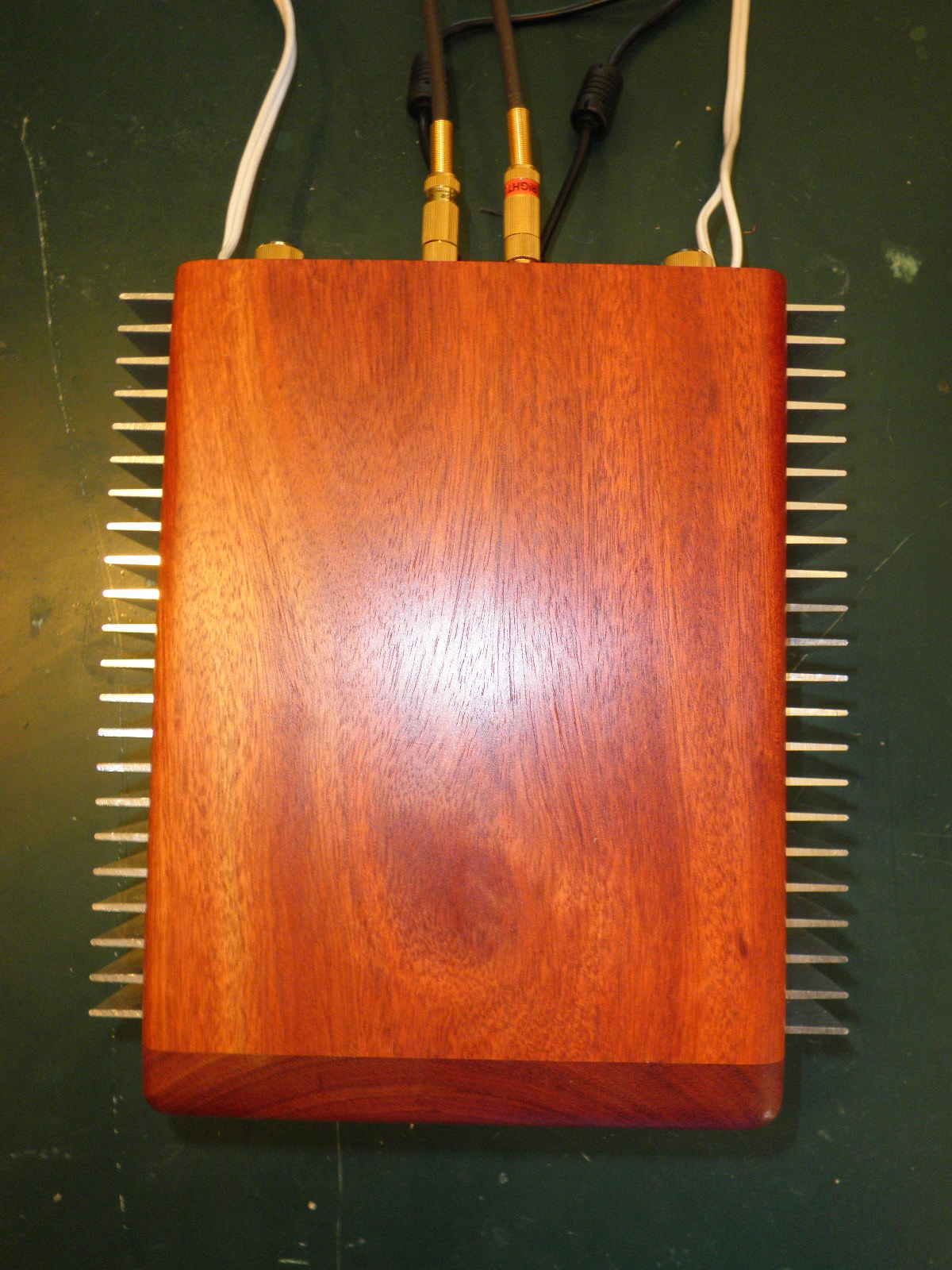

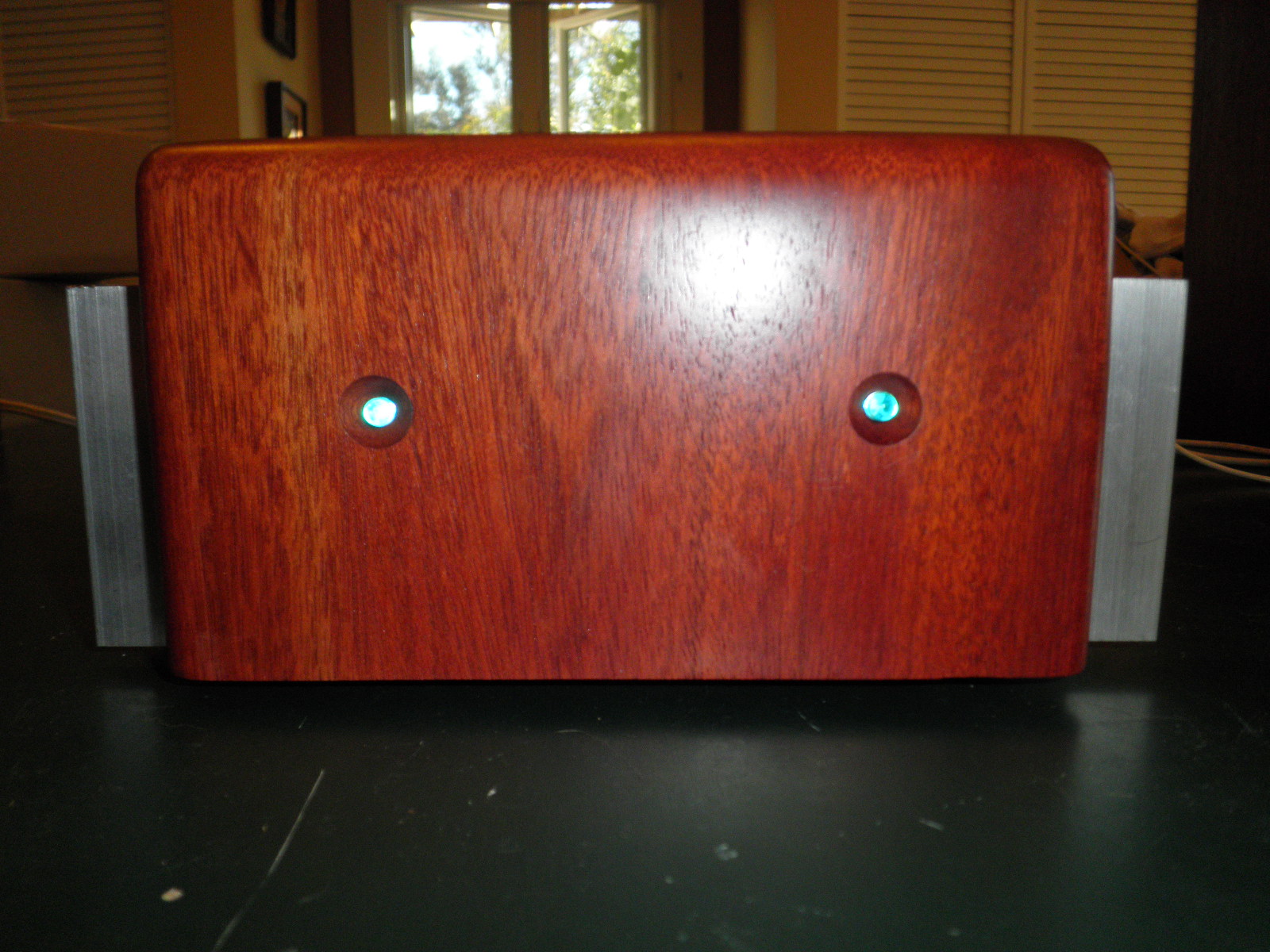

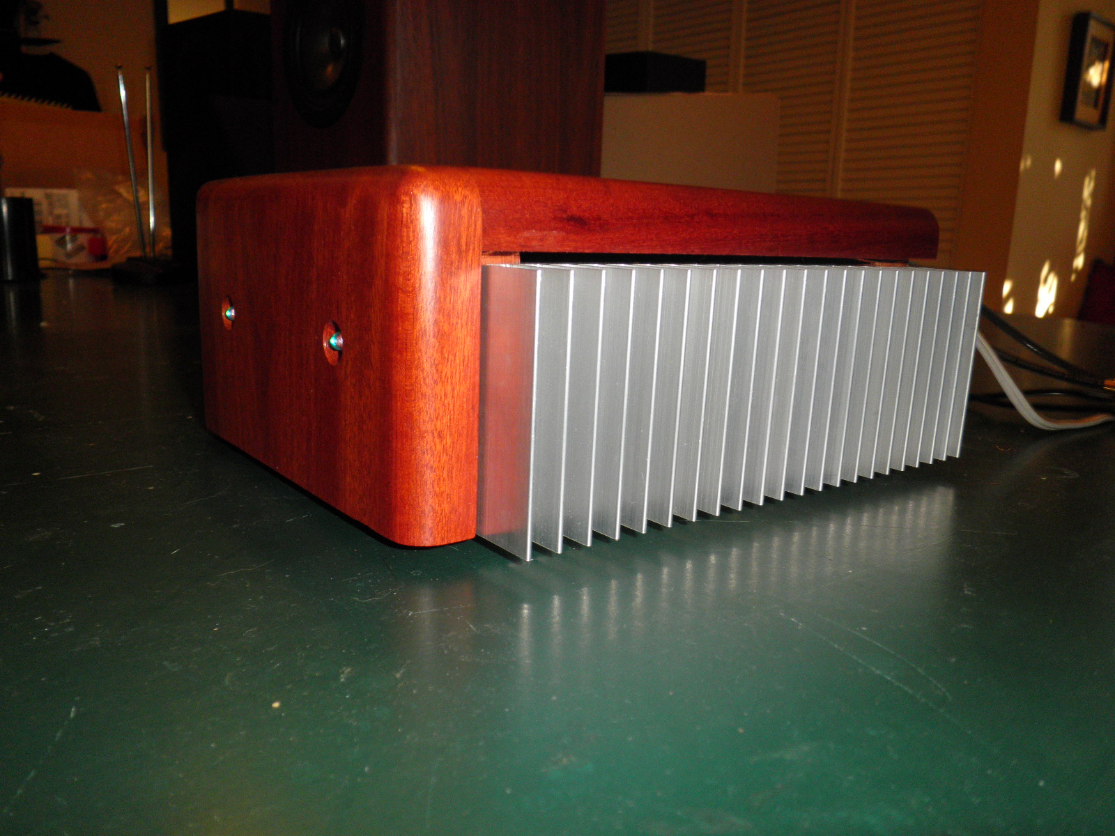

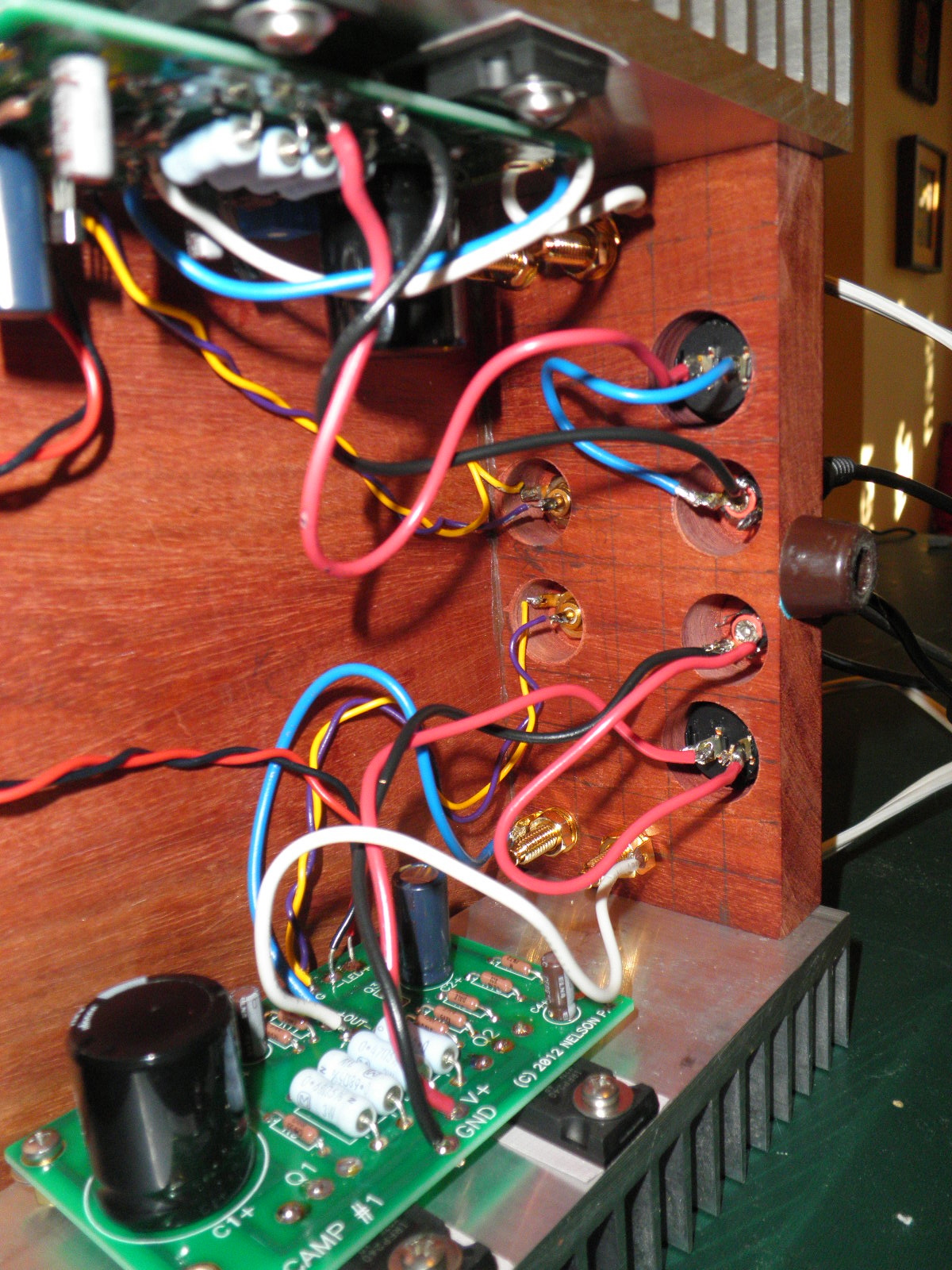

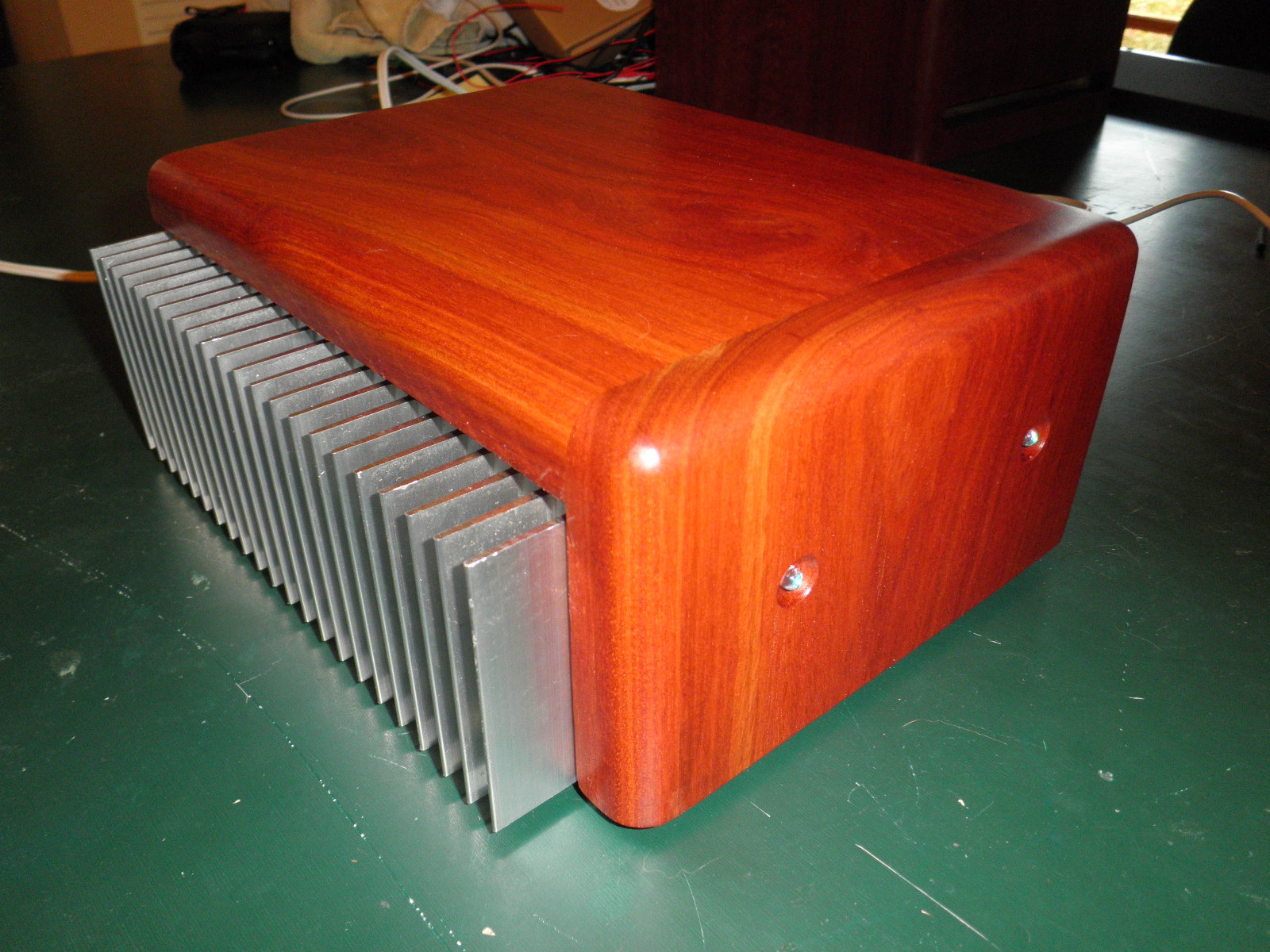

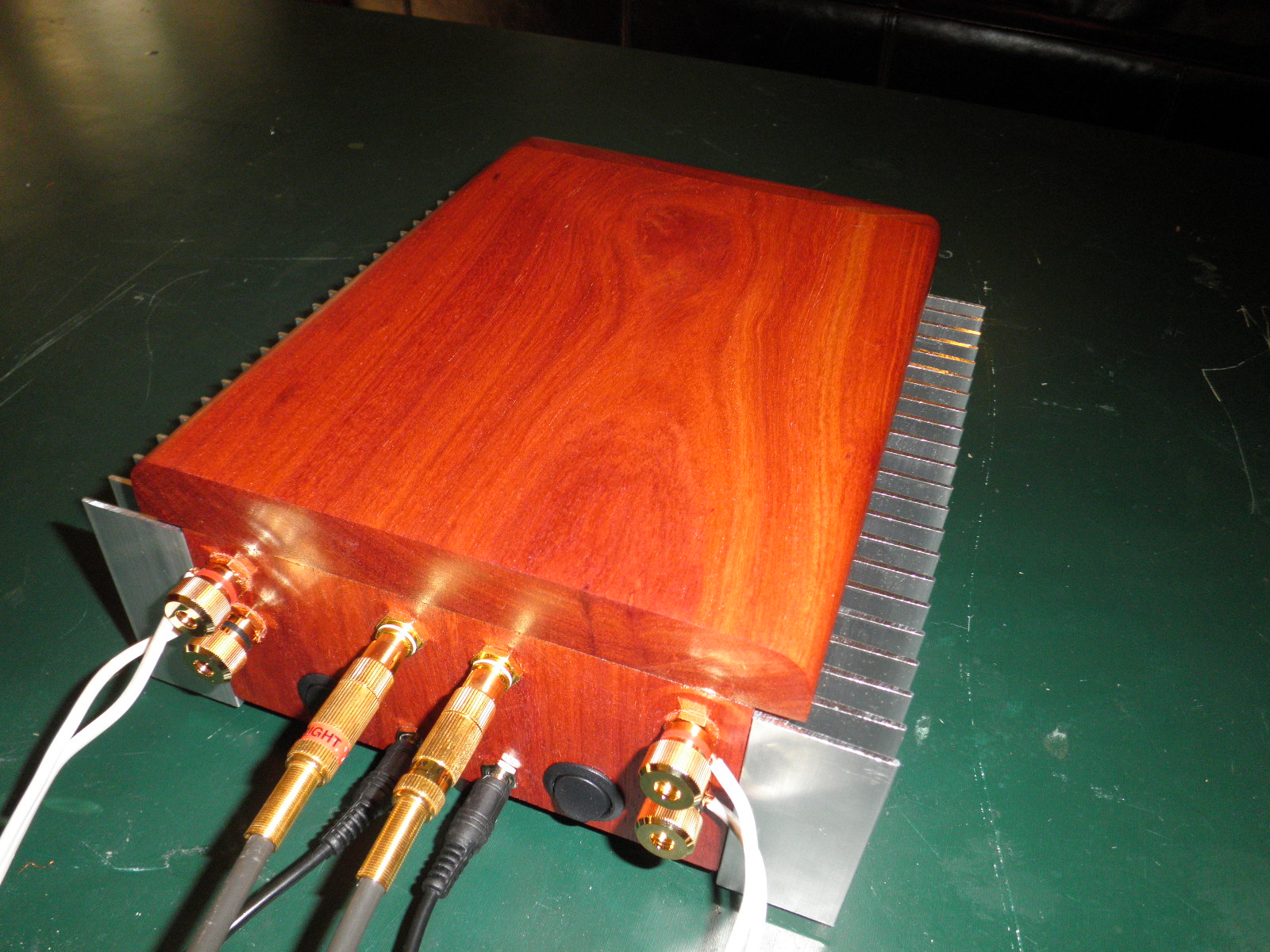

ACA conjoined monoblocks
...finally finished the ACA chassis: solid bloodwood plank with aqua LEDs. I'd listened to the amp quite a bit before installing it in the chassis and really like it....about a 1/8" gap between the heatsinks and the top. Thanks to diyaudio store for the kit and all here for your previous posts which gave me many ideas for the amps's body...
