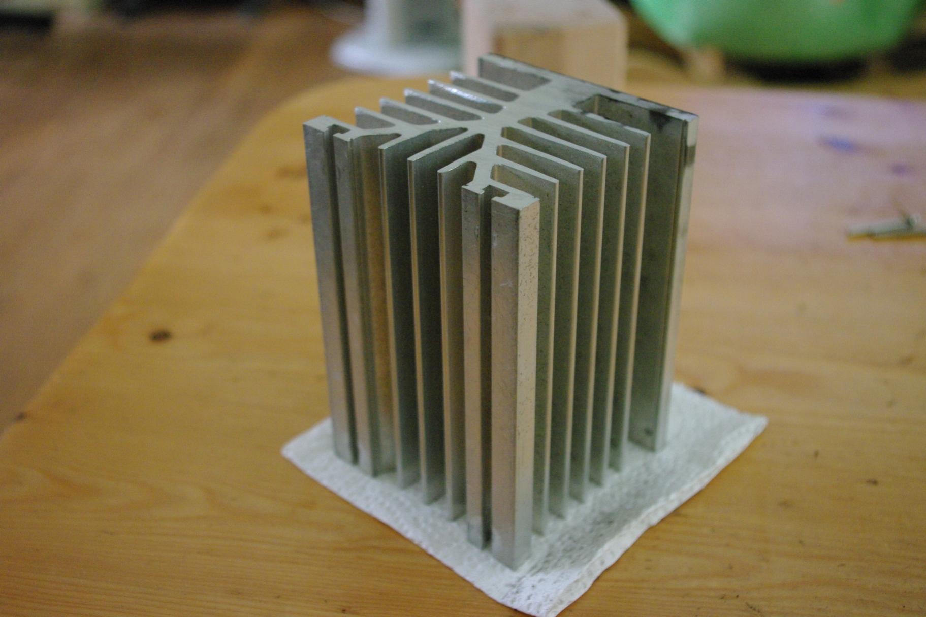

I would think that sink is perfect for one channel. My guess is that it might run a bit cool.
thanks Eric.
maybe you are right and it will run a bit cold, would be my second class a that does not get hot. although, this is not going to be mine, my son is going to build it,...... with my help.
My guess is that it will run hot with the 20 Watts dissipation.....
and how do i get it 20 watts?
i know next to nothing about electronics, i just love to try new stuff.

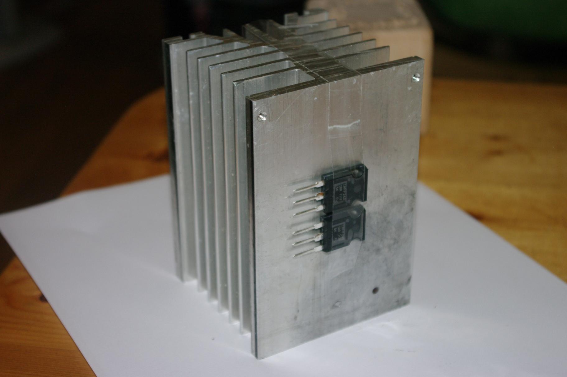

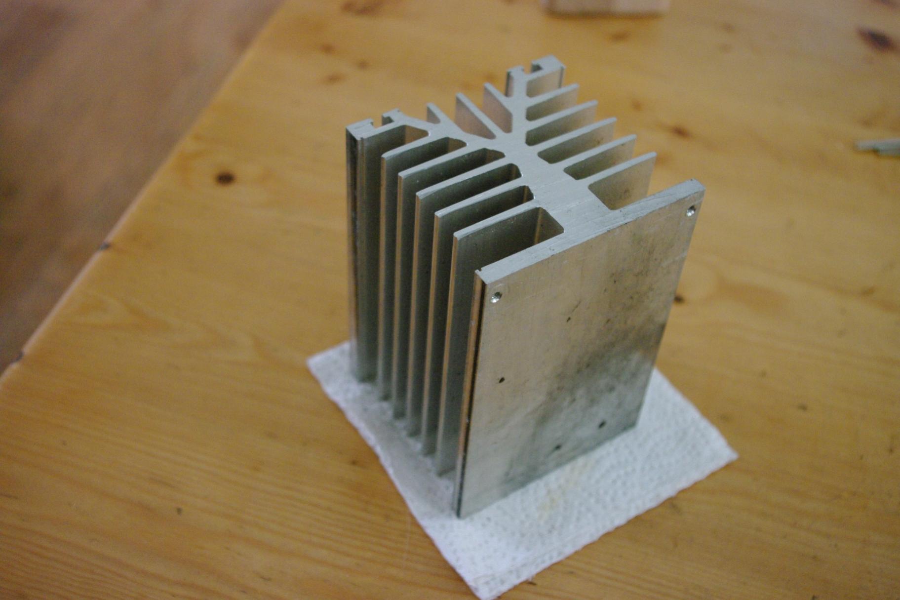

would this heatsink be enough for one channel?
size is 12 X 8 X 8 CM backplate is 7 or 8 MM
I think you will be fine. Mount the transistors close to that big meaty part that runs up the center and near the bottom. If you can arrange things to let air enter the bottom, that would be a big plus.
i have some 6MM copper plating left over, maybe that would help distribute the heat?
my plan was to put the transistors near the center in height one above the other leads to the side instead of down.

Exactly! Sink the transistor mounting screws directly into that thick vertical vein. No need for the copper.

Yup, that's what I meant! It might make things easier to just mount the transistors with a bit of space between them so the PCB sits right on top of them - this way you won't need extra wiring...
Given the thickness of that sink, you won't have any problems with heat spreading. If you can raise that sink up off of the table with your final implementation to allow some airflow through those fins as has already been suggested, it will work much better.
build in to the design i have in mind the heatsink will have about 2cm clearence from the underside. on the upperside there will be wiremesh. my son will not be using PCB but point to point. this is going to be his first amp. although he did solder a portion of the work on my aleph 5 mono's two weeks ago.
