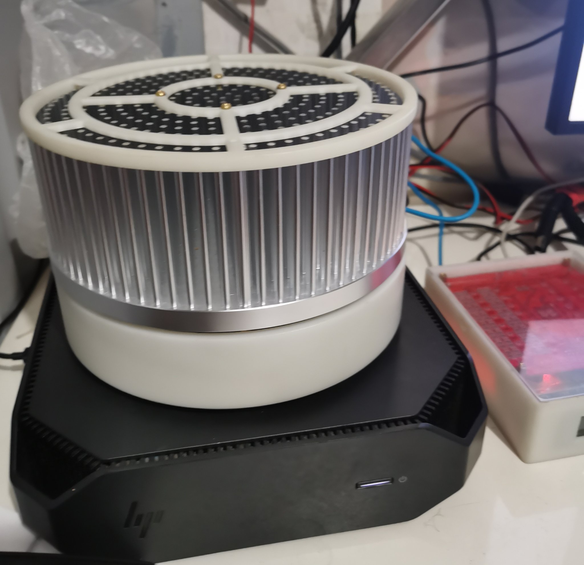

Looking good! Did you design your own PCBs? I'd also be interested to see where the connections are made.my ACA(英语:myACA)
What are the white parts made of? Some type of plastic?
just by 10-20 pcs of 1% and measure with LCR-meter the exact values - bingoMaybe not necessary to match anything in the ACA but I had my resistors matched to .01% just because it gives me the warm fuzzies. Or is it leftover milspec OCD?
