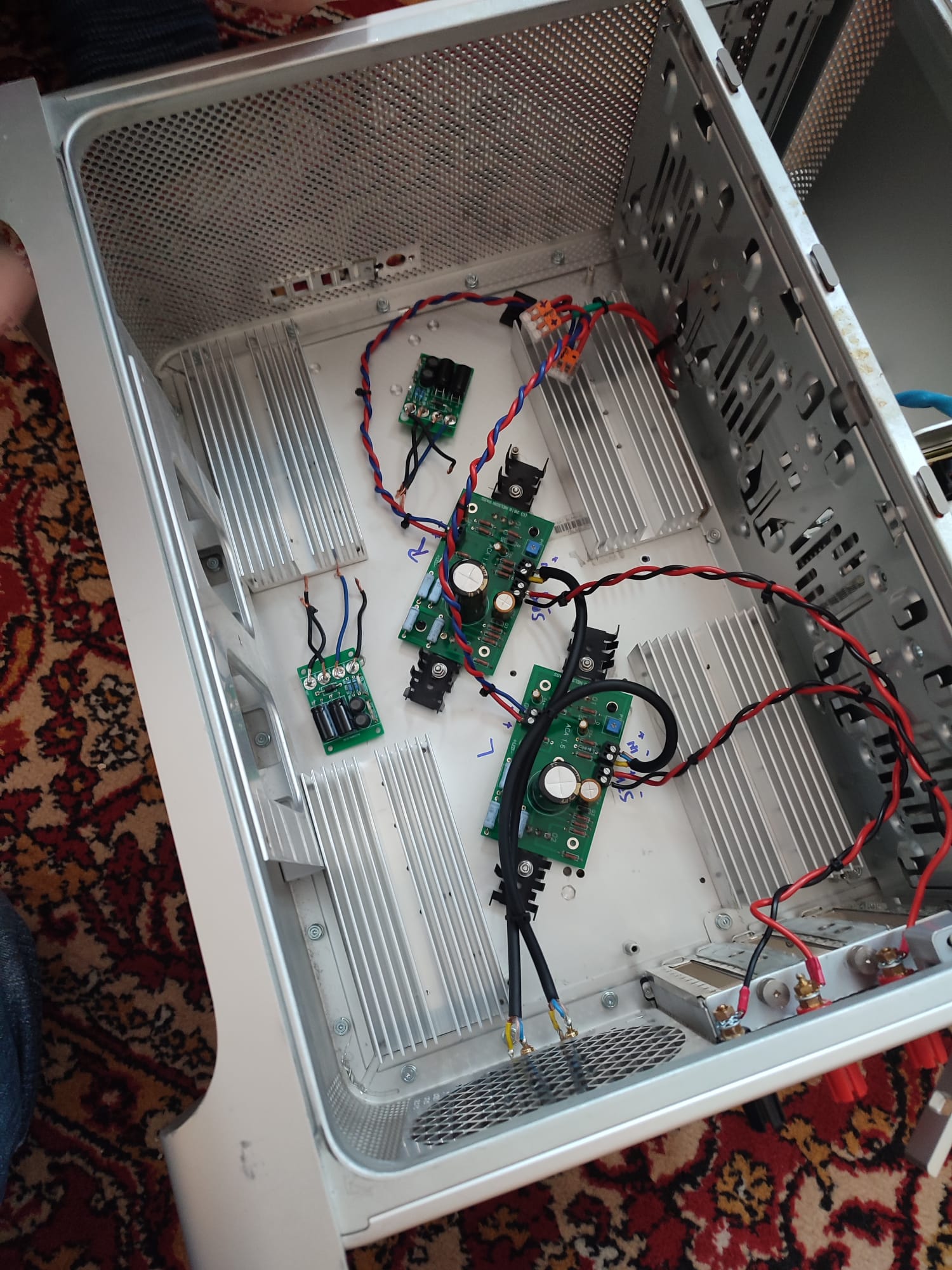

i did a LPS for my friend. now i did another update - i need 2 Volts more for power and want to try the LT4320 active rectifier.
the cost are about 20Euro and i got 2,2 Volts more with a bias of both channel about 4A i got 23,7Volts--Yes... that is fine.
we compared the sound with the SMPS LRS150-24V with 2xPOZ89 Filter and the winner as the LPS. the dynamic is increased and the "class A" sound is much better then the actual SMPS. now we get less "fog" = darker.
LT4320 is done without snubber at the sec. winding because i haven´t done quasimodo.
next step will be an update of the Apple G3 for compare.
apple G3
have fun

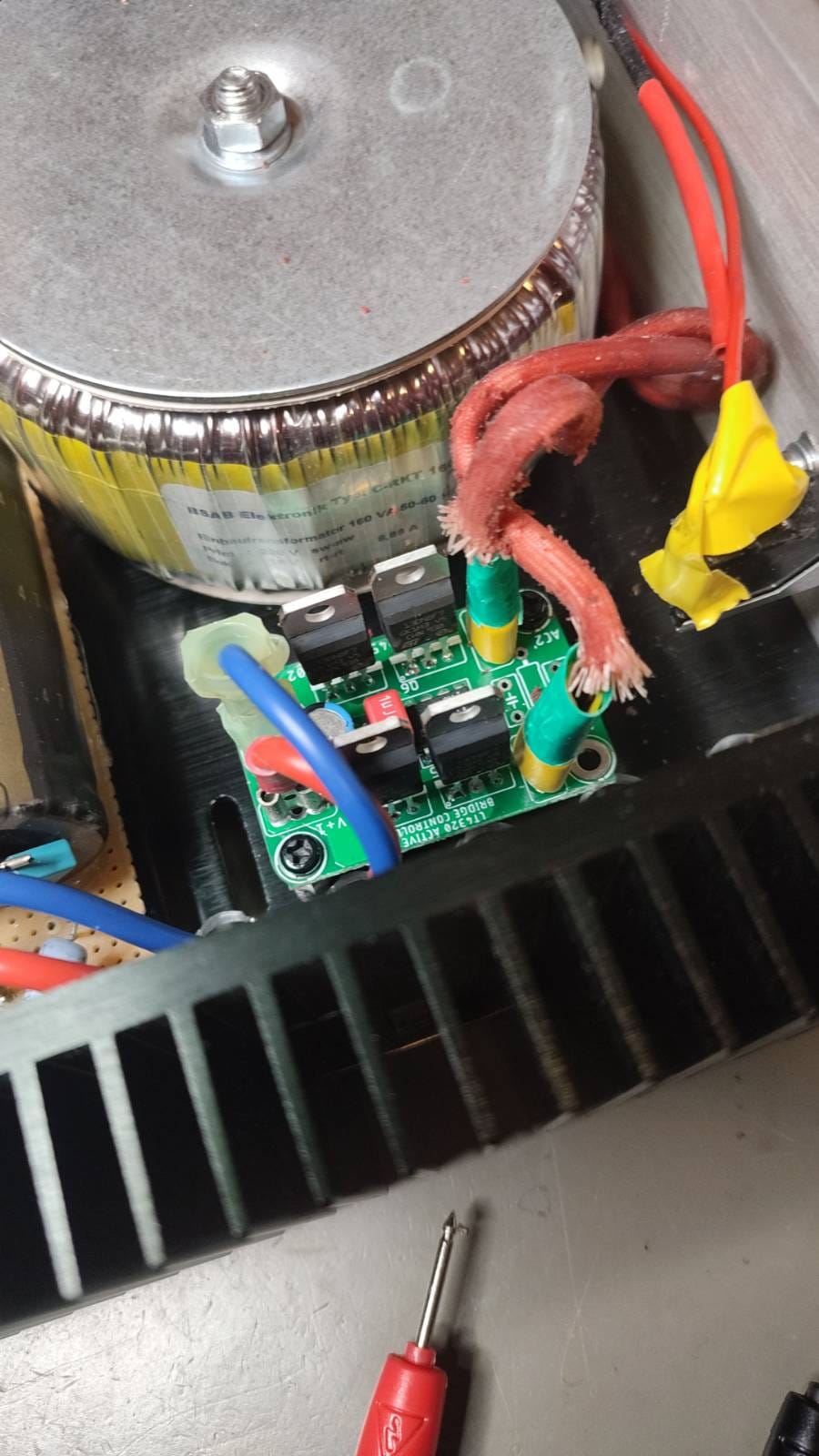

I finally retired and had time to assemble to ACA kit I bought in 2018. It worked beautifully the first couple of times I used it, but now when I turn in on there a a soft thumb coming out of both speakers every second or so. I purchased a different power supply from a recommendation in the forum (which I now can't find) but it made no difference. The fact is work correctly the first couple of times before this started has me stumped. Any ideas?
First step, see if the 24 volts supply is present and steady at the PCB itself. Measure across the points the supply connects to the board.

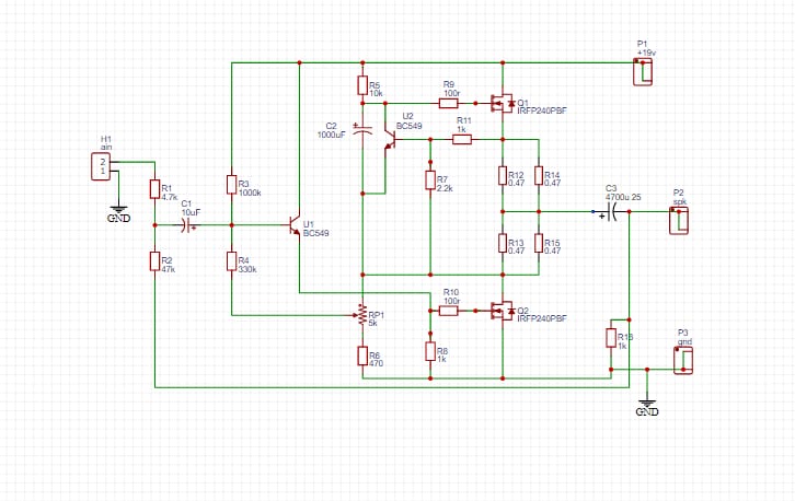

Why do you need R3? which looks as though it will introduce noise from the 24V rail direct to the input. Dropping R4 a little would allow more base current to cater for 'average' gain small signal NPN's.
You can also add a bjt output stage... but then its not an ACA in the true sense of the word 🙂
Do you mean that you can simply replace k170 with bc5xx? I doubt it. 1M resistor is necessary in this circuit. I also tell you that you will not notice a difference between mosfet and bjt in the output stage either.
K170 is difficult to find original and is very expensive. I just don't want to spend the money on a K170 when I have miles from BC5xx. and I don't think that if we do a blind test you will feel the difference between k170 and bc5xx. This weekend I'm going to build it.
Why? What does it do.
Here is a standard ACA with a high gain small signal transistor at the input. Try it with what you have. A 2N3819 JFET also seems to work well.

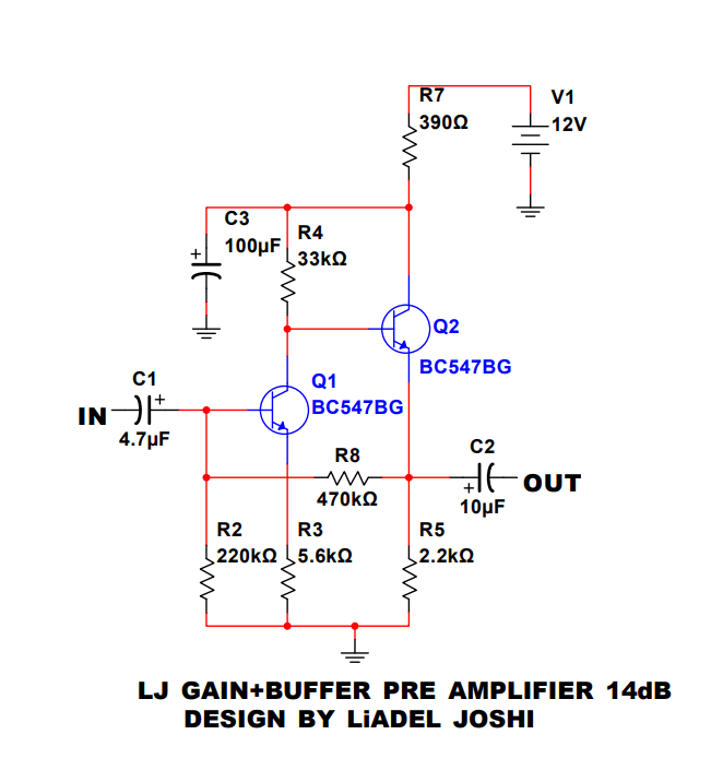

There were some discussions about ACA in one of our local audio groups. I wanted to build this but 2SK170 and ZTX450 were unavailable in my place ( almost unobtainable except for importing which incurred a huge cost). So I requested a friend Mr. Joshi Liadel to make some alterations to use locally available components like BC series transistors. And this is the schematic of mods made by him.Hello partners. What do you think of this configuration?
I tried this but the gain was less so used a simple gain circuit and it sounded very good. Not sure how dose it compares to the original with jfet input stage, It may sound entirely different, I will attach a pdf of the layout I used for this so someone can try and compare it.
Mr Joshi is not a member of this forum he can be contacted through Facebook for any clarification

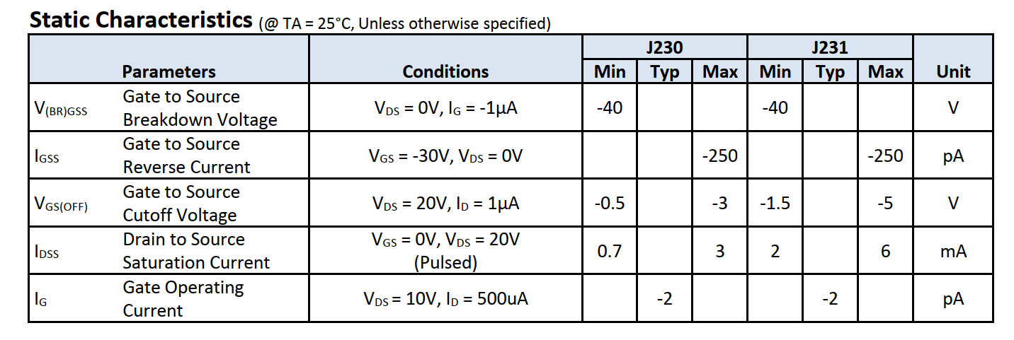

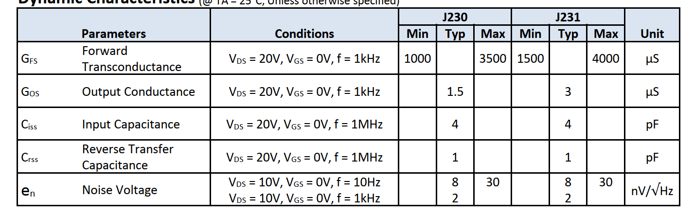

Well, maybe. What can you tell me about the J231?
Idss? Yfs? How does it compare in basic parameters to the J113?
I didn't have time to finish the ACA this weekend. In fact, I have a stereo ACA already working with original 2sk170s that a guy gave me, but I want to test this other ACA that I'm going to build with several type of transistors for Q4. I don't remember the basic parameters exactly, but I used two J231 to replace a 2sk109 in an amplifier and it worked perfectly. I know that the 2sk109 contains well-matched 2x2sk170s. In theory it should work. Okay. I'm going to check that's all I have here. bjt, j231, bf245, bf256, k117, k30, k246 and the k170 from aliexpress which are more than likely fake. Gentlemens, thank you for everything and I will keep you informed. Strength and health!
