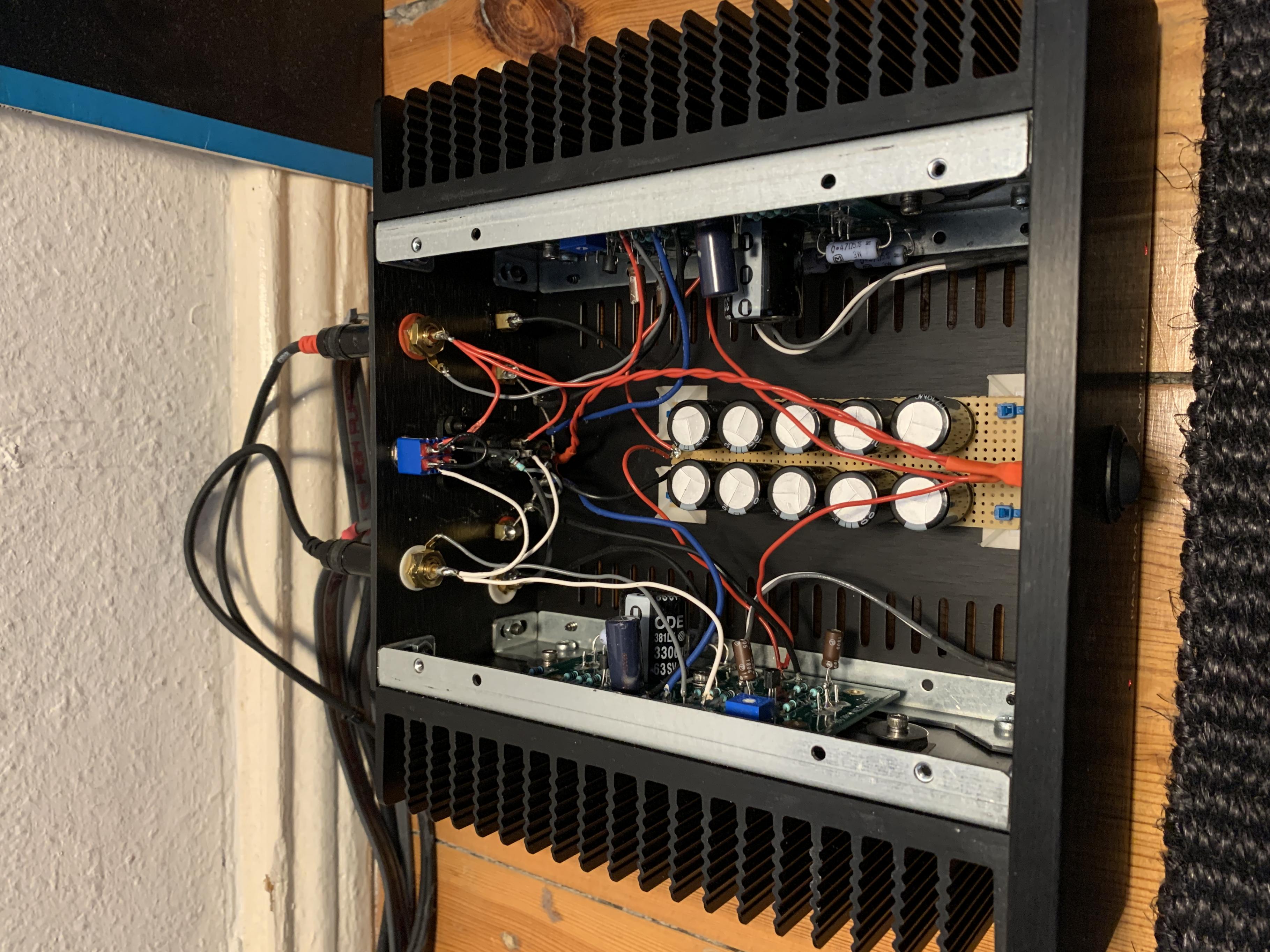

yep...thats correct, my ACA is a medium size housing and with 24V and 1,56A bias its working on its limit:
Douk Audio DIY Aluminum Enclosure DAC Case Cabinet Amplifier Chassis New (W211*H90*D257mm)|amplifier chassis|dac caseaudio diy - AliExpressDouk Audio DIY Aluminum Enclosure DAC Case Cabinet Amplifier Chassis New (W211*H90*D257mm)
