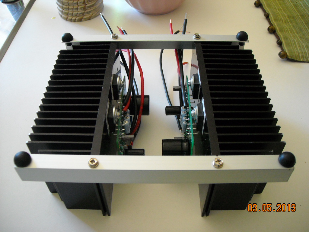

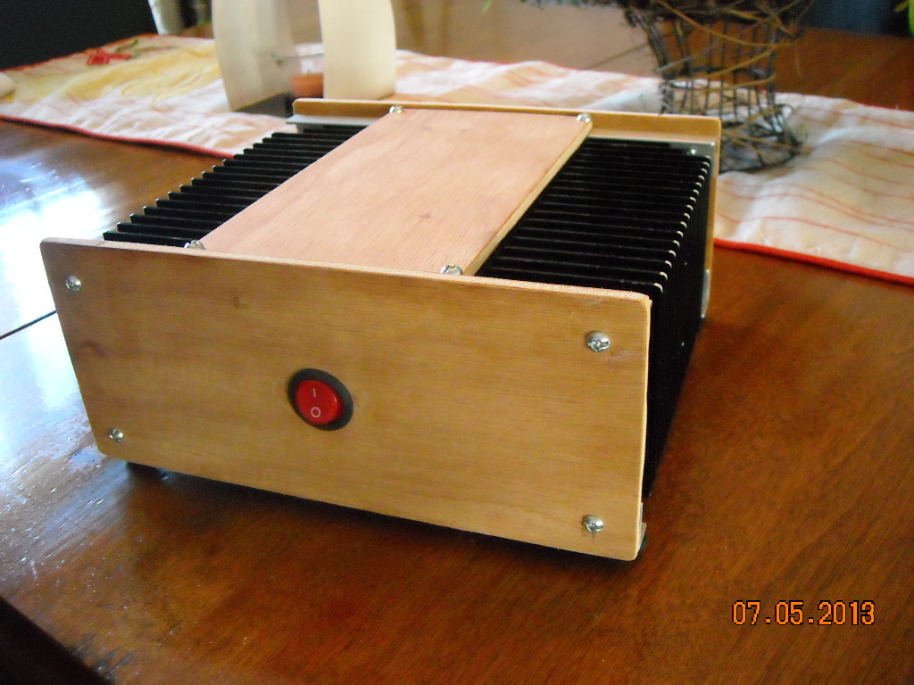

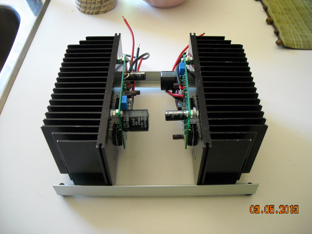

Hi Eric,
Very nice amp, I'm sure you guys had a great time building it.
I have also just finished building one, it's a sweet sounding amp, very musical. This was the first time my son was using some power tool like the drill and he also cut some metal. Very nice bonding moments. I have attached some picture showing how easy it is to built this amp.
p.s. I will most probably change the silver screws for black ones.
Rgds,
Eric
Rgds,
Eric

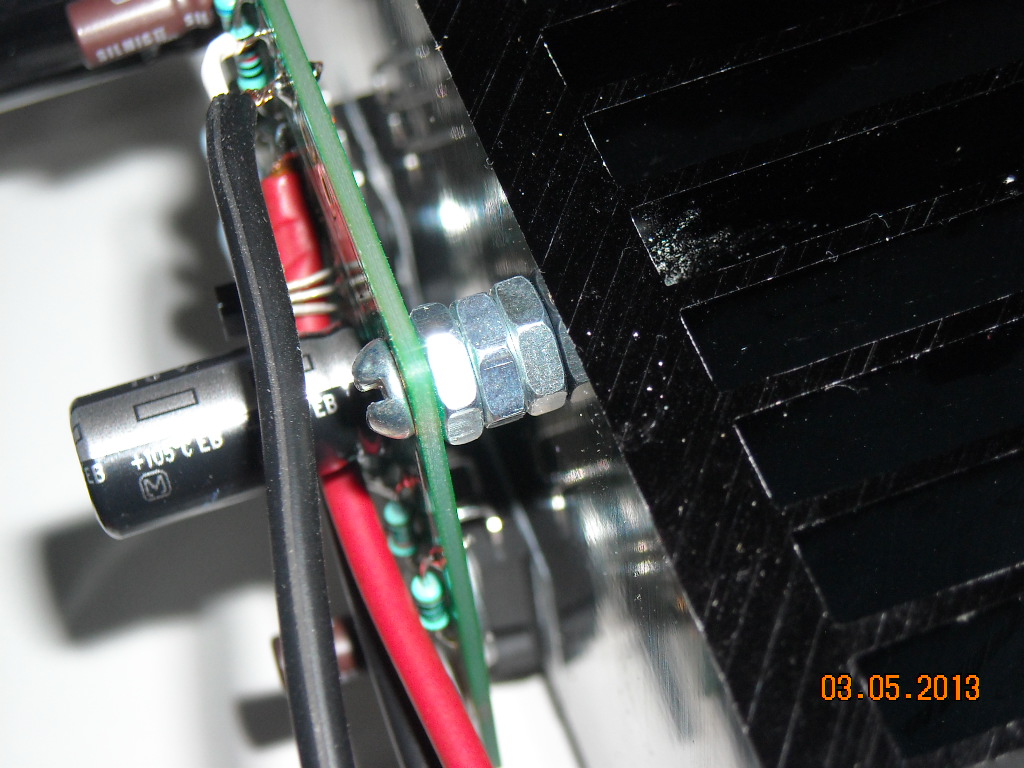

Mario: I look forward to seeing the blood wood chassis! I am planning another project with a DCB1 and an F4 and thinking of a matched wooden chassis set, so I'm scouting woods and chassis styles.
Eric: what a nice looking amp and a great time with your son - it must have been fun working with power tools together! I really like your implementation of the feet for the chassis. I see you used the very same high tech pcb mounting method that I did ;-) This is really an ideal first project given the small scale of the work and relative simplicity of the build. I'm thinking of picking up a few more boards to have on hand for projects for those that appreciate audio.
